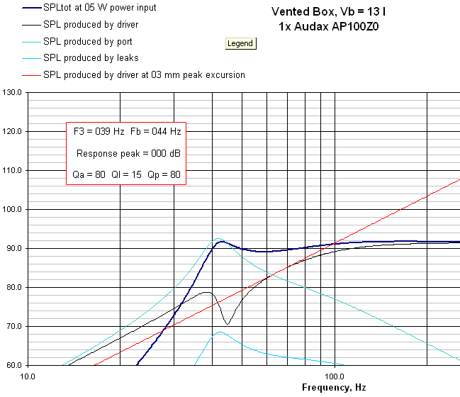

Using the 30 hour run-in T/S parameters, I have done a quick ported enclosure model and found this quite amusing...

Are you putting the AP100Z0's in a sealed or ported enclosure? I think ported is the way to go, but thats just my opinion.
As a side note, has anyone tried, or thought of trying these in a dipole?
Tried them in a dipole?! thats what i am doing now! sounds great!
Other then that yes ported sealed whatever it doesnt really make all that much difference to the impedance where the xover to the tweeter is concerned. So my sealed box xover will be fine for a ported box aslong as the width of the front panel are roughly the same.
I agree that ported is the way to go, but I dont want a cabinet thats floorstanding and two of these will not work in a small ported standmount.

I’m going to make two ~27cm cubes, which gives me ~12L which is perfect for tuning to 45Hz.
