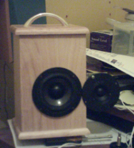

Ok I've found some wooden biscuit boxes in Poundstretcher for £5 a piece. Internal volume 3.5 ~ 3.7 litres. Cheap and cheerful! I've cut in a 90mm hole for the driver and bingo. I've got to say they don't sound bad (esp for price!).

stee-b said:Ok I've found some wooden biscuit boxes in Poundstretcher for £5 a piece. Internal volume 3.5 ~ 3.7 litres. Cheap and cheerful! I've cut in a 90mm hole for the driver and bingo. I've got to say they don't sound bad (esp for price!).

deffo need a tweeter though
Certainly do need a tweeter, and I happen to have a couple of vifa D20td-05 's. Went to maplins to get a few caps to play with and told they'd all have to be ordered😡 so no tweeter play just yet.

Right I've managed to find some caps and a lpad so installed the tweeter ~7kHz first order. I've allowed the audax to roll off naturally. Really are motoring along now, and look to be excellent bang per buck (££). All temporary fixed at the moment, but there seems to be a lot of promise with the current set up.
