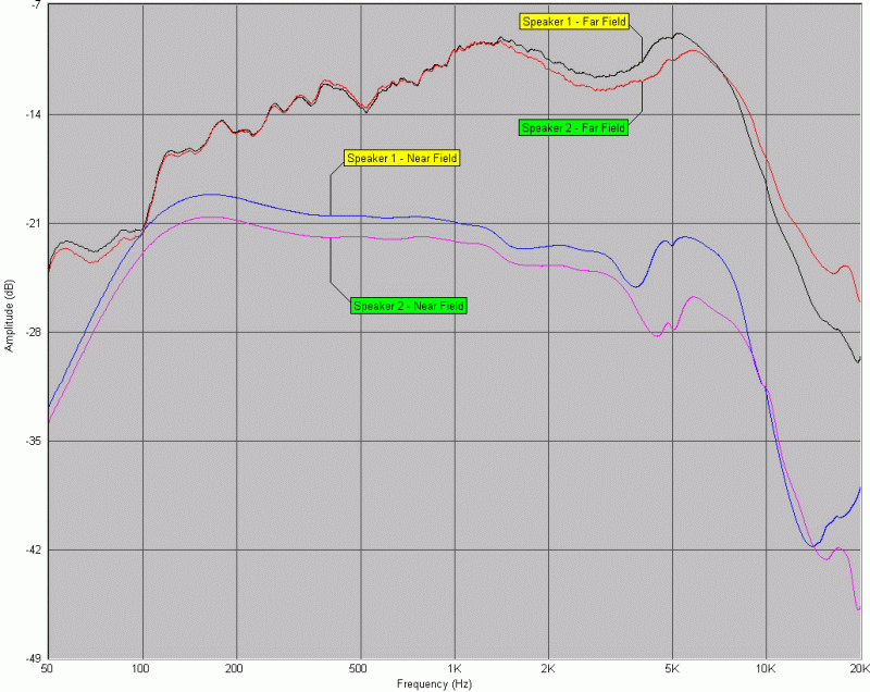

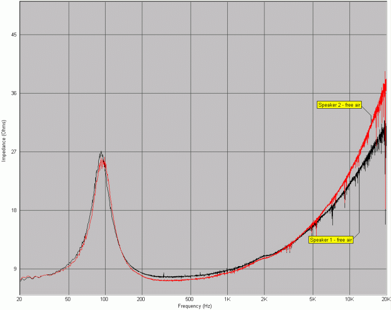

As a service to all the Maplin bargain hunters, and because I'm so great, I thought I'd post some measurements of my AP100Z0s.
First up is the T/S parameters measured using Speaker Workshop and the added mass method. These calculations are assuming a DC resistance of 5.7R, SD estimated to be 47cm^2 and the added mass was 11g (two 20p coins @ 5g each and 1g for Blu-Tak).
Speaker 1:
Fs = 92.6Hz
Vas = 1.78 litres
Qts = 0.57
Qes = 0.74
Qms = 2.58
Speaker 2:
Fs = 94.9Hz
Vas = 1.78 litres
Qts = 0.61
Qes = 0.78
Qms = 2.72
Something worth noting is that these are the exact same drivers that I measured 18 months ago and reported in this thread:
http://www.diyaudio.com/forums/showthread.php?threadid=9993
Something has clearly changed! The units are now fully run-in, but Fs is supposed to drop not increase. One possible explanation is that I could have used different power level for the two tests. To be honest, I'm not sure I'd trust any of these results...
Next up is free air impedance (unsmoothed) which shows Fs in the mid-90Hz reange. This is quite different from Pinkmouse's experience although very similar to Vikash:
And finally the 1/3 octave smoothed frequency response measured in 3.5 litres sealed (a pic of the test box is on page two of this thread). The peaks around 5KHz proves Pinkmouse's memory isn't totally shot.
The difference in amplitude between the nearfield results could be due to not having the mic the exact same distance from the dust cap.
I hope this helps some of you.

Glad to hear it! 😀 The difference in Fs still seems very strange though...daatkins said:The peaks around 5KHz proves Pinkmouse's memory isn't totally shot.

Why do the Audax response graph only go up to 10/15k? They are specified to 20/30k so why dont the graphs show the response to these frequencies?
