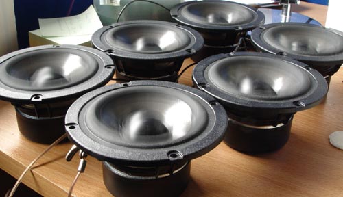

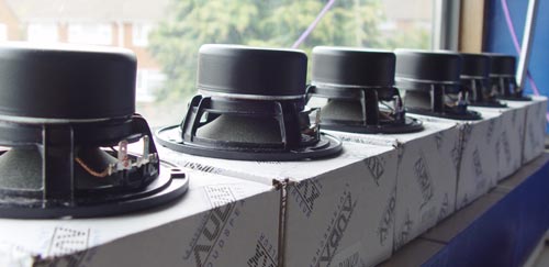

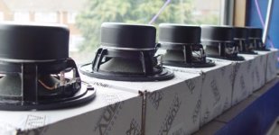

Well I've now done 50 hours break-in for all drivers, and they still need more. The second batch were run-in at mechanical excursion (or what I thought to be) and the first batch was run-in at a more conservative level (xmax-ish). There is a measured difference between batches, so I will run them all in some more (at mechanical exc.), something I was afraid to do considering the 30W rating.
This just shows me how much run-in time speakers need (or maybe just these ones). I think it would take a long time to completely break these drivers in with music content.
Seems that your measurements could be ok pinkmouse, depending on how long and how hard you ran these little things in for.

SimontY said:
Highly cool! 😎 😎
I agree!
I remember some1 doing a similar thing with an XLS driver as you can imagine lots of movement.
I wouldnt worry to much about exceeding the power ratings with low frequency sine waves. Typicallly you will require less then 1 watt at about 20-30hz to exceed xmax in free air.
These are the final measured specs after 70 hours break-in.
Fs: 79.6
Vas: 2.85
Qms: 2.63
Qes: 0.81
Qts: 0.62
Le: 0.16
The parameters are acceptably in spec (within 30% of Audax specs except for Vas), but more importantly they are quite consistent with each other. Nevertheless, accept them at your own risk. :dodgy:
The specs are derived from the average over six drivers. For those interested, I've put the individual driver measurements from each break-in period on my site. This was a little project in itself, and quite interesting to see how parameters change.

I think its better to do at low frequency. The aim is to stretch out and settle the suspension and surround and this is done with big movements. The lower the frequency used, the less power required and more movement you get. I'd prefer not to run the drivers at a higher frequency for long periods at high levels of excursion, although I guess they would run in quicker.
