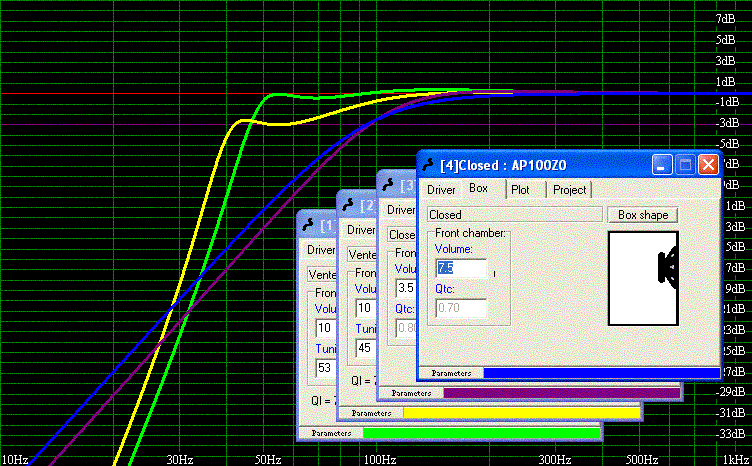

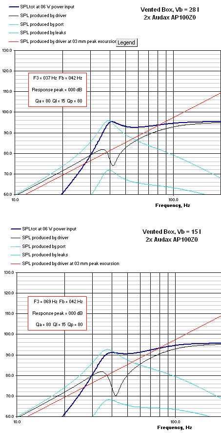

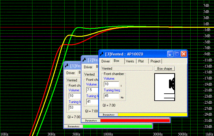

For the bass I was thinking the options were quite open. Shows how much I know.
Well I was thinking a ported enclosure of ~28l perhaps. Or even 15l (factoring room gain of some sort) which I much prefer the size of.
The mid enclosure size doesn't appear critical so maybe ~5l, or larger to bring down the Qtc. And then a happy tweeter on top.
Vikash said:For the bass I was thinking the options were quite open. Shows how much I know.
Well if you'll accept 6dB loss down to the port frequency there
are more options, but you don't get much more bass than 3dB
loss, and you lose a lot of bass efficiency, just my opinion but
the 6dB drop is too rapid for room gain to come to the rescue.
Regarding the mid as Vas is ~ 2.5L anything much bigger than
this is not really helping IMO, Qtc shouldn't really be a major
factor given you'll be crossing over higher than this, distortion
wise I'd say around 3.5L is appropriate.
🙂 sreten.
