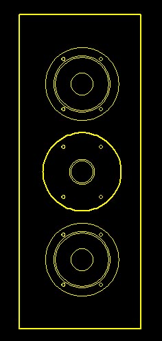

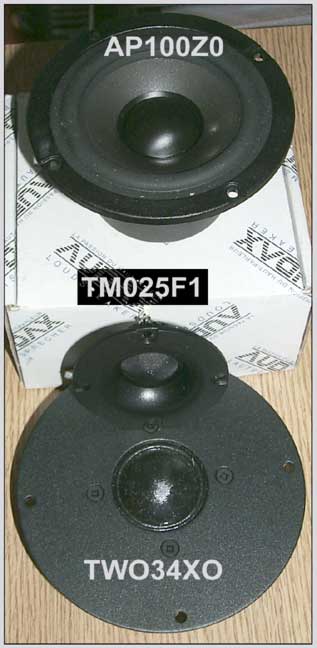

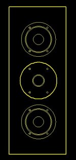

Alot of the designs i am CADing seem to look odd due to the 34mm tweeter, any suggestions on layout. I really am considering using the F1 on this project and saving the 34XO for another.
D1GGY,
For 'normal' flat, vertical baffle:
You can do it as a 2-way or 2.5-way as the 0.5-way part can be considered separately from mid-high crossover. 3rd-order Butterworth with reverse-polarity connected tweeter is the way to do it.
The crossover network is no more complex than any other 3rd-order filter. The clever/tricky part is spacing things out according to the correct wavelength and choosing the appropriate crossover frequency.
The theory is fairly complex to a crossover newbie, but basically the 3rd-order filter has a -15 degree tilt in the polar response due to the phase differences between woofer and tweeter. If you space the tweeter and woofer apart appropriately, i.e. +15 degrees tilt, you can make the combined tilts cancel each other out and so you get a straight-forward directional reponse.
You could work out the required driver spacing with trigonometry, but this is just a theoretical starting point. The radiating point for each driver at the crossover frequency may not be where you think. Complex measurement is the only way to be sure.
I would also do it as TMM configuration, as when the baffle step driver comes in it will be not be as close to the midrange as it could be. EDIT: hmmm, that would make it a bit dodgy doing the upside-down tweeter and mid arrangement then...

D1GGY said:
my initial thoughts on the front baffle........
19cm wide, 50cm tall.......depth as required for volume.
Don't forget about internal standing waves. You might want to design around a volume rather than just the baffle dimensions...

Vikash,
my text may be little misleading, The dimensions were calculated by winisd, i could not remeber the depth measurement hence my whatever statement. Am i correct in interpreting your comment that i should only use the "optimum" dimiesnions offered by such software?
In Which case my measurements are a little tweaked.
I must admit that I've not been following / reading this forum - but please reconsider using the F1...It's really not nice. I used it in an Audax speaker that used to be published on the Audax.com website...I didn't like it at all.
Just my opinion of course...Good luck!

Just point out to you all the 34mm audax tweeter is as old as
the hills (almost) and dates back to the days of the ubiquitous
1" Audax soft dome in nearly every decent speaker.
There were two versions, this does appear to be the high efficiency.
🙂 sreten.

I realise this is a bit late in the thread, but I just thought I'd mention that I believe this 34mm tweeter was used in the BBC designed LS5/8 and LS5/9 systems - these designs date back to the late 1970's (there's some stuff about them on my WWW). The price reduction is certainly good news for anyone that wants to hold a couple of spares.
It's been a while since I did any speaker design, and back in those days I calculated everything by hand. I see a variety of CAD packages are in use here - although perhaps off-topic, could anyone provide pointers (to another thread, perhaps) or recommendations towards the best packages?
Also, I was attracted to the F1 driver on aesthetic grounds, but I saw Gaz's comment. Any other recommendations for a small unit that won't look too big next to these tiny woofers?
