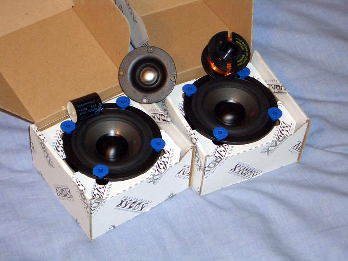

Anyway, I spent a few minutes with my soldering iron before and turned these:

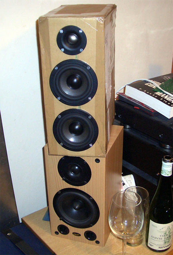

As you may guess it's a bit difficult to properly judge how a single speaker in a cardboard box sounds. However, it does show signs of potential, as it easily outperforms my existing speakers when playing back acoustic guitar or female vocals. It's a bit week in the bass department at the moment, but I'm guessing this will improve as the driver bedds in and when it get's its propper vented enclosure. The other thing which would appear to need tweeking a bit at the moment is the tweeter, which I think still needa a little more attenuation (currently 2.5 ohms in line with the nominaly four ohm tweeter) to match the level of the two mid/bass units a little better.
But other than that, it sounds a lot better than £28 of components in a cardboard box hava an right too, and I am looking forward to see just what can be sqeezed out of these drivers (and possibly even get two the same for some propper listening), just have to see how friendly the guys in the engineering deparment are with regards to cutting me up some MDF...
I think I may have discovered the reason for the harshness in the speaker. I designed the crossover assuming a 1 ohm resistor being used to attenuate the tweeter when I ordered the components, and then realised I needed about 2.3 for propper attenuation. So, the axtra 1.5 ohms I ahev in there at the moment means the tweeter is comming in at 2500Hz, and the mids not being taken out untill 3200Hz.
oops.
