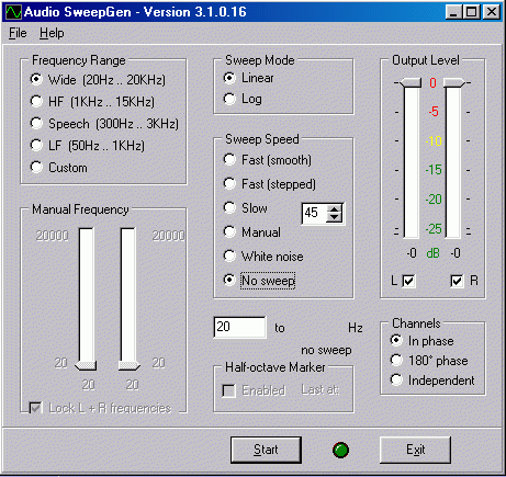

Assuming that you can get an amplifier connected up the soundcards outputs on your computer, then you can d/l a signal generator program that will produce a 30hz sine wave or similar. Then just connect the lil speakers up to the amp and leave it going over night for a week or so. Because these are small drivers and outofbox you wont be able to hear a thing.

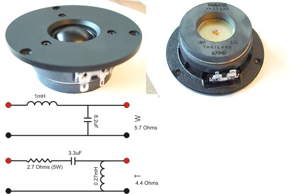

I've got some spare Yamaha 2-way speakers that came with a micro system and was wondering whether the tweeters could be suitable for this project. They are 1" fabric dome, magnetically shielded and look quite nice.
I've spent ages analyzing the crossover (which is probably dead simple to some of you 😀 ), and I've attached a diagram with the component values. Hopefully someone can tell me what the crossover point is to give me a starting point.
It looks like Yamaha manufactured the tweeter, so not much info to be found. Any input?
Hi Vikash,
Until a calculator-lover helps you out, I'll guess at around 5khz for the tweeter, and a little lower for the woofer.
I think it's normal to leave a gap in the presence zone, to avoid harshness from crap electronics and recordings. Plus, maybe they're crossed over like that to allow for a rising response caused by the woofer's breakup.
Someone will know how to work it out 🙂
A) An excellent freeware signal generator is available on David and Cecilia Taylor's homepage at
www.satsignal.net Go to Audio Tools
Just click "wide" for Frequency Range, and then click "No Sweep" for Frequency Sweep. Then where it says "20" in the box, fill in whatever frequency you wish. Illustration below.
B) If you have a more advanced sound card that has speaker level outputs, like with 2 or 3 watts or more, you don't even ned an amplifier. Just hook the speakers directly up to the sound card. I have an old Sound Blaster with a four watt output in the speaker output. Cables to connect should be quite cheap-just use a cord with a stereo 1/8" plug on one end, Walkman style, open wire on the other-or you can buy 1/8" to 1/8" extension cord and cut off one end. Use the same ground wire for both channels.

Thanks kelticwizard just the thing i am after.
