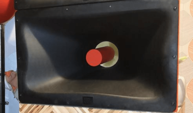

Borrowed faital hf108 to test in jbl horns. 0 and 45degs compared to bms 4522.
seems that 4k bump is coming from horn. 4 drivers tested and best has been allready sold b&c de25 🙂 story of my life.
gotta try some felt padding inside horn if it helps, might be throat opening angle issue

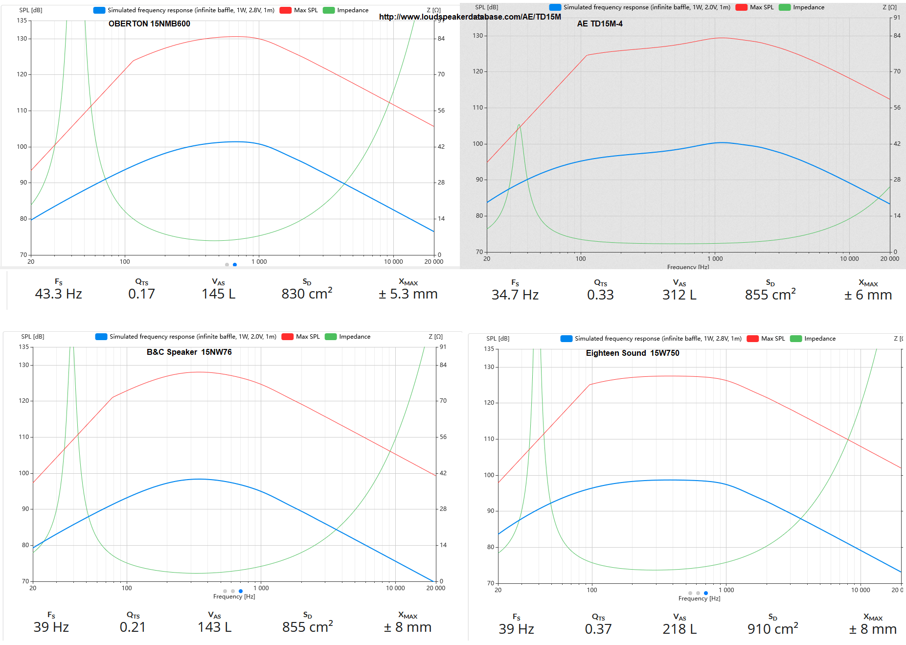

I wouldn't use high power handling, low QTS woofers for home. After comparing B&C 15NW76- 0,21QTS with 18Sound 15W700-0.3QTS , JBL 2226 - similar, and 2035HPL-0,34 QTS I wouldn't use anything below 0.3., 0.34-0,39 and lower wattage are sound better. Low QTS high power handling drivers = power hungry and use for high SPL.
I measured my Qts=0.2 Oberton 15nmb600 and it was very similar to my qts= 0.6 Acoustic Elegance 15m.....Outside of high/low frequency roll off there were plenty of similarities, in particular in the desired passband.

I'm not sure what you measured, but in reality AE produce 2dB more in LF (40-100Hz) and without of EQ there is no comparison to low QTS transdusers. In low QTS drivers 200-700Hz will outrun LF by 6-7dB. If you apply an EQ and lot's of power it'll be another story, but we are talking about home use.I measured my Qts=0.2 Oberton 15nmb600 and it was very similar to my qts= 0.6 Acoustic Elegance 15m.....Outside of high/low frequency roll off there were plenty of similarities, in particular in the desired passband.
P.S. We are not talking about horns.
Maybe start doing real measurements and not sims? Let me see your simulated Bust decay lol. Not that its anywhere near accurate...just making a point. FR can be changed with electronic filters... I don't think the roll off is so dramatic that eqing this driver a 0.5Q would an issue to achieve....so whats left? Decay characteristics surrounding the different modes a driver can have (Fs, Break Up, etc), with an actual mic and driver you can see this stuff. Not with the sims you posted though.
