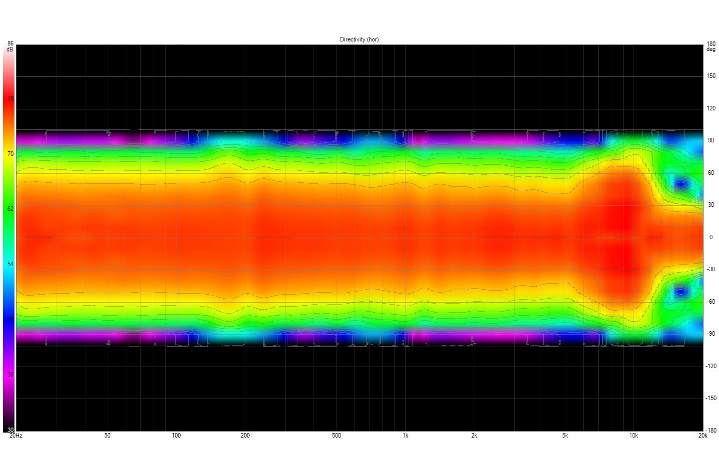

Endfire setup with smaart, quite good in phase-wise 🙂
Theres something wrong with eq´ing lowest protoplasm under lowest room mode in this place so i did not use any boost.
My listening spot suffers from direct radiating bass quite bad (blue line)
I enjoy using smaart
today i measured 0-90deg in-room 350-20k
midrange had slightly shorter phaseplug, but it seems to widen 1k and narrowing 2k.
7cm longer plug performs more evenly.
i might need to put it into a box, theres only lossy basket baffle which helped a lot but sure it leaks, 350-900hz some of those are from room, some really from rear of midrange.

it looks like this if i turn delay off, its a bit different to OB cause theres 45cm between drivers (maybe ~20cm between voicecoils.
i think genelec W371 bass has similar no delay setup against sidewall reflection.

i believe this is DE25 impedance and 90deg polars, not true under 2k i belive that was 1300-20k sweep from rew.
DE25 easier take down with serial resistor.
i have to listen a little bit which angle to straight response, i believe that DE25 was on the hot SSC level. Tilting waveguides takes down that hot spot but affects polar responses.
And vituixcad doesnt have my processor in it so i cant slap raw responses in, i have to measure with eq´d responses. delay and level only in vituixcad
I have lots to mess with
okay, seems that 2384 and 2374 looks about the same but aint.
2374 doesnt seem to have that much peaky 0deg. i could not find that much boost from 0deg from any height.
here is vertical 0deg from 2.5m distance as high as my micstand goes over my ear level when standing to below listening spot height.
here is listening axis from 2m 0deg and 45deg.
