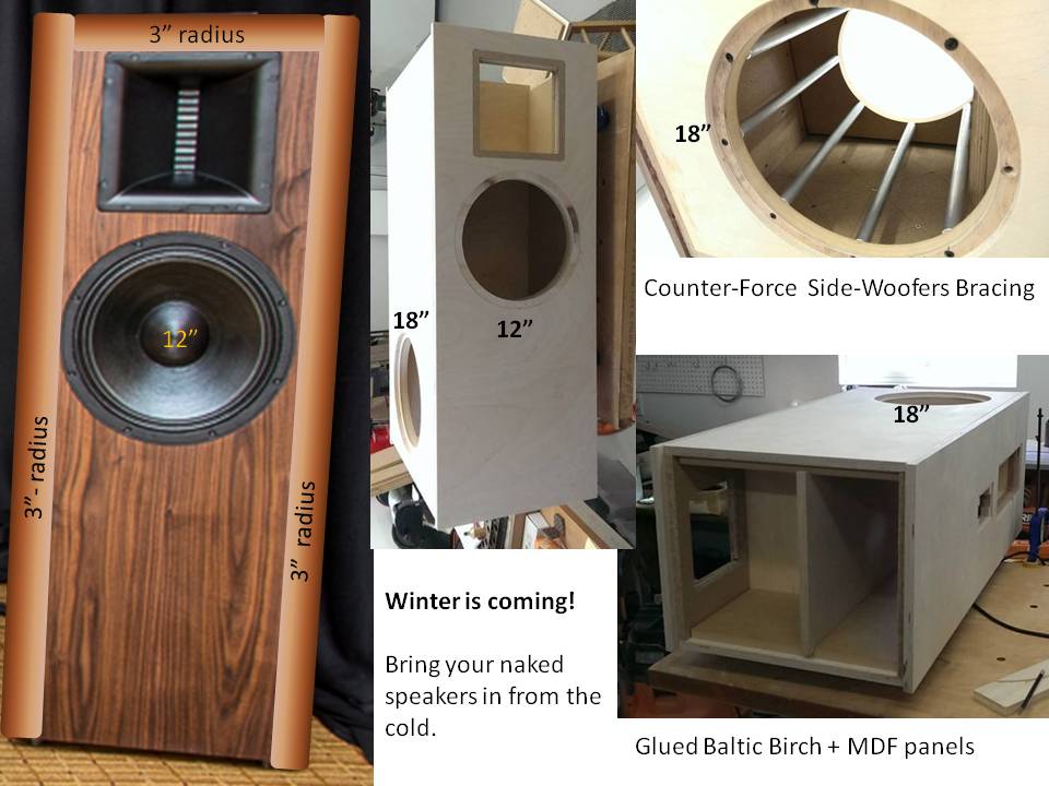

Man9 little christmas high db special:
better than nothing braces. one takes 113cl space so around 11liters total loss.
little unsatisfied when i had to put one brace quite close to driver.
waiting for the last parts
WINTER IS COMING!
A good time to put a few naked speakers into a sealed box. While you are building wooden boxes, why not knock out a well respected clever design.
There is Order even in a Chaotic Universe. Your best drivers are very well suited for a high efficiency 3-way sealed box speaker. The entropy of the audio universe will gradually move them in that direction.... maybe this winter?
