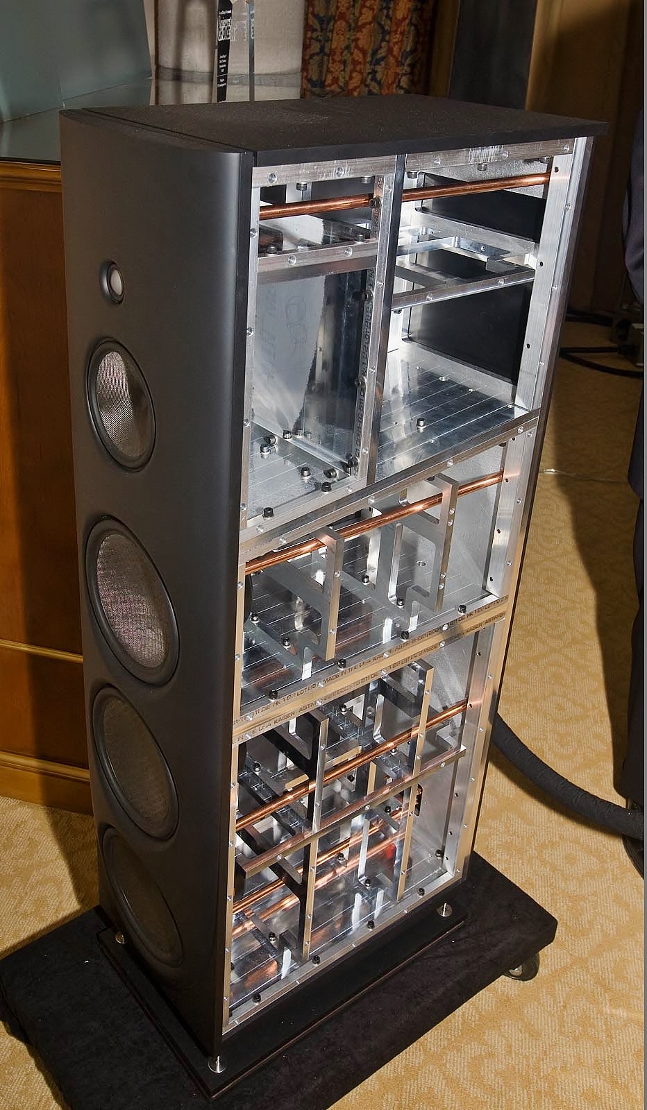

Come on guys.... That is the skeleton of the Magico Q5, a sixty-grand (US) 180kg, 4-way sealed box without the "skin". Machined from solid blocks of alu. and brass, should be inert enough, I guess. Wifey can't just throw those out, at least not without a forklift :)

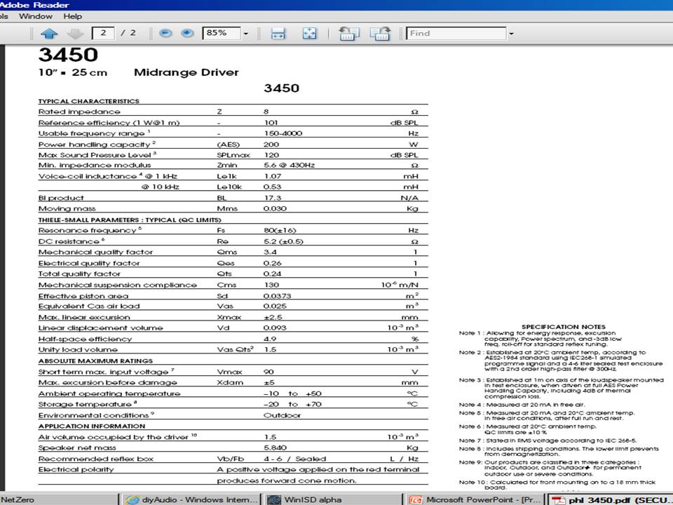

Posted a sealed box simulation of the PHL 3450 using T/S parameters from their website: F3 ~ 224Hz in a 0.13cuft sealed box for Qtc=0.71. Most designers favor the superior transient response and low phase shift of a sealed midrange. The PHL 3450 spec has an Fs of 80Hz and Qtc of 2.4, so a ported box ~ 0.4 cuft tuned to 130Hz can provide -3db of 125Hz with a modest bass shelf.
The 18" BMS 18N862 woofer datasheet SPL looks up to the challenge of even a 225Hz crossover needed for the sealed box PHL 3450. BMS 18N862, VB = 179.1 L, FB = 22.9 Hz, F3=33 Hz,
The Beyma SPL plot for the TPL-200H suggests a 2KHz crossover, an LR4 slope would be a good first simulation. The TPL-200H is Beyma's highest efficiency and highest power handling AMT. The Beyma TPL-150H treads emphasis the need to select a midbass crossover frequency which has a polar pattern similar to the 80H x 30V of the TPL-200H horn. I could not find a polar plot for the PHL 3450.
