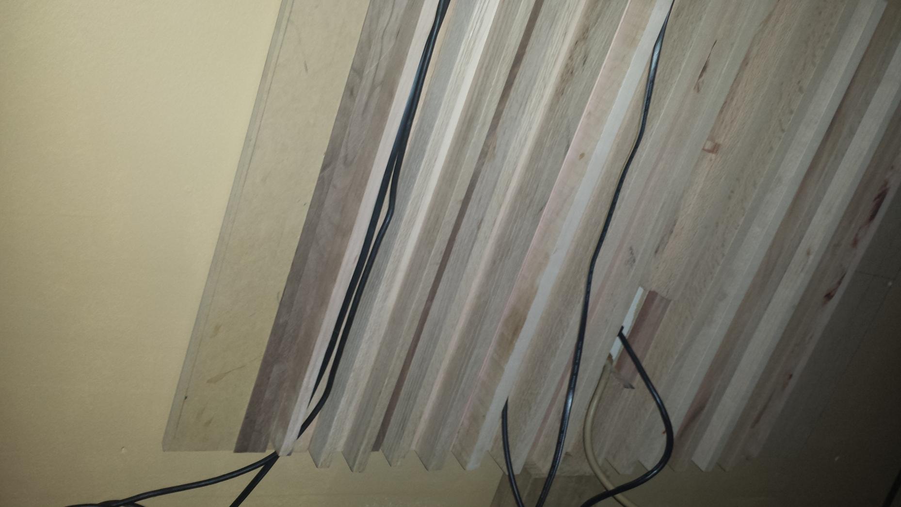

I got so close to finishing this panel. I dont know when I will but I had to try it. Results are positive and immediately noticeable. I still plan to build a second one with deeper wells to try.
I had a hell of a time getting it on the wall partially. The block underneath and one screw are all thats holding it until Im able to line it in proper. But sound is more important than looks for now.

Pardon me, but what is that panel of yours? Any info?
It doesn't look like either a Schroeder or a Leanfuser design but some sort of 'grating' or single frequency diffuser with wide fins between shallow wells - I don't know of this one ...

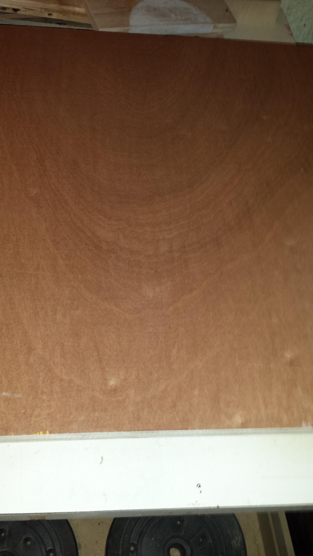

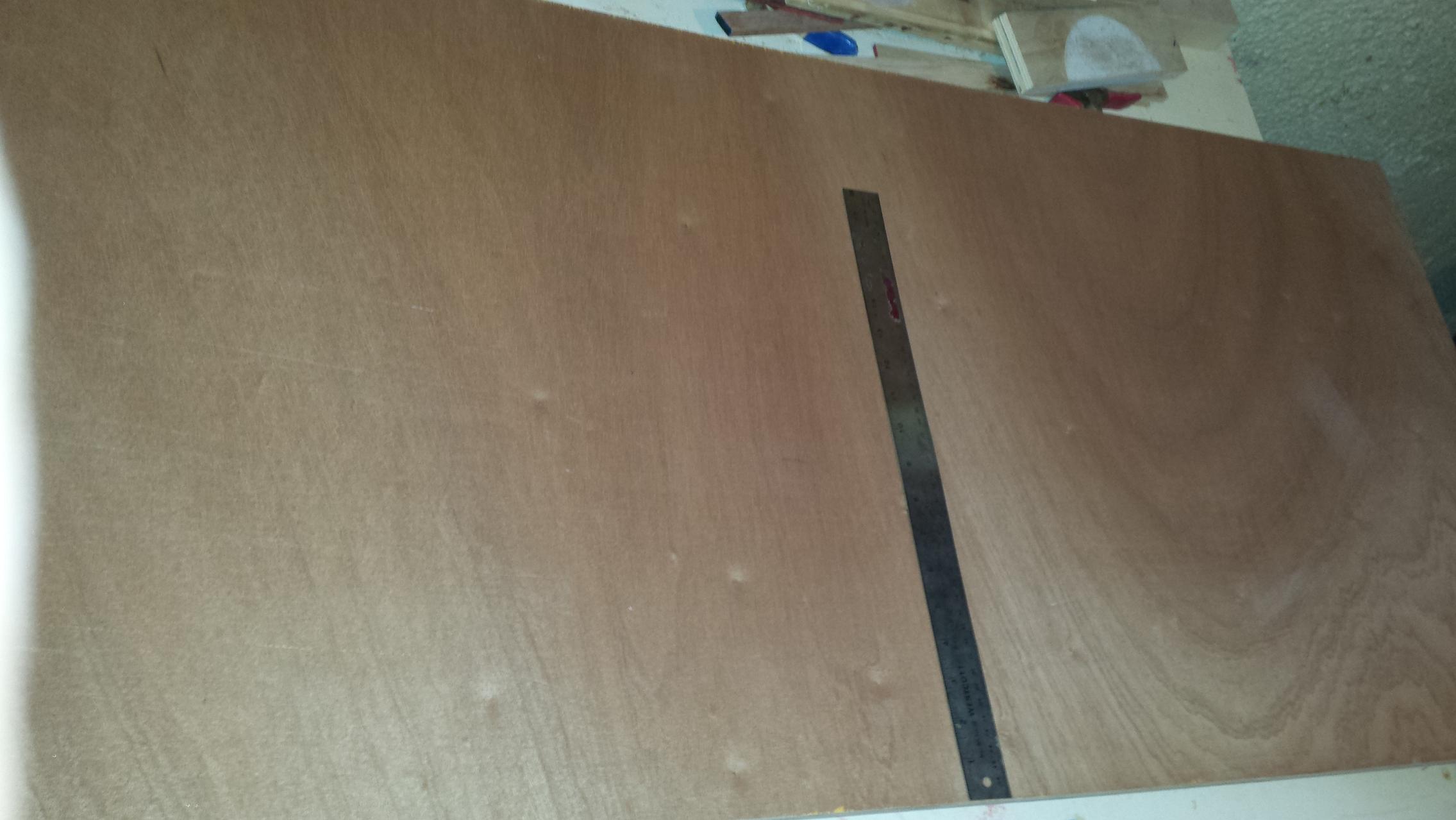

For my next try instead of using a flimsy piece of .25 mdf backer I have a larger piece of multi layer birch ply approx .75" thick. covering that is fine veneer with grains cascading through half the 48" span that reminds me of a waterfall. that with the birds eye looking details speckled throughout should make a nice front piece along wall. I might arch the vertical ends slightly in search of more eye appeal.
then instead of hardwood runners I will use a finished birch ply for the runners to create the channels. I will also miter the backboard .75w x .25d" this time to lock them in place opposed to gluing strips in between them, that along with glue.
