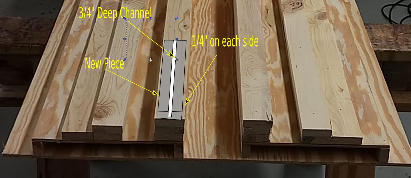

As I described earlier on, I added 1 1/2 inch wide, 3/,4 inch thick wooden pieces, each with a 1/2 inch wide, 3/8 inch deep channels down the middle of them. This makes these diffusers what Tim Perry calls Leanfusers, diffusing higher in frequency. I also modulated the various individual panels by varying their height off the back wall. This modulation helps to improve diffusion down below 1000 hz.
I did take some pictures and at some point I will post them.

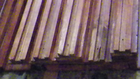

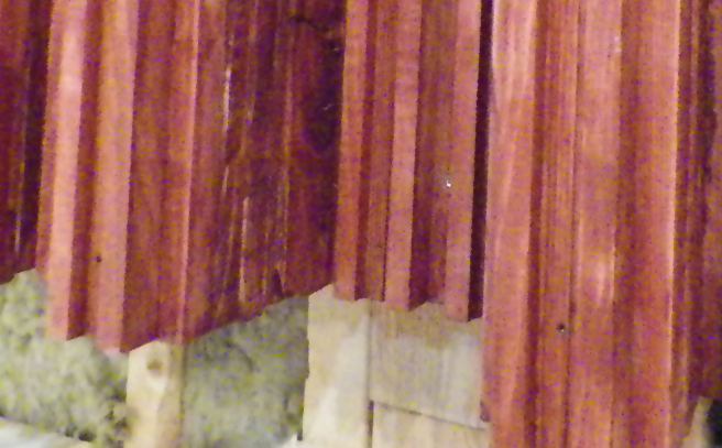

Here are a couple more pictures which I hope shows better what I did (I hope that they load...).
Again, I took 1x2 pieces and ripped a 3/8 inch deep channel down the middle of the pieces when they were sitting with the wide side down. I mounted these in the center of each 2 1/2 inch wide "step" of the stepfuser.

How wide is the channel?
I have a dado blade, so I can cut the channel any width I need.
I took a pic of one of my diffusers and tried to put some annotation on top. Is this correct?

The channel is 1/2 inch wide. That way there is 1/2 inch wide taller piece on each side of the channel. Then outside of the board, 1/2 inch wide parts of the original step diffuser is exposed on either side of the added 1x2 piece.
Retsel
Thanks, I didn't really pay attention to the depth, I'll make them 3/8's as you did.
I see, you're using a 1x2 but the actual dimension of it are 1 3/4 wide instead of 2. So that leaves closer to 1/2" on either side exposed.
