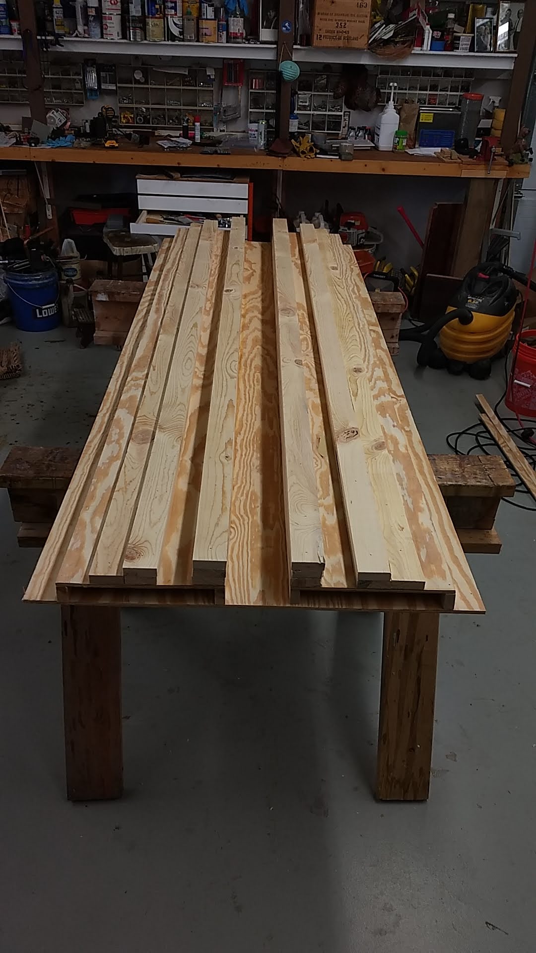

My daughter and I had a great time building the Depot Diffusers out of foam board this weekend. I kick myself for not taking pictures because we only listened for about 2 hours before we had to take them down so she could bring back the foam board to school today.
My main concern was how they would sound if I could only be 4 feet in front of them. I was extremly surprised at how much deeper the room sounded. I could hear any issues with being so close it was all just good. So as soon as my contract picks up again, I'll build the real thing as doors on my Ikea unit.

Sorry for the late reply, unfortunately I forgot about this thread so I am behind with the promised pics.
Did you try the foam diffusors as doors or as inserts in the rack?

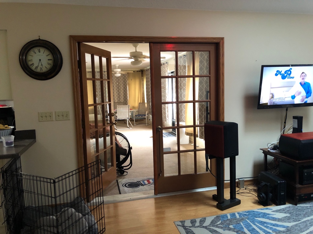

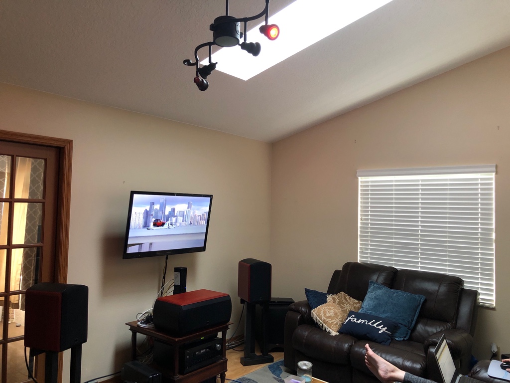

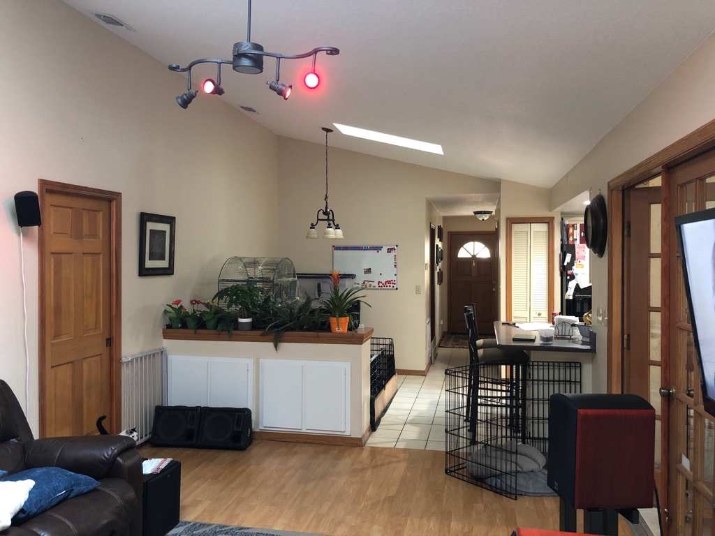

Hey friends,
I have read quite a few articles here but just joined since I am preparing to undertake this project. A photo of my room is attached. I love my Magnepan 1.7is but ofcourse the sound comes out of the front and the back. The biggest issue in the room is this inset area you'll see behind the TV and speakers. If I put the speakers closer together / anywhere near that section, the sound bounces and around and gets screwed up. I do enjoy having the speakers a bit wide but that area is the single biggest issue with my room.
Problem area is 7ft tall, 2ft deep and 122 inches wide. I have read this thread in totality and love all the changes everyone has made.
Looking at my setup, what would you suggest?
1. Build the current plan with just the two panels. Since I have a TV maybe going the full length of the space is not needed?
2. Building two panels that would fit the full length of the space.
3. Building one mega-panel that covers the full area.
Please note that I used to have the TV mounted to the wall but have since moved it to my equipment rack. TV and rack are moveable but I'm really digging the current placement. Moving them forward any further would really be too close given the size of the TV relative to couch placement.
I know this is an old thread but I would love to hear any thoughts from you fine enthusiasts.

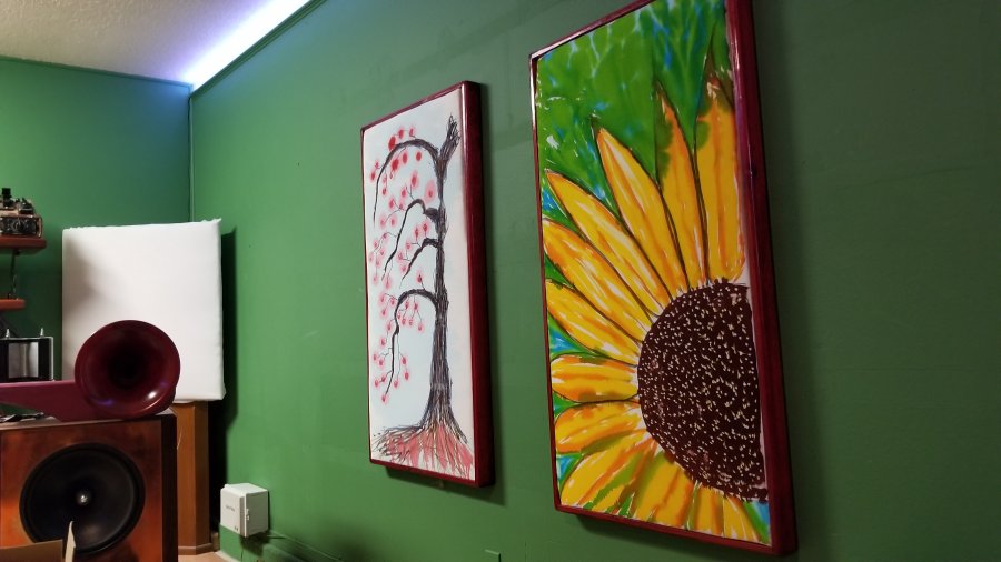

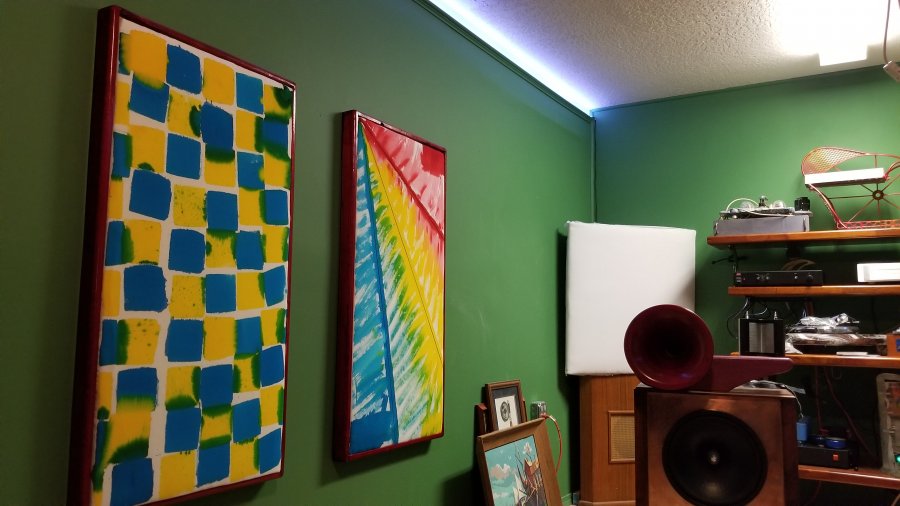

I've made some progress on my room in between amp build projects. I have one set of superchunk bass traps made and up on the subs and the other set is on the bench ready to be assembled and stacked in the from corners.
This week I made 4 first reflection point absorbers with 2" ridgid OC703 board with 1"x 2" frames. I covered them in white muslin and they looked sooooo bland I decided to paint them with cloth dye so they still absorb sound like normal.
today I am making the superchunk bass traps that will sit on the exiting ones you can see in the pix above. Then on to making the Depot diffuser as doors for my LP storage behind the listening position.

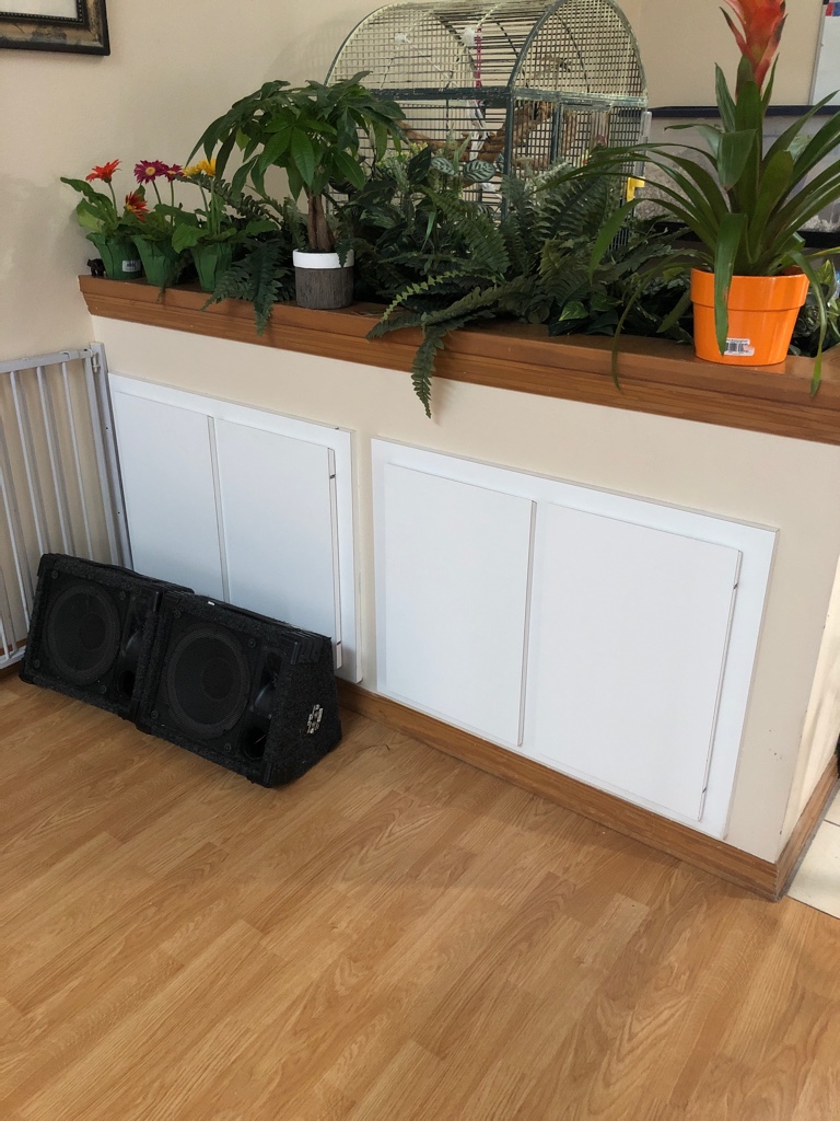

One question though. The storage rack is 70" wide do I'll use two of the diffusers as doors. Can I just match them up at their natural side points?

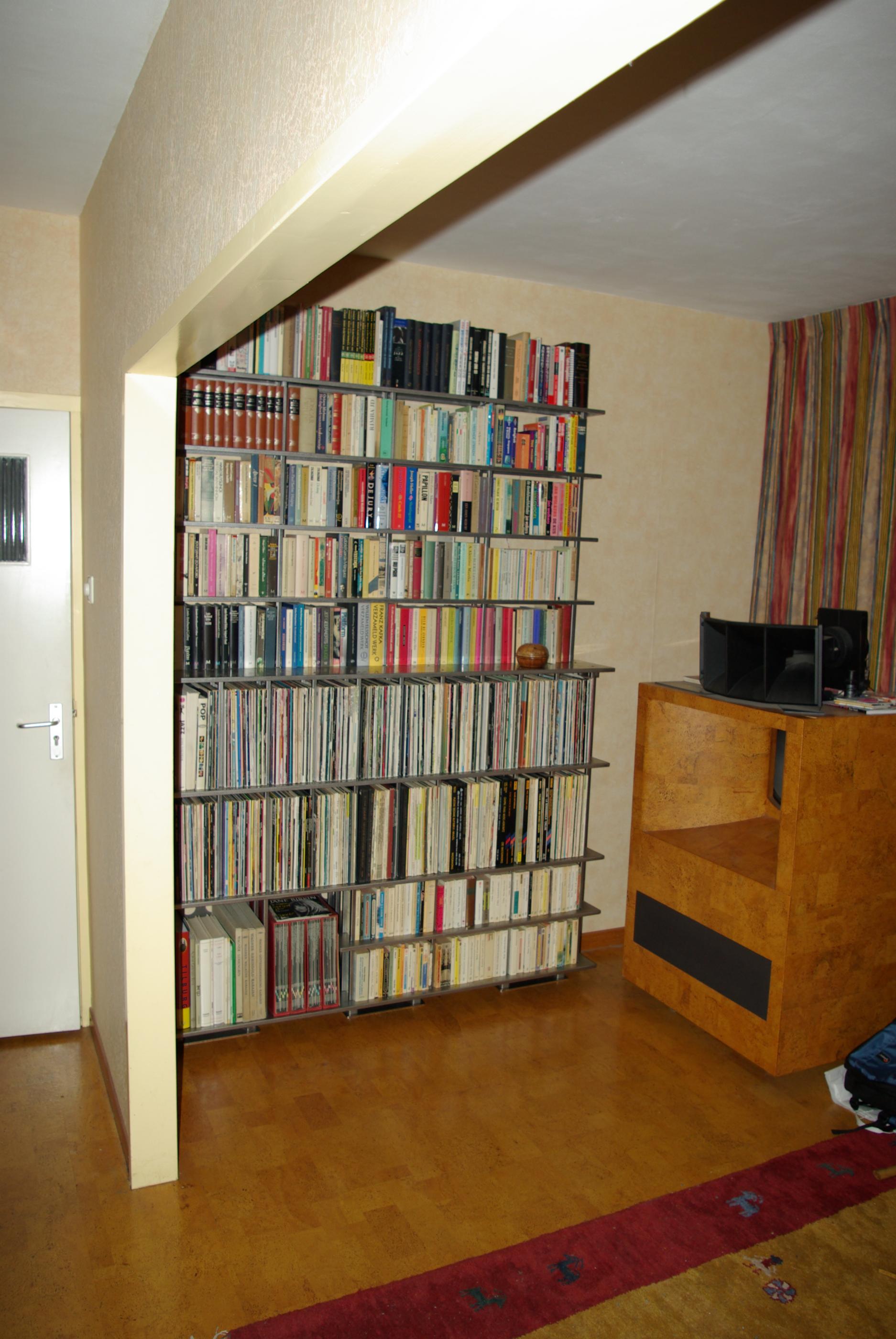

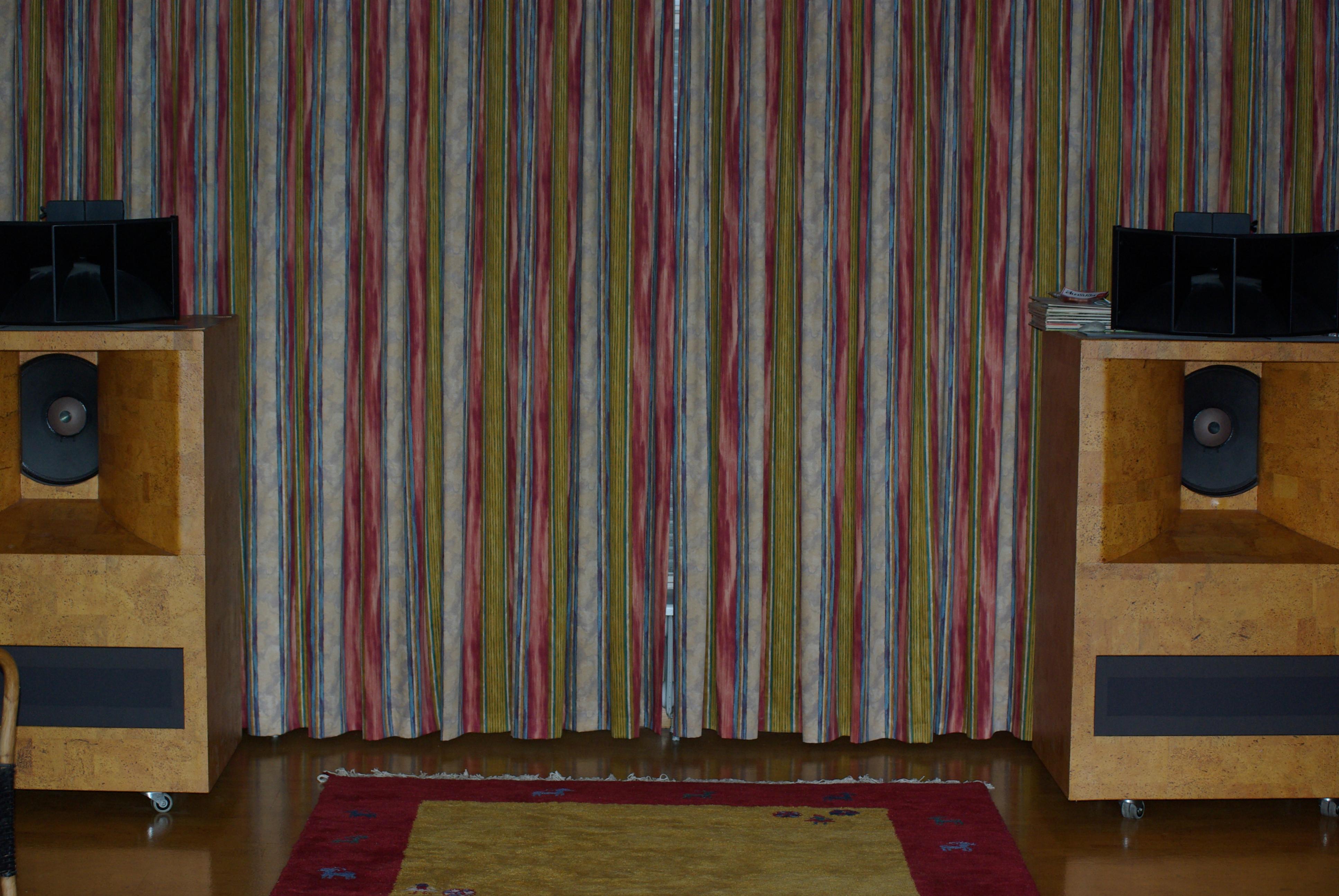

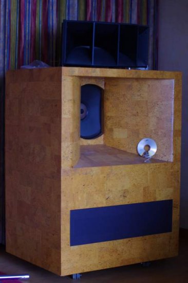

Hello,
I have been searching the internet finding a way to improve the sound of my room. It doesnt have a hard sound if i listen to my system but when i clap my hands i can hear there is to much reflection for sure.
The space behind the speakers is 80% window but the curtain on this side of the room always closed. SO i could install some kind of diffuser or absorber between window and curtain.
On the opposite side of the speakers , 5 feet maximum behind listening postn there is also a lot of glass. There are curtains but 99% of the time they are open.
In front of both speakers there is a little wall at 6 feet from the front side of the speaker. A kind of '' arch '' so to say. 80% of that arch is covered by wall mounted racks with blu ray and magazines.
From my listening position i can see the total shape of both speakers.
My idea is that with horn speakers the influence of the space close to the speakers could have less influence soundwise.
But i wouldnt mind covering the ceiling in that part of my room with 2 square meters with some product.
I have seen the BBC designed skyline diffuser and i have seen one video on you tube from an Eastern Europe man who made a program to enter your preferences so you can make the panels fit better into your space.
The wall left and right in front of me when seated are already taking by some art, furniture, flatscreen and mirror. I think it will be possible to put a diffusing surface equal to a 55 inch screen on both sides.
I can not put them opposite each other but a bit in the same area. One probably horizontally and the other vertically
Any suggestions and/or links are welcome.
Greetings, Eduard
