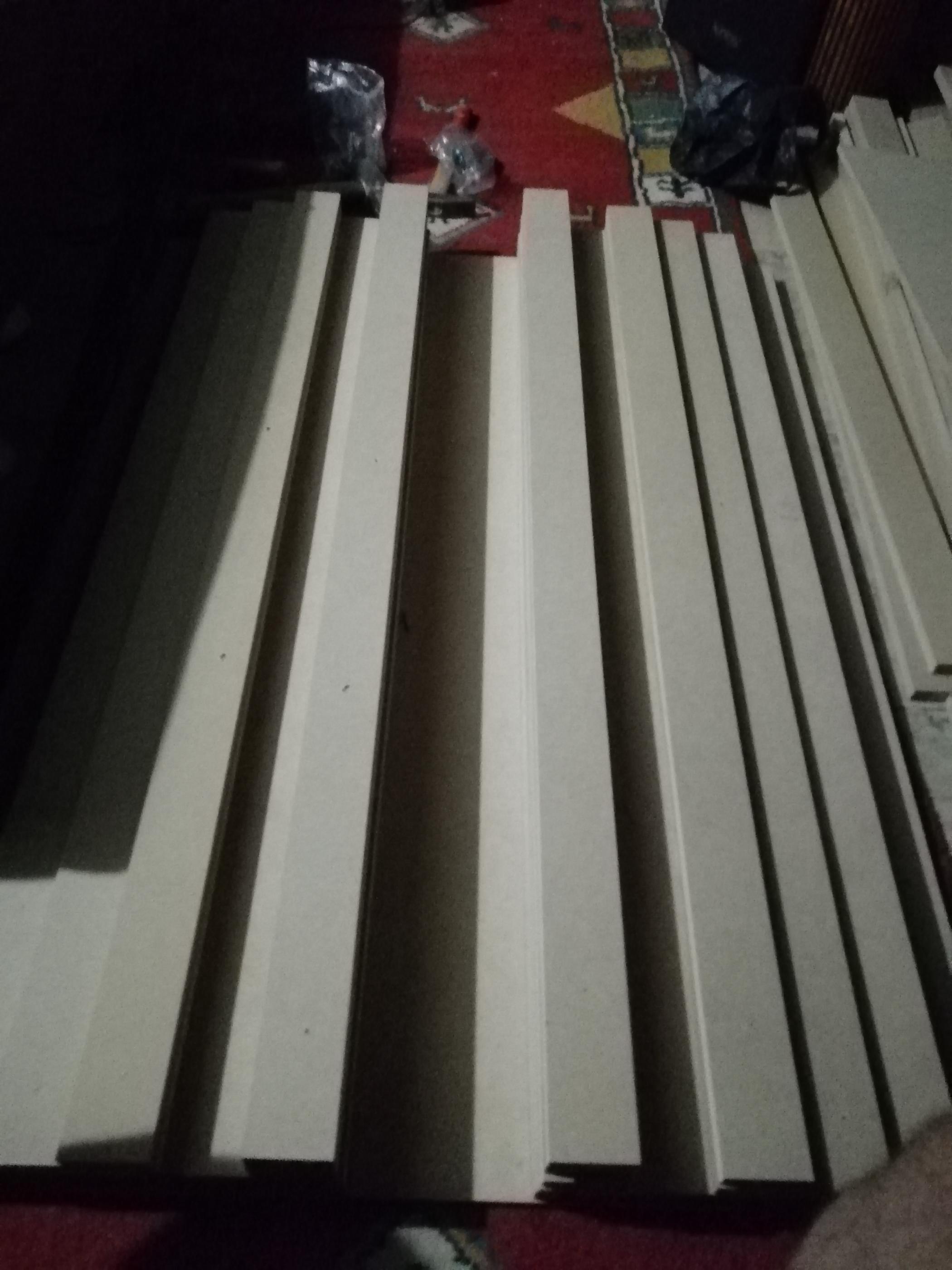

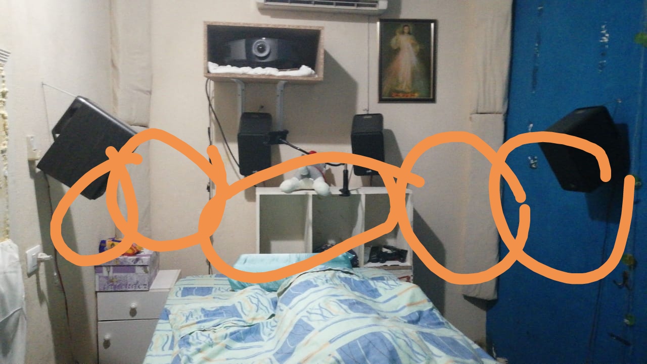

Space is a limiting factor in my case, the width of my back room is 2.4 meters, i'd like to make 5 120 x 87 cm diffusers, original width, half length. They will cover my back wall and most of the side wall aswell, i'll attach a. Messy picture.
My back wall isn't flat and parallel to the front wall, it's angled to the inside with around 20 cms difference from start to finish.
Thought about placing the diffusers in random angles(it's the only option really, would that be problematic?) , using 2 in the corners, one in the middle of the back wall, 30 cms to the front, and 2 facing one another at the side walls(not really parallel) they'll bs 2.5 to 3.5 meters behind the listeners head so the created a nice ISD gap,it's a LEDE room, thanks for your help
Oh and i'll be using a mixture of 10 and 18 mm mdf to do everything, for economical reasons, that wouldn't be a problem, right?

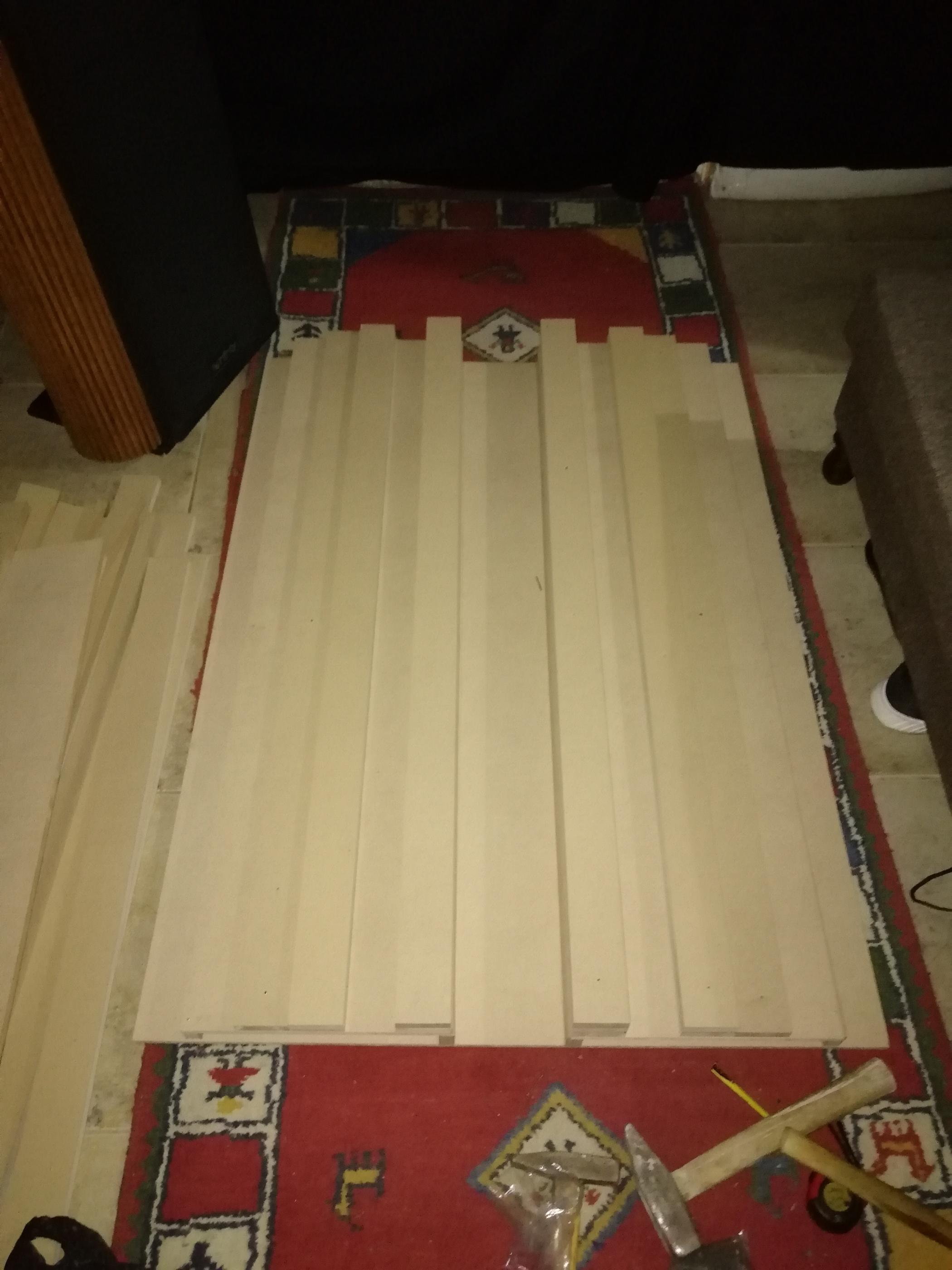

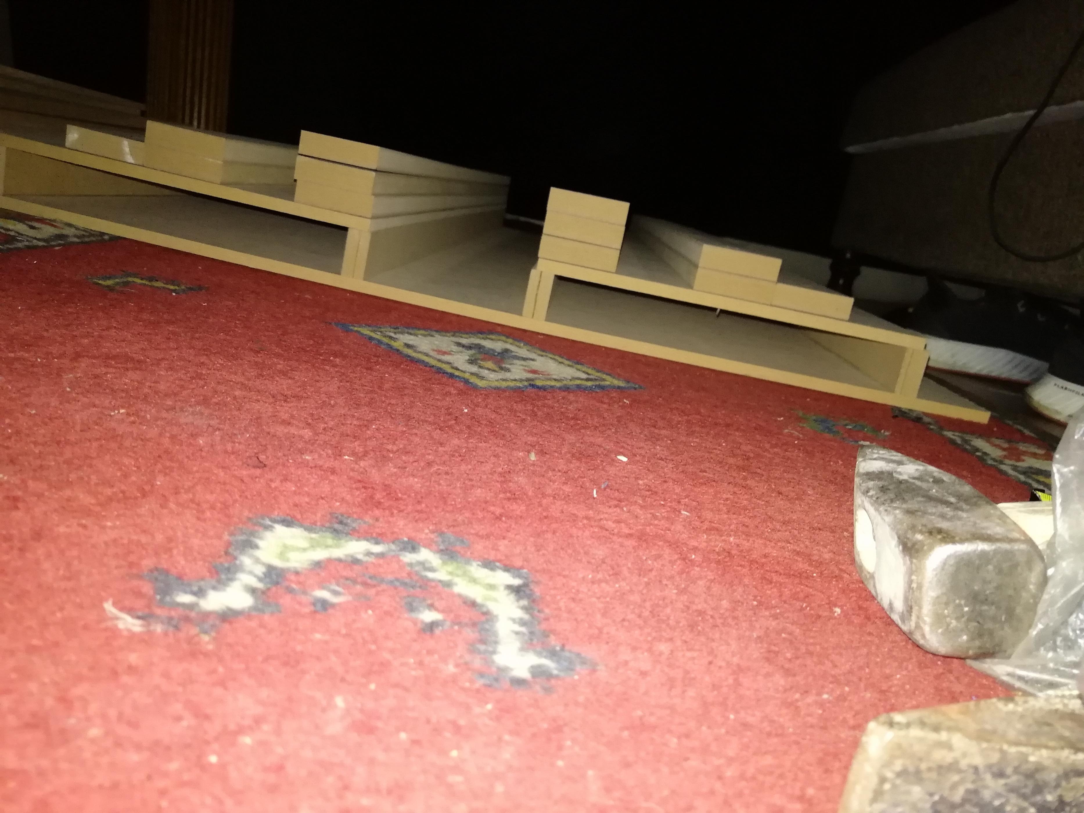

Thank you for the replies guys, and for the design bill!
Using 10 mm mdf for the backboard and 18 mm mdf for everything else, i was able to make 5, half length ones(122x87 cms)
Costing 75 dollars in total for everything, and they even cut everything for me so i didn't have to deal with dust.
They are a bit heavier though that's correct.
I'll post some. New pictures and measurements in my room once they're installed!

Thanks! The cost was excellent and easy enough to finish using a hammer and nails.
I'm yet to decide about painting them, but it should pretty straightforward and easy!
Hope. I can get to perform as planned,hoping for a strong haas kicker at 20 ms or above, let's see!
Would definitely do that, i'll. Measure after each panel installed actually, and see the difference, would be nice to know how. Much diffusion is needed in the live end of the room, and how much benefits i'm seeing with added panels

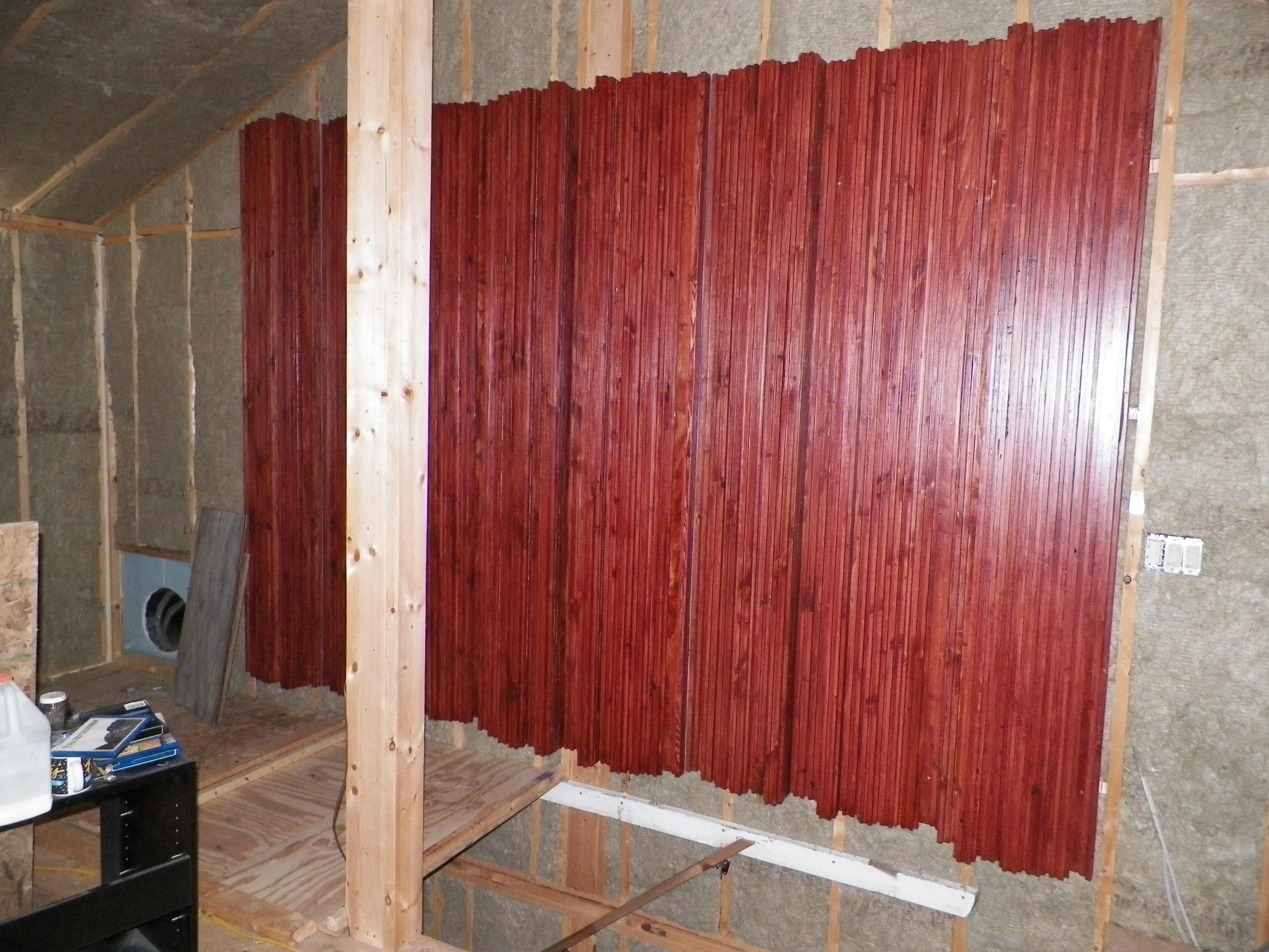

If you have multiple panels across the back wall, you should modulate the panels so that they are at different "heights" off the back wall (not heights off of the floor). Tim Perry, who is the original brainchild of these, modeled these using an acoustics program named AMFG Reflex. It showed that if multiple panels are mounted on the back wall, all at the same height off of the back wall, that the diffusion coefficient is not that good (worse than a single panel would indicate. The diffusion coefficient is much improved if you modulate them. In my case, I made my middle panel 2 inches off the back wall by mounting them over 2 inches of XPS. The next two panels on either side of the middle panel were mounted directly on the back wall (on the studs). I divided the fourth panel into two pieces and mounted each over 2 inches of XPS at the very outside of the panels, at the same height as the middle panel.
So why did I choose the modulation pattern that I used? Tim sent an e-mail out about a diffuser design that Cox/D'Antonio created that Perry thought would be great. The leanfuser used a different pattern than this Cox/D'Antonio design, but I could emulate their design by modulating the panels the way I did. I think that the Cox/D'Antonio modulation was more like 3 inches of height difference off the back wall, but I had to use 2 inches because mine are mounted above a stairway and raising their profile any further would start to create an overhead issue with people coming up the stairs. Also as the amount of modulation increases, the distance that you must sit from the diffuser increases which places the listening position further away from the back wall and more into the middle of the room, which is not desirable for my situation.

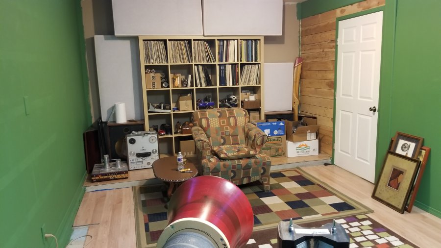

Ah, thanks for the comments on the video. I just did that as a quick test for myself and was so impressed with it I uploaded it to youtube! I'm not a guitar player as is clearly shown there 🙂
I live in Bellaire, if you come "up north" to Short's, give me a shout and I'll meet you for a beer. Although these days that requires a reservation at Short's!!
I've very familiar with Ethan Winer, I've read a lot of his stuff. Very practical and good information from him. I've also been to Tim's site a number of times, but do need to go study that info more.
For the room I'm talking about, it's not a listening room, so there are no speakers or back/front of room. It's a live recording room in a new studio I'm helping build. The control room is full blown acoustic treatments with little diffusion, it's mostly absorption as it needs to be pretty dead.
But the live room is a bit interesting. You don't want that to be dead like a listening room and you'll have instruments, singers, etc. at variable places around the room. But you also don't want standing waves and you don't want wild echo's or flutters. You want a nice even decay that sounds good when someone stands in there and sings. So this will be a "live" recording room.
Yes, first job is to trap the corners and deal with the larger modes. We'll probably also trap most of the ceiling. From there it's about creating a nice sounding acoustic room. The room isn't huge, about 20'x14' or so, but big enough to keep most things around 5' or so from a diffusion panel.
I haven't started working on the room yet, we'll put in things and see how it sounds and adjust as we go. That will also be interesting. I can use REW to look at things, but it's really more about playing some music and listening and recording a few things. I'm not sure you can apply the results you get from things like REW the same as for a listening room. You wouldn't want to run REW on your shower, but many great vocal recordings have been done in shower stalls!!

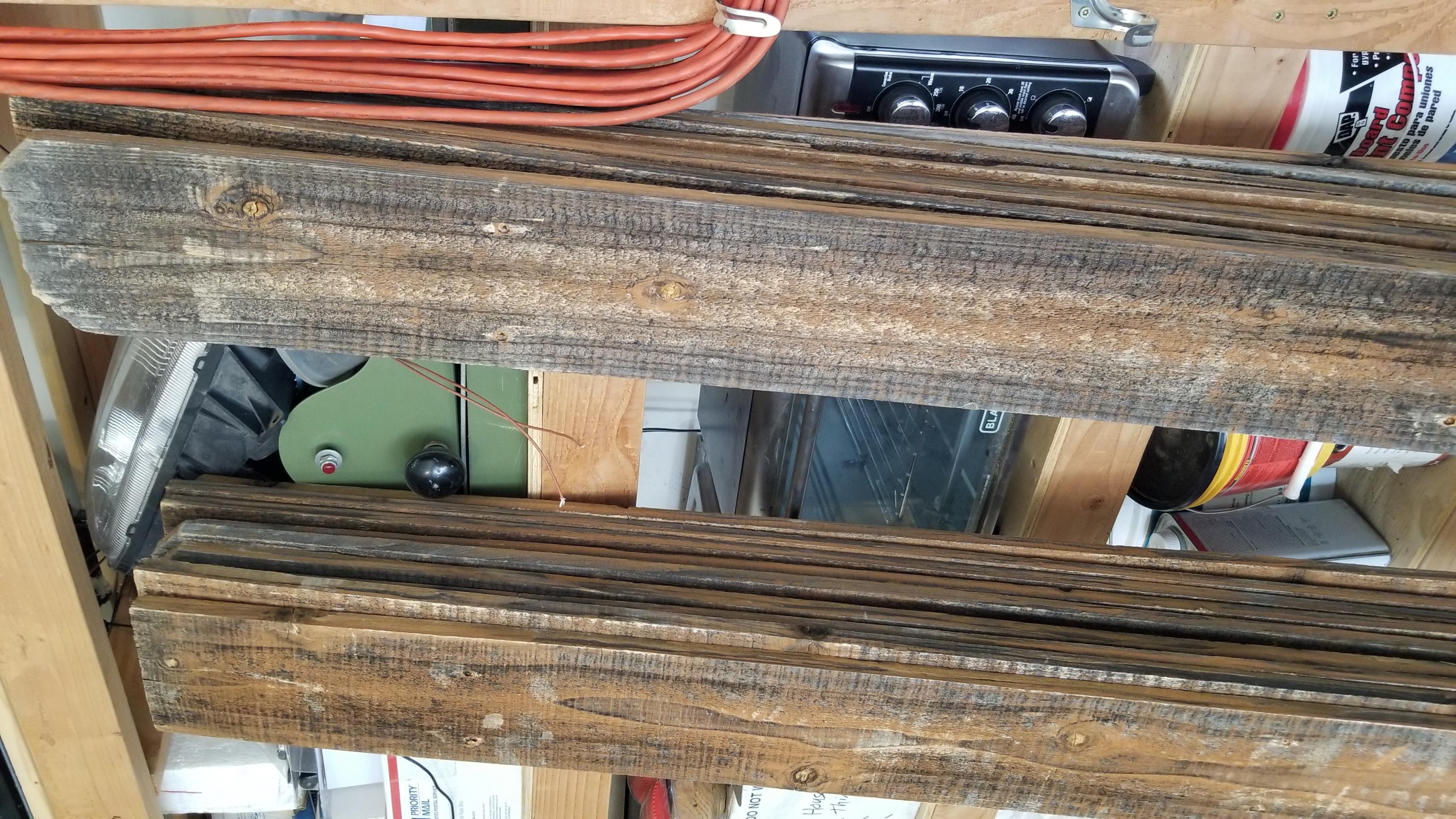

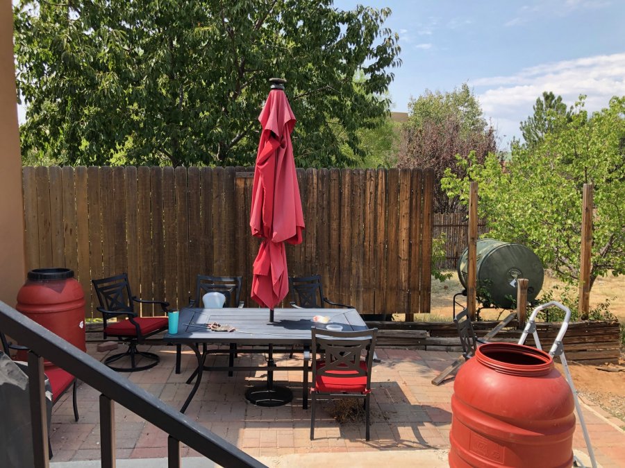

My daughter called last night to see if I wanted some wood. They wanted to take down 1 section of fence. Here is the blank spot where the fence was.
I'll be using the destressed looking cedar wood to build Depot Diffusers that will be doors for the 5x5 IKEA Record shelf behind my listening position.
Here is a pic of the wood. When I get it ripped down to size I'll have enough for 2 panels and those 2 panels will fit the shelf with an inch open in the middle between them.
The original plans call for .70" thick 1x3 and my wood is .50" thick so I have to makes some adjustments to get the prescribed profile.
