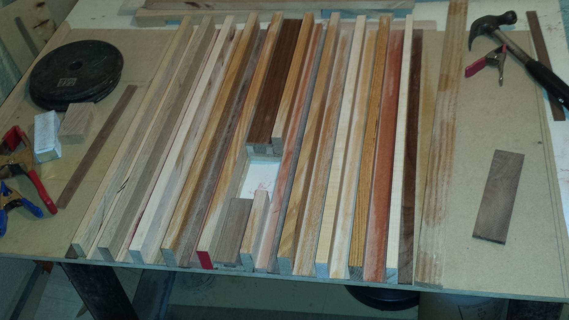

I've been working on some of my own. I'm fitting this one onto a .25" MDF backer that should be plenty rigid enough once all the hardwood pieces are glued and screwed in place. I'll include a pic if you never caught it in the neighboring posts.
The MDF I used had a slight curvature in it from sitting on its end. For some reason I thought that might possibly add to its effectiveness enabling it to catch more sound waves more easily being slightly up away from the wall. Not being sure on it I took it out.
Some of my wood pieces were already cut and only having so much at the time I picked a minimum and cut others to size based around those so I'd have enough. If the channels aren't enough I will make one or two to purpose front and center. Only next time I will use a less expensive material and copy the better sounding. The higher frequencies needed attention I thought this one might just do the trick. Speaking of trick thats a chord hideaway built into the center. A flat screen will sit above and two amplifiers underneath for once I come up with an easy solution to hiding some of the wire 😀

My most recent diffusors diffuse horizontally, but are otherwise concave curved to concentrate (but still time-diffuse) vertically. (See the article in Linear Audio 11). I use these to catch the back-wave that goes past the listening position to provide a good strong late diffuse arrival. They are much more effective than the non-curved versions (the arrival is about 9dB stronger).
The arrival is 9db strong ? Could i bother you to explain please :0)
9dB strongER. LATE arrival. Than from the noncurved diffuser.
It's because rather than letting the wavefront that reaches it continue to expand (toward floor and ceiling), it concentrates it toward the listener. Vertically that is -- horizontally it diffuses as usual. The idea is to get a strong enough late diffuse arrival for a "live end/dead end" effect without covering all the back walls with big diffusors.
Make sense?

Not really. Its like when first reflecton points are discussed, i get the reflection point, i just dont understand how it translates into Db's when plots are posted and people say, look its right there in the graph, you can see a reflection😕
Well, here is a graph of log-magnitude of room impulse response (very similar to the usual Time-Energy-Curve) measured using the original (non-curved) DepotDiffusor. The late arrival is at about 13msec on the plot:
Here is the same with the curved "CoFusor"
Notice how all the stuff just past 13msec is taller? There's no vertical scale on the graph, so you'll have to take my word on it that the stuff just after 13msec is about 9dB higher than in the first plot.

I cant thank you enough, but like the old saying "its me" . I feel just like i did in nineth grade algebra, lost. I will try to read and see if i can wrap my head around all this a little better :0/

The angles are arranged so that a reflection from the speaker off the center of each segment (angle of incidence equals angle of reflection!) is directed toward the listener. Ideally, you base the angles on distance from speaker to cofusor and distance from cofusor to listening position, and height of the segment. I made a spreadsheet to calculate the boards needed to direct each segment, though the ones I made were done more seat-of-the-pants with more crude calulations -- but still worked pretty well. Just the fact that you are turning a spreading wavefront into a converging wavefront gets you quite a lot!

So, a focussed diffuser (that's a bit of a contradiction!)
By decreasing the height of the diffused energy, this 'should' increase the horizontal diffusion and also improve the DI (directivity index (O'Toole, etc)
However, on second thoughts, by reducing the vertical diffusion, this also reduces the indirect reflections off the ceiling and as this is a major source of 'first reflected signal', it may actually be counter productive to 'focus' the vertical diffusion - it sound weird to talk about controlling the 'spread' of a diffuser
Anyway, it looks fairly simple to try - I'll add this to the list...
