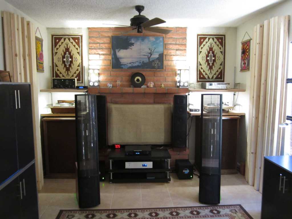

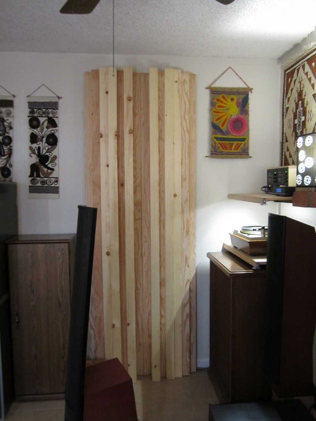

Hi everyone, I finally got around to building a set of these diffusers.
Thanks Bill for the detailed information on how to build them. I only made one alteration. I built each diffuser in halves. This was so I could move them around without a crane. Even still each half of a baffle weighs about 80 pounds or so. I fastened them together with lengths of 1 X 4 lumber on the rear with screws and fastened them to the walls with long screws into wall studs. I used “dry wall” screws to assemble the diffusers.
One thing for sure the effect on sound is not subtle. It may be more or less pronounced depending on the type of speakers and your room layout. I use Martin Logan Electrostatics which rely on both direct and reflected sound. My room has always been problematic. With one diffuser on each side wall just behind the speakers many of the issues went away. The focus and centering is much better without losing separation. I have lost a bit of the “air” the system had before, but IMO this has been a good trade off. My non-professional thought is that the diffusers effectively made the room seem about 50% wider. This is a great, not difficult or very costly project that can have a dramatic effect on the sound of your system. Thanks again Bill for posting it.

Glad they worked out for you Bruce.
I know that it wouldn't work out as your room is arranged, but I would have liked to hear how the diffusers might've worked if standing more behind (less to the side of) the panels. It seems to me that might be a good use for time diffusion like this, to work on the back wave from a dipole. If anyone tries that, please post!

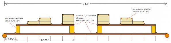

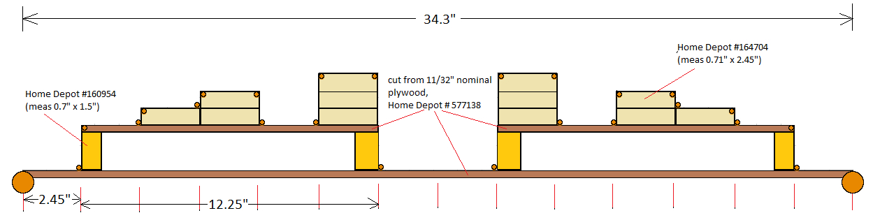

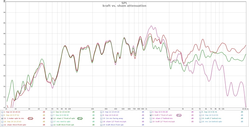

Here is a graphic of where to place the dowels to form the exact contour and the measurements I took on the paper plus the pillowcases that are holding my existing DIY bass trap pillows. The attenuation was measured with the cloth/paper very close to the speaker grill to block or absorb the sound and the reflectivity was measured by bouncing the sound off the cloth/paper at a shallow angle 30cm away:

Looks like an interesting approach (though more than a one day project at least for the first one!). Does the graph show reflectivity at 450Hz though? It looks like the energy goes right through on the transmission plot. Or am I not reading it right?

The plots are difficult to interpret. The info at Bob Gold's absorber measurements site indicates that kraft facing improves bass trapping up to about 500Hz and improves reflectivity down to about 500Hz but the data is approximate due to few measurements.
My plots are subject to the following caveats:
  • Directionality of the speaker begins at about 1000Hz so below that the speaker is omnidirectional.
  • There are reflections from various boundaries around the speaker including the concrete slab, awning, and fencing of the balcony I measured on.
  • Bass frequencies will bend around objects that are much smaller than a wavelength.
  • For the attenuation plot, sound will reflect off the paper and back to the baffle and back to the paper etc. causing combing undulations in the frequency response.
  • For the reflection plot, bass frequencies will radiate off the backside of the speaker all the way up to 1000Hz where it starts to become directional radiator (plus the port is in the back).
  • For the reflection plot, any reflections off the paper below 1000Hz will combine with the omnidirectional radiation off the backside of the speaker causing combing undulations.
The truth is that no accurate estimate of bandwidth of that paper can be made using my measurements. I only demonstrated that I should notice improvement in the treble using it, and that the diffuser should work fairly well using it too.
If you are considering this approach and concerned about lower frequencies, thicker paper should do the trick (though I would avoid multiple layers).
