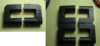

Before you invest too much time with these cores, you may want to check with Eva or one of the other power supply gurus in the power supply design forum. Flybacks operate differently than push-pull transformers and the core material may not be suitable for a car amplifier power supply.
supermico said:may work this core ??
those are tv flyback yokes, if they came from pc monitors, they are good for over 45khz...

supermico said:its possible to use a ferrite cores from TVflyback?? 2 cores to form a big E cores....
been there, done that.
using push pull with 6+6T pri running at about 40-45kHz, I was able to get about 400watts or so out of a pair of TV flyback cores.
the flyback transformers have plastic shims that add an airgap to the ferrite cores, REMOVE these and clean the mating surfaces well and epoxy them together. you now have a squarish 'toroid' then wind it as you would a toroid.
