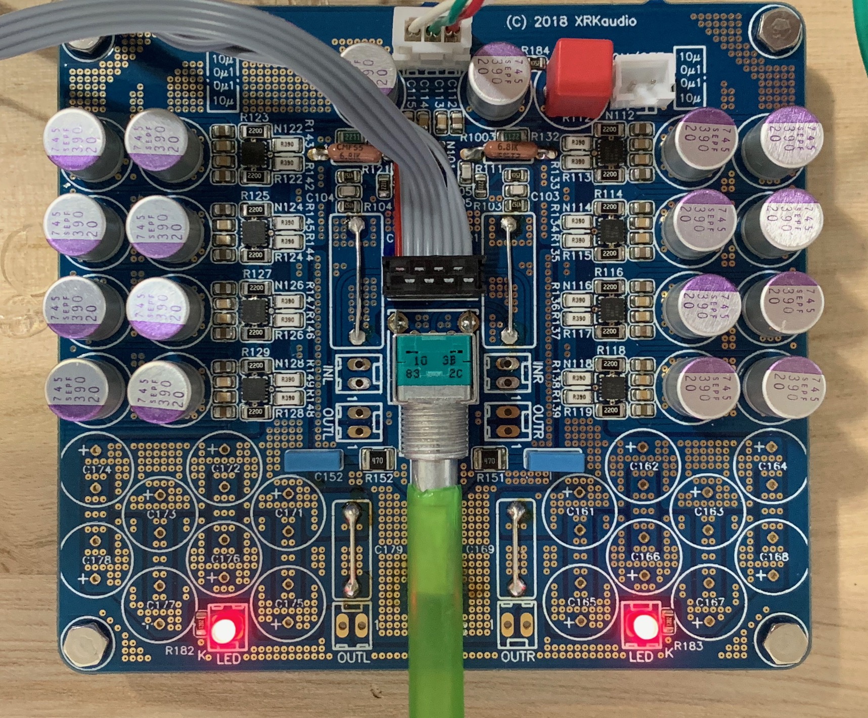

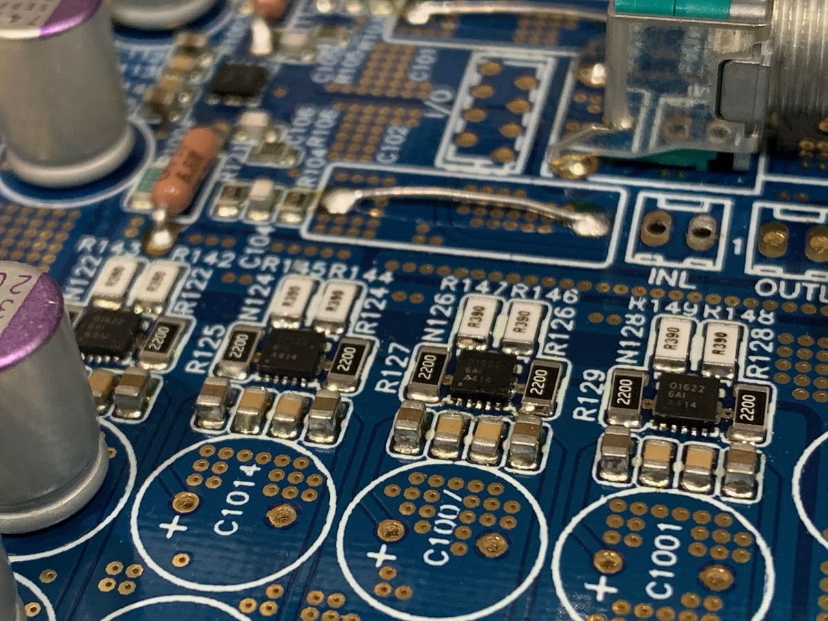

Regarding high power chip amps - one could parallel them as has been done by numerous people to scale up the power. I am not opposed to chipamsp or opamps in general of course, and they have their place. My latest project uses them:
I just scaled up 8x OPA1622 headphone amp chips for a headphone amp that doubles as a low power speaker amp. 150mA x 8 is 1.2A - not bad for four 3mm square VSON10 packages.

XKR, can you tell us about the that stuffed PCB?
The SMD placement and soldering appears to have been done by automation. If that is so, did you utilize some commercial service? If so, please share the pertinent details such as, vendor name, cost, min. quantity, etc. The challenge of hand placing and soldering finer pitch SMDs is limiting my DIY efforts. An cost effective hobbyist solution to that problem would be a real boon

Hahah, that was assembled by the “xrk971 model 2000” pick and place machine and soldering was accomplished with a $10 dorm room hot plate and skillet from the bottom and a $50 hot air pencil from the top. I use Pb-Sn solder paste (MG 63-37, I think) applied with a syringe and hypo needle. Parts placed with good pair of Swiss Technitool tweezers and vision provided with flip up magnifying goggles. Those are 1210 resistors and 0805 caps - they are child’s play compared to 0402. The VSON10 packages look hard (but not really) have an underbelly pad and hidden pins. The solder surface tension self aligns them. Same with the rest of the parts. Trick is to apply just the right amount of paste (sparingly). Heat the skillet at medium to low heat and monitor PCB temp with IR thermometer. When it hits 130C and stabilizes, use 300C hot air pencil from above to liquify just the components of interest. Keep liquidus for at least 10 seconds and then go to next section. This way, parts only experience long term 120C to 150C and short term just long enough to melt and make a nice joint.
761679d1560031370-cheap-chips-opa1688-low-thd-muscle-amp-muscle-amp-opa1622-build-8-parallel-closeup-05-jpg
On complex jobs with lots of parts, I use a digitally controlled solder paste dispenser (i-Extruder) to lay down repeatable perfect size blobs even on 0402 and 0603 parts and skinny little 0.3mm pitch pins on a quad flat pack DSP chip. Your hand would cramp if you had to use a syringe on more than 30 parts.
It takes some practice of course - watch YouTube videos from SparkFun on SMT soldering and you can learn a lot. There is a lot of Pb-free solder paste out there - I prefer lead for its better flow and durability and lack of Sn-whiskers. Copper braid and thin free flowing liquid flux with a regular soldering iron chisel tip is your friend for removing excess or cleaning up solder bridges.
In the end, it’s much faster than TH soldering as everything is on one side and there is no clipping of leads or bending of leads needed.
Those tweezers seem expensive - but very crucial as they are your fingertip extensions and cheap ones just don’t work. I have had mine for 20 years. You have links above to just about everything you need to do this.
I have been eyeing a binocular stereo microscope workstation for some time now. That would be the next step and enable 0402 assembly much easier.
Essentials to get started: tweezers, magnifier goggles, solder paste, hot plate. Add hot air pencil later. Copper braid and flux might be handy and useful for TH soldering as well.
Hope that helps. Maybe another Howto thread is in order?

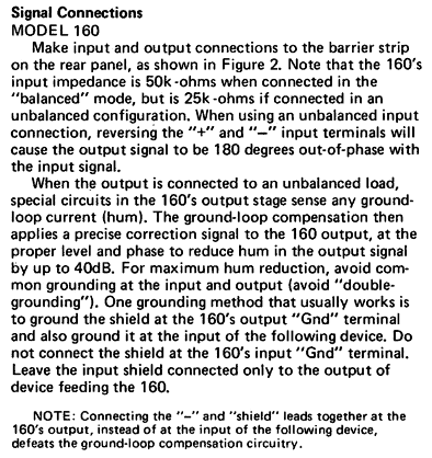

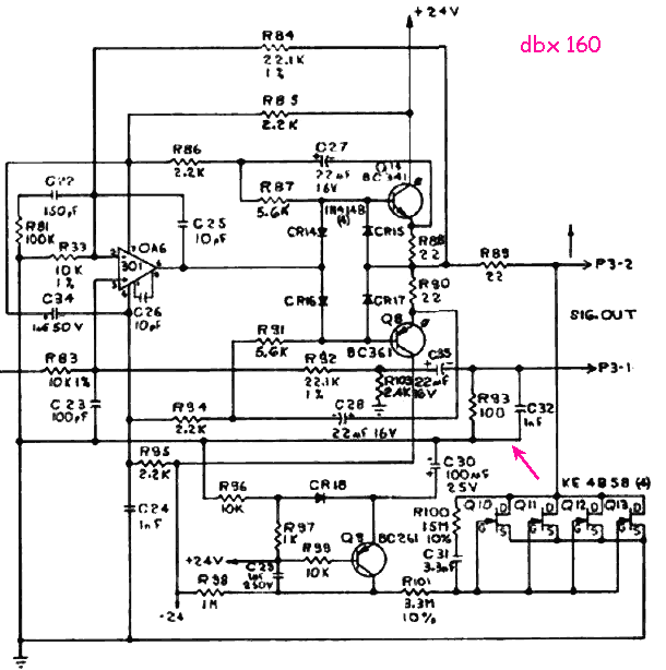

I would be interested to know which limiter....
dBx has made WAY too many limiters.
Memory said "160" but that is mono. The 165 is the stereo, has the right knobs/meters, but the plan I found is simple single-ended.
DBX 165 - Manual - Over Easy Compressor / Limiter - HiFi Engine
Mine had a later manual (pamphlet instead of binder). This would be early-mid 1980s.
They boxed the same stuff several ways, and probably had several revisions of each model. I found the impedance-balanced plan in the 160:
DBX 161 - Manual - Single Channel Compressor / Limiter - HiFi Engine (manual covers 160 and 161)
Note also not simple impedance balanced, but a "hum sense" resistor and differential NFB. (as in post #37 here) So not the same thing. Sorry for the false trail.
