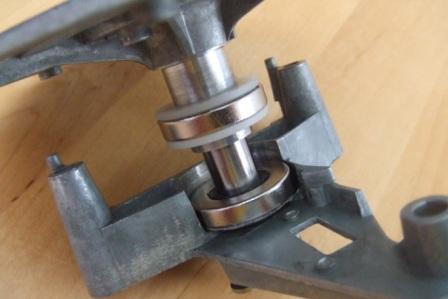

I designed and built the particular magnetic bearing that sq225917 has built a version of, and describes. We know each other well and I hope he agrees with this.
The bearing I use has one large ring element and another element consisting of a circular, ring, array of cylinder magnets. I built a number of prototypes before arriving at my final realisation (five prototypes).
I used a CNC Router to produce the supporting structure as geometric accuracy is extremely important for this type of design, Initally I used acrylic but my final design is from HIPS.
Below are a few pictures of the first prototype that I built. Sorry, but I do not have any pics of the final design. In the photographs the bearing consists of two circular arrays of cylinder magnets but (as said before) the final design replaced the lower array with a single ring magnet. In addition, the increased magnetic field of the later ring magnet allowed me to use much fewer cylinder magnets for the top most array. The construction methods are largely similar between prototypes though.

Ynwoan,
Thank you. Now I understand.
From the picture in http://www.vinylengine.com/phpBB2/a...php?pic_id=6163 I got the impression that you managed to find a method which didn't involve CNC routing. Unfortunately that is not the case ...
I'm afraid I have to be clever al by myself.

Hi Marco,
I'm glad if I helped a little. I'm afraid I'm not sure which pic you are referring to as the link you have provided does not go to any specific picture (this may be because I have deleted many of my old posts from vinylengine).
In actual fact the ring magnet I use essentially has a CNC machined spacer to locate it concentrically with regard to the main bearing and this could be made by hand (carefully). In addition, it is possible to recreate much of my work without access to CNC equipment (it's just more difficult). Accuracy is important though - bear that in mind and have fun.

I tried neodymium ring magnets with outer diameter 50 mm, inner diameter 30 mm, height 5 mm from a local supplier:
www.euromagnet.hu
Here are some data of the N35 material that I used:
http://www.euromagnet.hu/Neodimium s tbl.htm
But two opposite ring magnets like this proved to be way too strong for elevating the 3 kg mass of the Thorens TD160S platter. The bottom magnet self-sticked to the steel subplatter. I will follow YNWOANs method and mount some small disc magnets on a steel plate attached to the bottom of the inner platter. I suppose the secret is to have the opposing magnets as close to each other as possible, in order to reduce stray field that may disturb the pickup. Hopefully the steel magnet holder disc will serve also as a magnetic shield, and I can play with the number of the small magnets.

Ynwoan has a point with the possibility to regulate the compression. If you use two ringmagnets instead of one ringmagnet and several smaller cylinder magnets, to adjust the compression, you have experiment with:
1 The size and force type of ringmagnets. In my experience with most magnets there is some information about the ‘maximum weight the magnet can lift’. Take 2/3 of this weight and this is your maximum platter weight. This is what you have to experience yourself!
2 Adjust the weight of the platter by putting more weight on. I did this with sheets of flexible self sticking lead/rubber anti-vibration plates.
I used two tiny Neodymium ringmagnets R25mm x 15mm x 0,5mm With a maximum weight lift for one magnet 4,95kg. The platter of my Garrard weights about 2,3 kg. With this platter there was a gap of 2mm between the magnets (could easily be changed between 1,5-3mm depending on the weight of the platter). With my experience the compression is not that critical to get a descend floating bearing.
Above is only my short experience with my unsuccessful attempt. But I really think it is possible to make a nice TT bearing with just two cheap ringmagnets. There is just almost nothing to find about this subject magnetic TT bearings for DIY. So boys and girls experiment and share us your success or in my case failure.

Triumph, there seems to be a lot of friction in your main bearing (from that video any way).
Just for clarification, my reference to adjusting the strength of the magnetic field was not so that it could be floated appropriately, it was so that the compliancy of the circuit could be adjusted. This is important as the bearing (if fully floated) effectively becomes a filter - the frequency at which it operates is set by how compliant the magnetic field is.
Not only there is friction in my video but also wobbling. This is caused by the gliding bearing and the minimum weight of the subplatter.
A magnetic bearing is not without resistance! The construction than is shown has actually more resistance than my present inverted bearing. The difference is a magnetic bearing is more silent. There is less mechanical noise, depending of the quality and construction of the sliding bearing. For me that is less important, I use an idler drive that has no real black background.

Hmm...properly applied, there should be less friction than in a conventional bearing - not zero, but less. Certainly, this is what I found. Clearly the bearing liners still create a significant level of friction but the point contact is relieved.
Triumph, I think the reason that your friction levels are higher is because the magnets are not truly perpendicular to the shafts they are mounted to and the two opposing surfaces of the magnets are not absolutely parallel. As a result, when the platter turns the uneven application of magnetic repulsion causes uneven lateral forces to be applied to the main bearing shaft (effectively trying to twist it diagonally in the bearing journal) and this causes the bearing shaft to be pressed with increased pressure against the inner bore of the bearing - so increasing friction. However, thinking about it, it is quite possible that I am misinterpreting the specific construction of your bearing.
