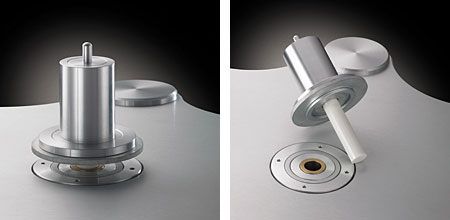

Its usual to have a one piece bearing journal with the bearing spindle being mated to the subplatter. Your magnets act between subplatter and chassis, not in between halves of the bearing journal.
Maglev and inverted bearings similarly isn't wiinningly easy.
still don't get it by halves of the bearing journal.
I do not use subplatter, just chasis and platter.
please draw me a skecth or google pic sample what you meant, which is better design before I made a big mistake. 🙂
like this pic
