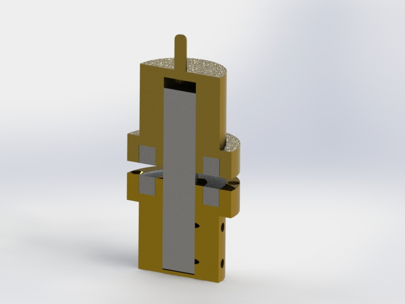

this is my sketch of the spindle with magnetic rings,
will this works ???
diameter of the stainless steel bearing shaft is 20mm, 100mm length.
try to check ceramic shaft is way to expensive.
the yellow bushing is Bronze.
any adivce ? ... please ...
will this works ???

Does Tungsten is better than stainless for the spindle better material??
I know ceramic is the best but very expensive, let me know if you know who sell ceramic shaft/rod.
