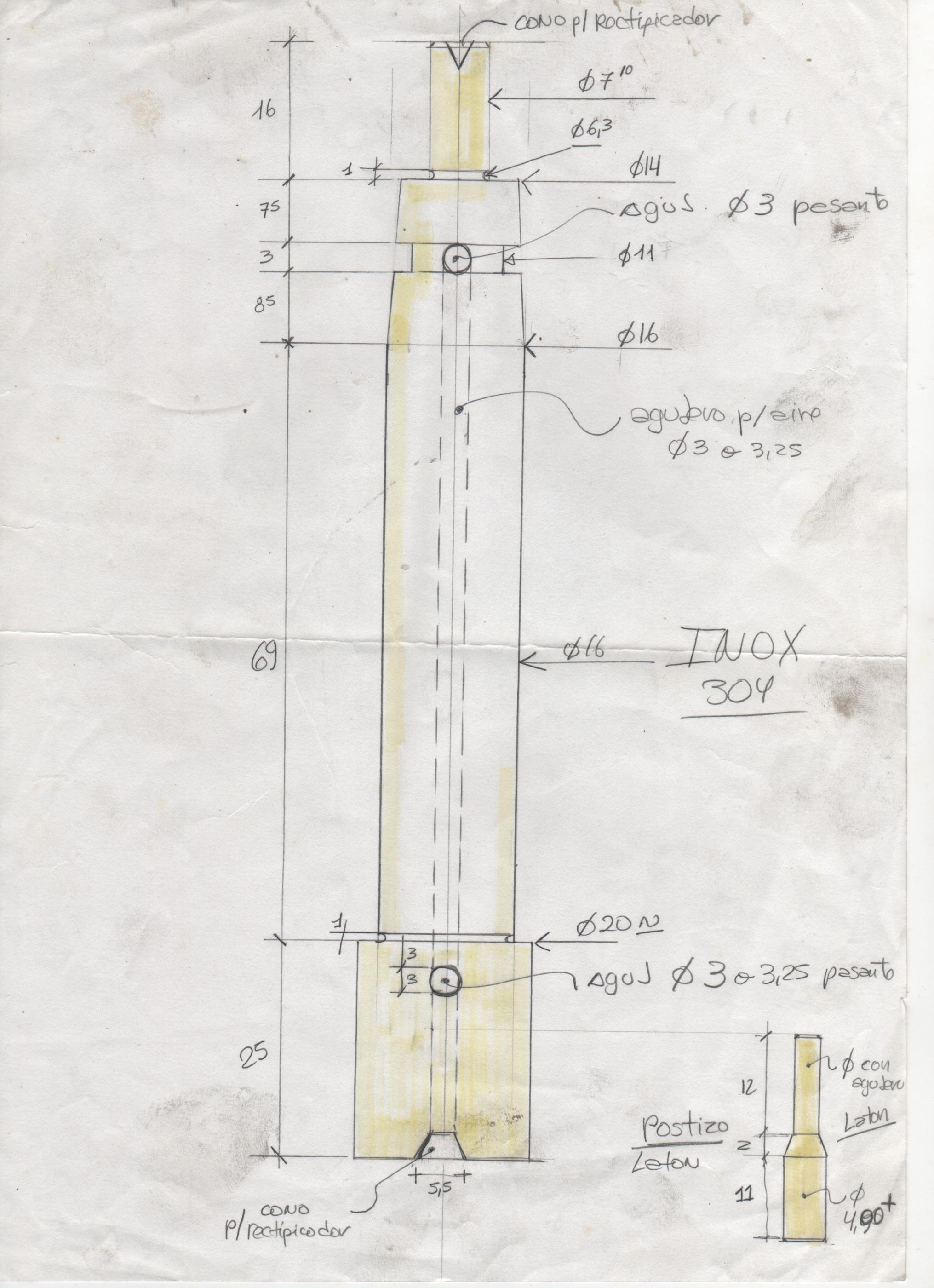

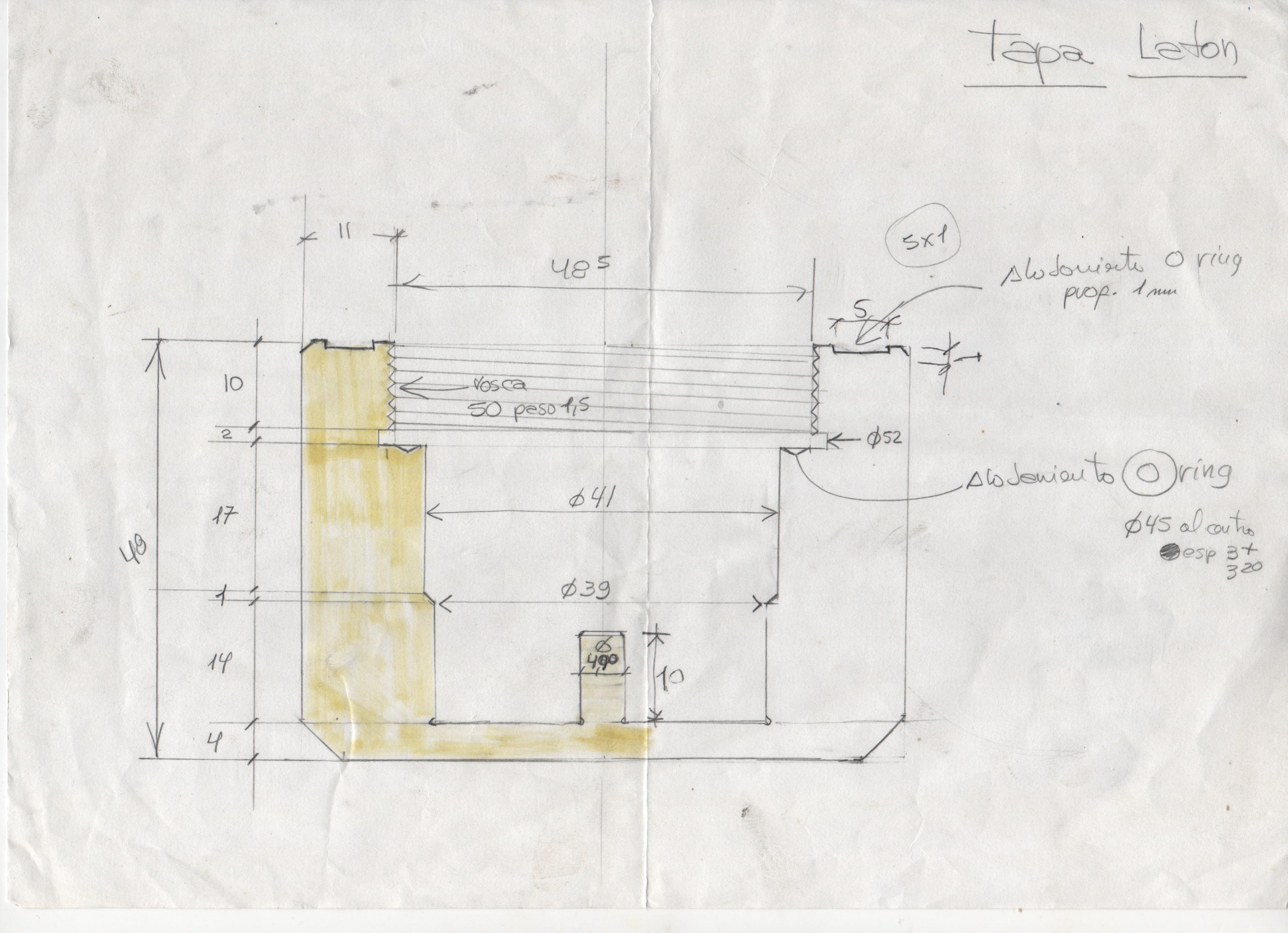

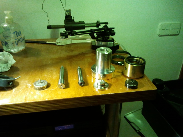

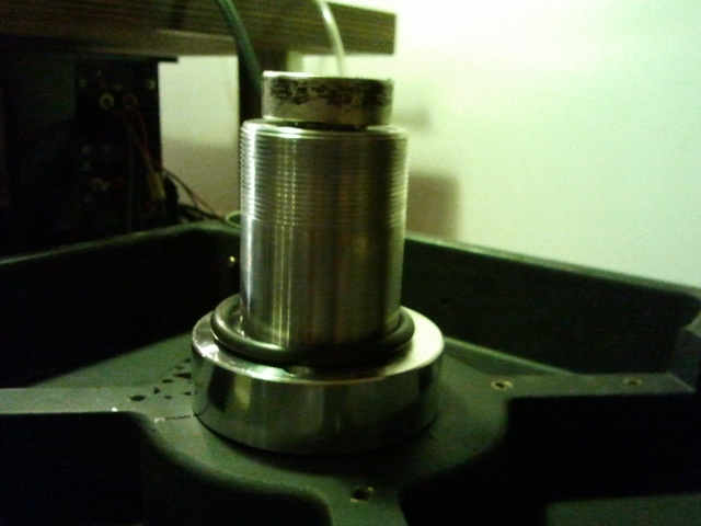

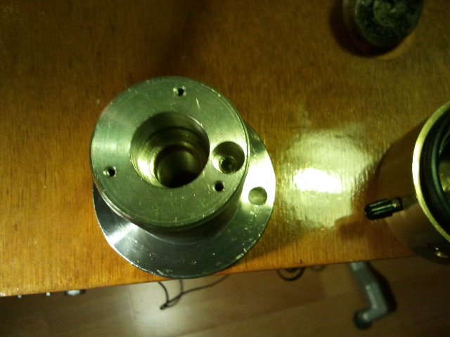

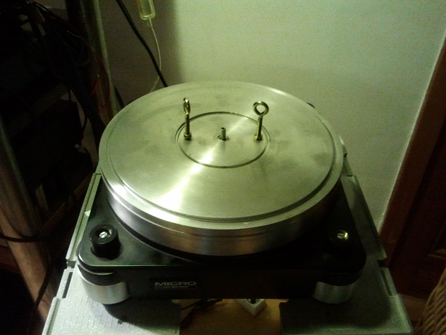

This are more details with the plans.
You can see the coup attached to the bearing, the axle inside with the upper magnet, and finally the turntable working. The original platter weight 3Kg, I make a form in plaster and with this I make a mold or external copy in the same material I melt 30kg of lead and I glue to the platter bell. After that I machined in a turn machine and balanced it. The weight rise until 26Kg, to much. Recently I remachined that until a weight of 16kg and balanced again.
I polish the axle and not any rumble at all. I conserve yet the vacuum original properties from the original platter (the axle is perforated) and I add the property aircushion with magnetic suspension.

Hi Yildiray: Of course is possible to put magnetic cushion in every turntable. I didn't know how much weight the platter of the yours. The rule number one is put away the magnetic field from the cartridge. I recently made this in a Micro Seiki RX1500 VF, but I made a special non magnetic steel axle that transfer this fields from the button to up. In the base of the axle I installed a neodymium magnet and another one in a cup of non magnetic but firmly in the base of the turntable. I could rise the weight of the platter from the original 3Kg to 25kg but after rebalanced it the final weight was 19Kg. The neodymium cylinders have 5cm of diameter for two of tall and the gap between the magnets is nearly 0,2mm. If you have a patient lathe operator that is your friend every operation is possible. Best Regards.

Hi Yildiray: I were watching the Perpetumm Ebner 2020, this is a record changer but if you prolongate the axle with a non magnetic material making a new support for the magnets is possible. Maybe this choice is a waste of technology because the tolerances of this device not justify the investment. The most important results of magnetic suspension is the noise. I the case of a heavy platter imagine, going to suspend in one sphere point and the molecules of the contact points can produce more friction and this gonna traduce in rumble noise. Maybe in your turntable with idle wheel adding to the unsynchronized motor that produce much more noise and rumble that the noise you pretend in avoid with the magnetic suspension. There are many good turntables without magnetic cushion that have unmeasurable noise.

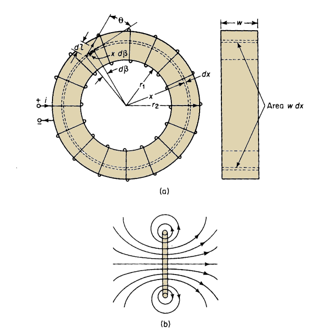

Please explain how the magnetic fields interact in this model.
