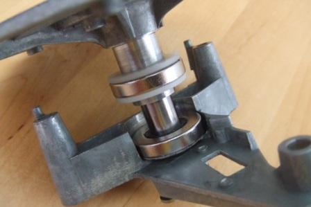

My experimenting with two neodymium ring magnets (see picture below) failed because of unbalance of the platter, not because off axial forces but of tangential forces of the magnets. Even after honing the sliding bearing to a minimum tolerance the platter has a “tide” of 3 mm.
It must be possible though, see:

Judging from your thumbnail image, it looks as if the magnets are way too far apart and the platter is also extended too far as well. I can see how you would obtain poor results if that is an accurate picture of what is going on. My magnetic bearing only deviates 0.1mm and that is most likely due to the acrylic platter's imperfection.

loaded with the platter ynoans magnet only floats the platter by a couple of mm. he uses a LINN bearing so the spindle is sleeved all the way up, hence no increase in lateral play.
this solution doesn't work so well with garrard and lenco style bearing as the spindle is quite short, you would need thin magnets of greater circumference so that they sat outside of the platter stub as shown in your image.
The picture shows the distance without the weight of the platter. With the platter it is also only a couple of mm.
In a later version a made 3 adjusting screws for leveling the bottom magnet and also a adjusting mechanism for the top magnet but still it couldn’t prevent wobbling of the platter.
