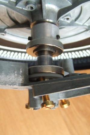

Picture of my mk2 version. Notice the three adjusting screws at the bottom and the alu ring with three screws on the top.
But still it fails. I think because of the great push and pull forces, short type bearing etc.

I doubt your present design is ever going to work. If you can tilt the magnets or even move them laterally on the shaft using those brass screws, the ability to control parallelism between the magnets as the platter rotates is gone. You have to fix the magnets in position permantly and concentric with the axis of rotation. It is really simple if you think about it. Good luck.
'Triumph', I'm afraid that I completely agree with the comments made by 'Vinyl-addict'.
The problem is not because of the "great push and pull forces" as such, or because of the "short type bearing". The problem exists because the magnets are not truly parallel to each other and/or are not perpendicular to the bearing shaft. Your adjustment solution is cunning but is difficult (if not imposable) to adjust to a significantly fine degree. I'm afraid the problem has to be engineered out at a more fundamental level.

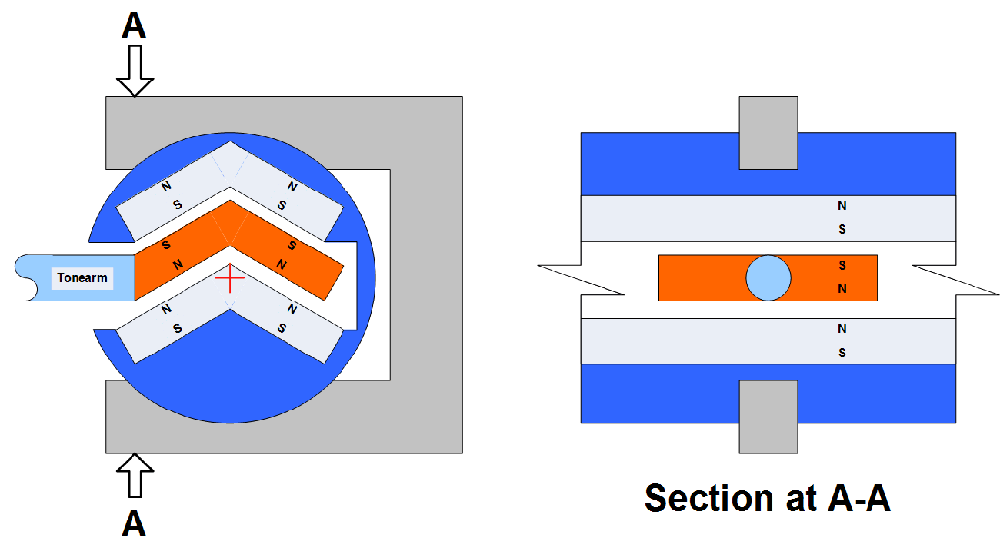

Could something like the drawing work? I'm envisioning the tonearm attached to a shortish angle-iron shaped magnetic structure which is trapped between two longer angle iron shped magnetic structures of opposing polarity. The two longer structures are embedded in a cylinder which is free to rotate in the vertical plane, allowing for warps and lifting the tonearm - or perhaps the tonearm could be hinged to its magnetic structure....
Seems that whichever axis the trapped structure tried to move along, it would be opposed by the outer structures - but perhaps this merely proves that I'm bad at thought experiments.

No, definitely won't work.
There is nothing to constrain the movement of the "floating" element except the magnets. Earnshaw's theorem says that they cannot achieve stable equilibrium so the system will move until some mechanical constraint is reached.
I would guess that the inner angle will tilt relative to the outer angle until the two lodge against each other but that's only a guess.
The problem briefly stated is this: a turntable platter only requires one degree of freedom, that of rotation around the Z axis. the sleeve bearing serves to constrain 4 of the other degrees (X and Y rotation and X and Y translation), leaving the magnetic bearing to constrain the last (Z translation). Since the disequilibrium forces from instability in the Z translation constraint will show up as X and Y translation and X and Y rotation (eg the platter will attempt to move sideways or rock) the sleeve bearing constrains them (adequately if it has really good tolerances, inadequately if not).
A tonearm however requires at least two degrees of freedom - If we assign the tracking direction as the X axis it requires translational freedom along this axis and rotational freedom about it. If a magnetic bearing is designed to supply the constraints on Z and Y translation then the instabilities again will show up in X translation and X rotation which are by definition not constrained. You therefore need a mechanical constraint which rather defeats the point.
