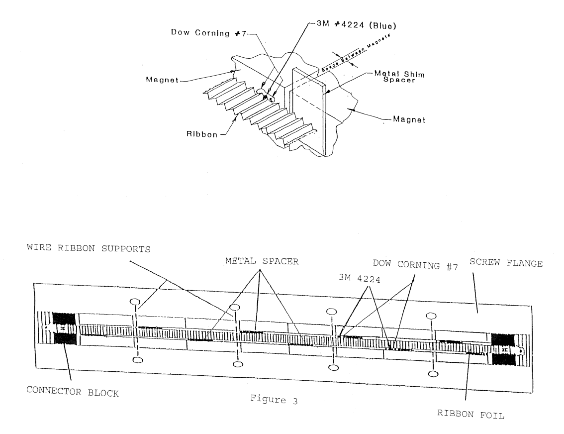

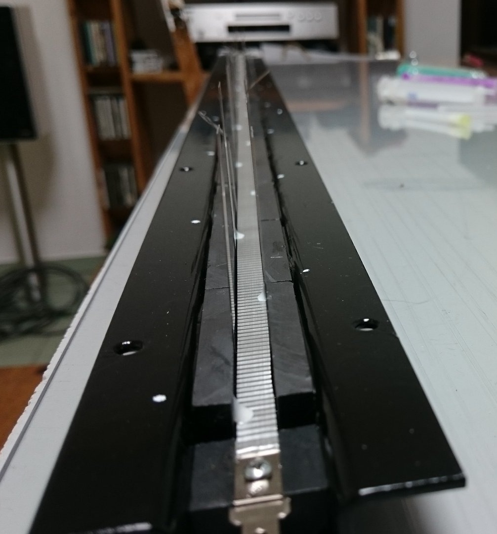

Magnepan pure ribbon is very long and must be supported every 10-30 cm. Anyone verified if that is true?
Yes it is visible on picture. Very strange why only one side. Not logical. Also looking like ribbon is not in the middle of magnet but at the corner. Whats are vertical strips?
The first generation had an extremely thin foil, about 2.5 µm. It was 1/4" wide and a resistance of 3 Ohm. It easily brook and was replaced by a thicker one with a resistance of 2 Ohm, about 4 µm thick. You had to add a resistor of 1 Ohm. The later generation of the ribbon is narrower and the magnets are thicker. Also 3 Ohm.
