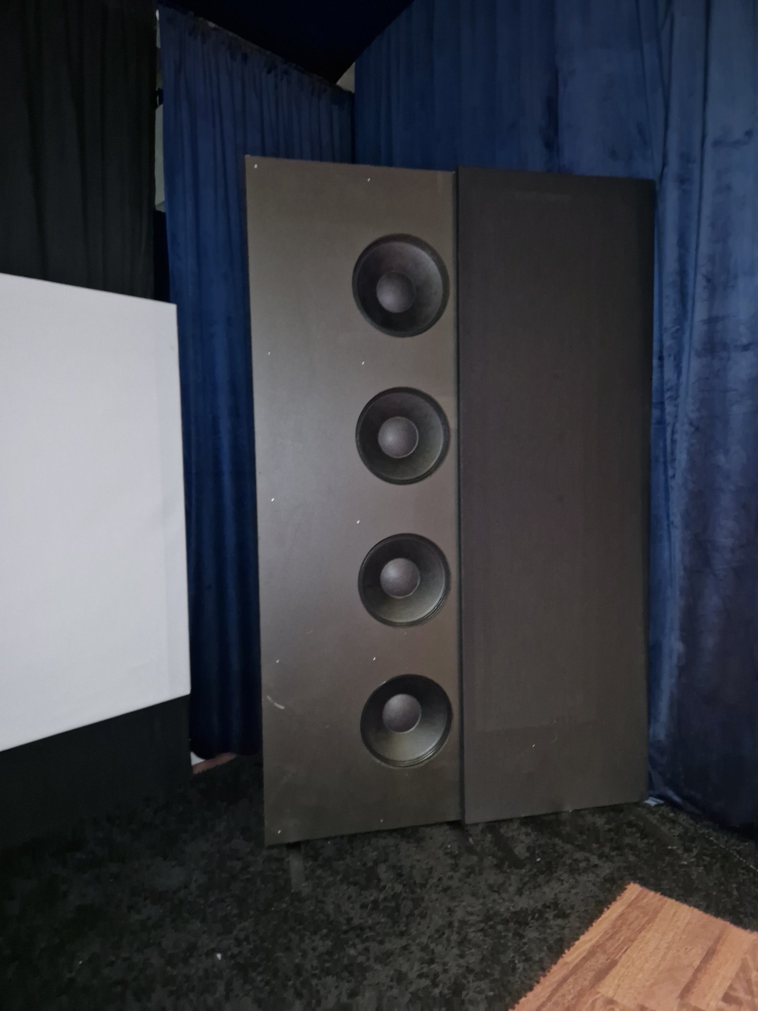

I'm also working on a mid-bass dipole system for my Magnepan 3.7's using four 12" drivers to replace the two Magnepan 1.6's. More on this later, or perhaps in an other thread. Let's see.

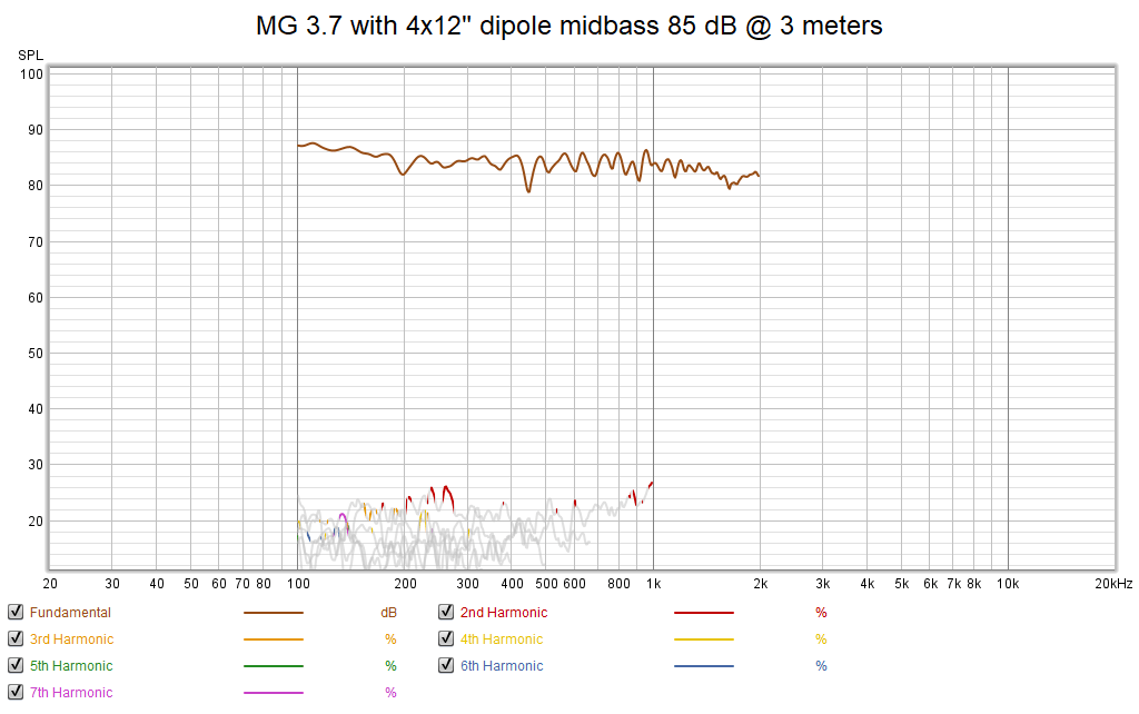

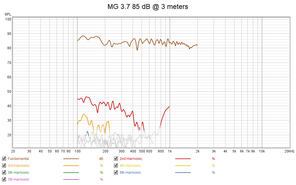

New mid bass system is in place! Crossover points are 100 and 400 Hz. The difference in max SPL and distortion compared to the Magnepan 3.7 is massive. I will present some measurements later on. Above 400 Hz however, the Magnepan is simply superb.
With the given baffle width, the Qts of the Eminence Delta 12B drivers and the placement within the room, it’s not much to gain below 100 Hz. I initially wanted to cross over at 80 Hz, but it requires too much EQ boost.

Wow.... so, by themselves, the Maggies are putting quite a bit of distortion under 400Hz. Hmm.. impressive.

Yes, under 400 Hz things go bad. And it’s far worse further down below 100 Hz.
Correct - tweeters on the outside, and 12” woofers next to the bass panel.

400 Hz is where the frequency response of the bass panel starts to drop off at the low end. It’s not very dependant on the distance from the panel.

The 1.7 is actually better below 400 Hz than the larger 3.7… but it does not have the 3.7’s fabulous true ribbon tweeter.

I wonder, if I could build a woofer panel like yours, but smaller. Say, two 10" drivers, about 16 inches wide. Keep the Maggies untouched but run a high pass filter on them. Run the woofers on a low pass filter.. and cross over at around 200 Hz. Hmmm... I wonder what my wife would think about that. So far, it's been so good in our living room.

A smaller woofer panel may of course work.... 4x12" is a bit overkill.

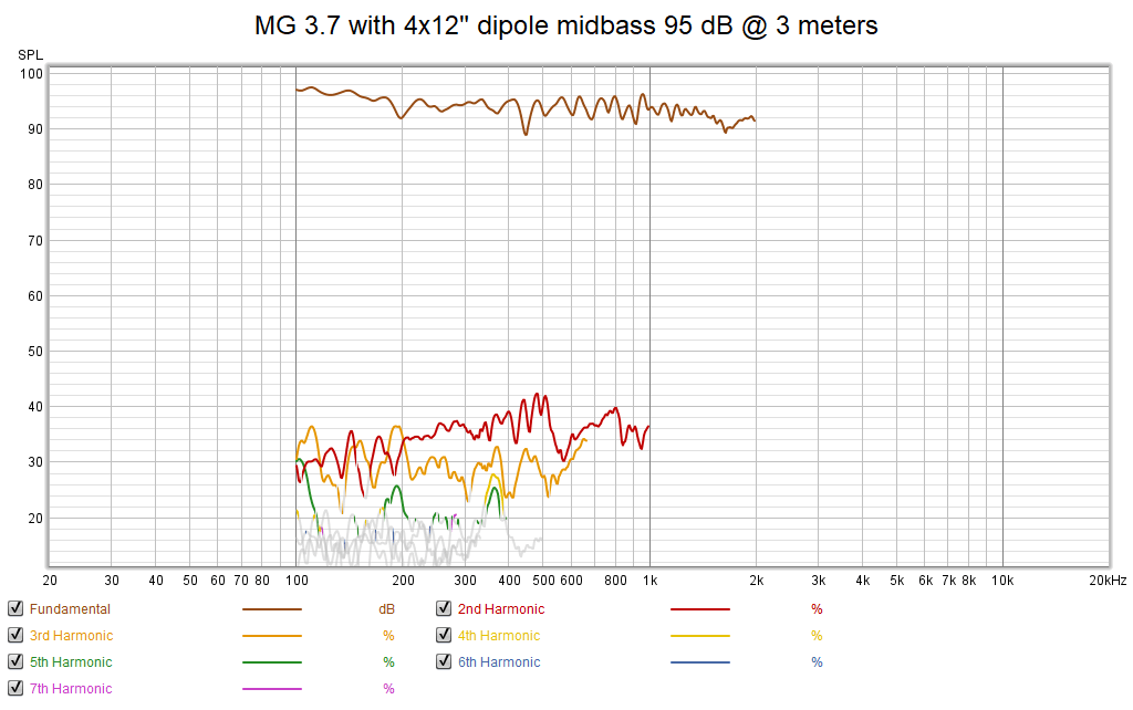

I’ve moved the crossover point between the 12” wooofers and Maggie bass panel to 450 Hz. Distortion now stays below -60 dB ( 0.1% ) with 95 dB @ 3 meters. That is equivalent to ~105 dB @ 1 meter. At my normal listening level ( 70 -75 dB); distortion is actually lower than the noise floor in my room and/or my hearing threshold. Can’t complain too much about that 🙂
