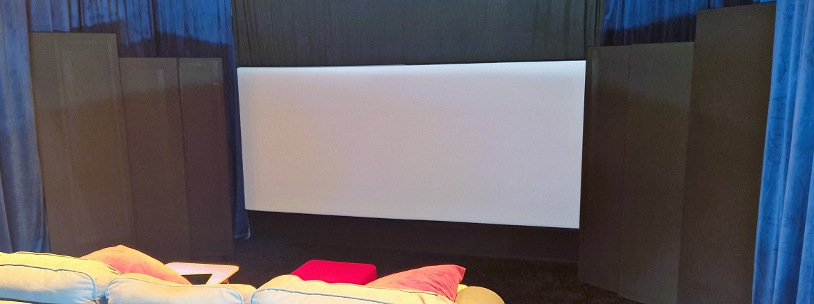

I've experimented with an extra bass panel on my L/R front speakers, which are 3.7's. This was an effort to reduce the distortion I showed in post #23, and also to increase the efficiency and max SPL. I simply put an 1.6 next to the 3.7, and used the 1.6's bass panel, driven from its own amp and DSP channel.
Here's a pic showing the setup in my room. Measurements will follow !

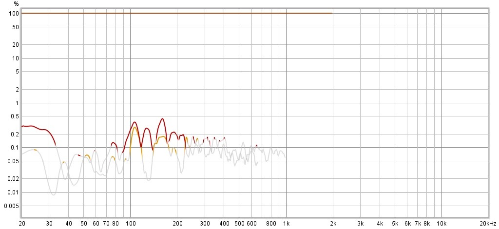

Distortion is lower than it used to be. This is 85 dB @ 3 meters. I am very happy with this result 🙂

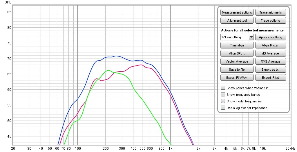

Here's how the two woofer panels measure summed, and individually. 1/3 oct smoothing for clarity...
Red is the MG3.7, green the 1.6 and blue the summed response with XO points at 120 and 800 Hz.
What are you doing below 120Hz? What sort of response would you get with letting the bass panels play without the 120Hz crossover?
The two panels combined go flat to 35 Hz. The distortion however goes through the roof below 100 Hz.

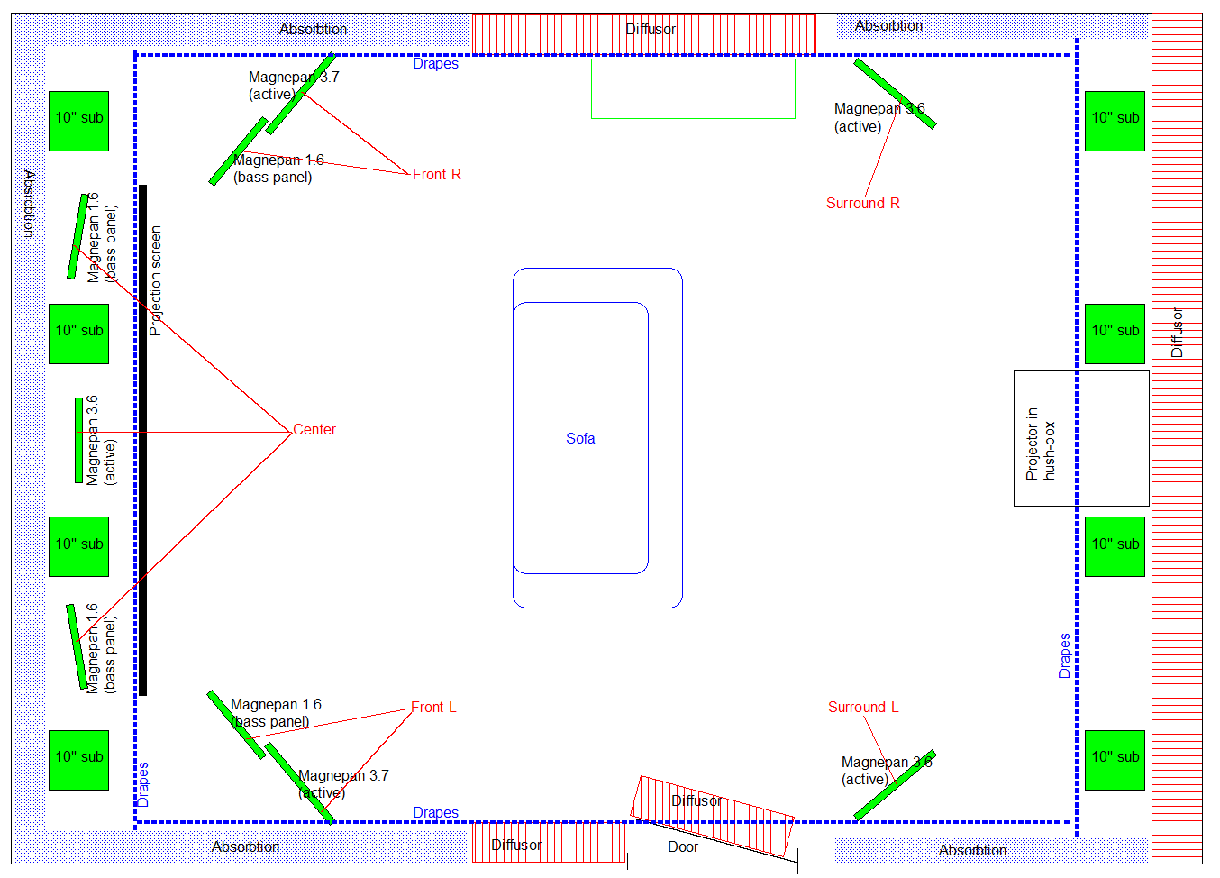

I don't get your set up... the point of Maggies is to set them up AWAY from the back wall.... done that way, they don't need no surround... maybe just a couple of little, tiny, iddy bitty Mini Maggies out back...
Well … how do you play back music recorded in more than two channels, or movie soundtracks with only two speakers ?

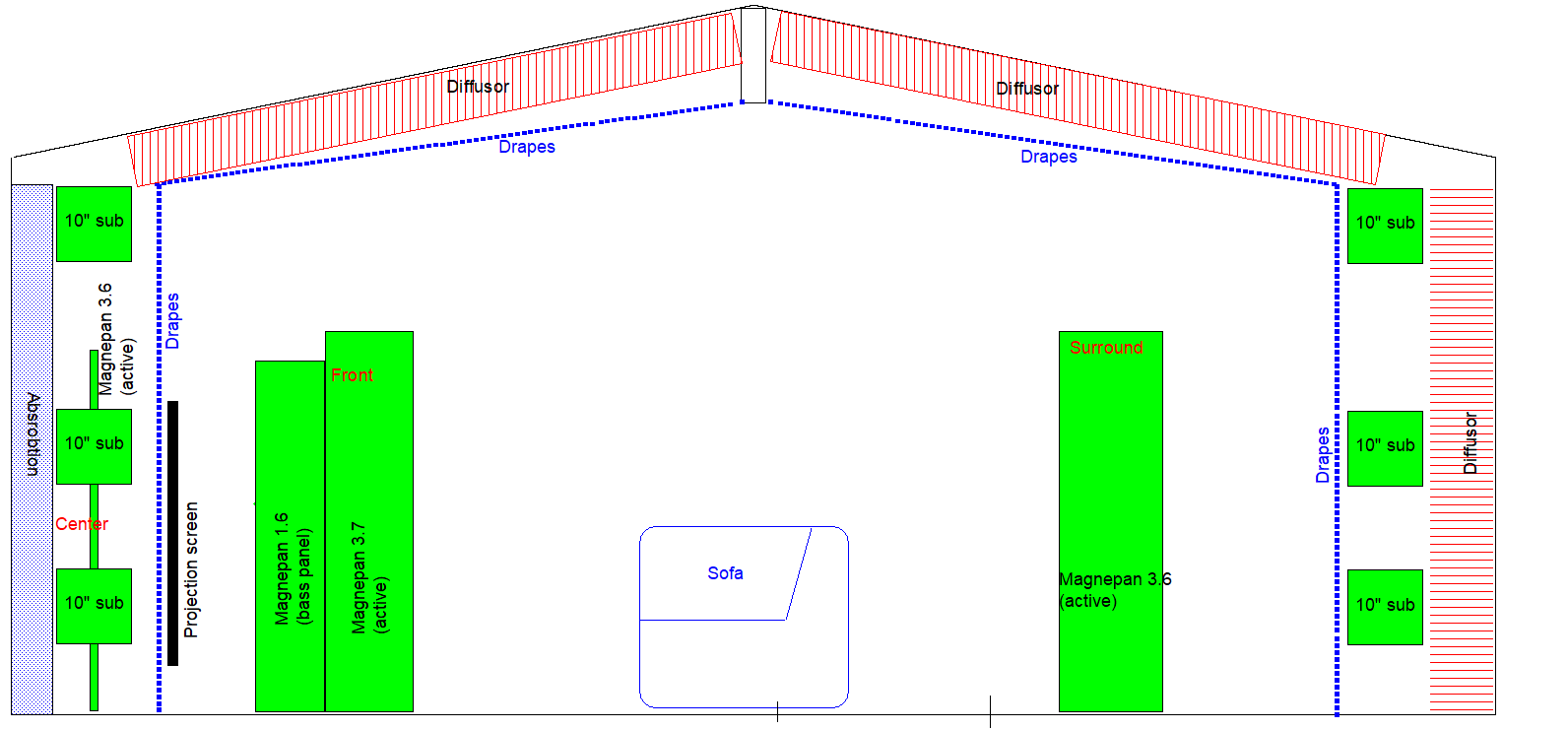

I will draw a room layout to make this a bit less confusing.
My surround setup is not a classic 5.1 since the surrounds are placed at a greater angle from the listening position. It's more like the setup recommended for Quad in the 70's. I think it works pretty well, especially on good recordings of classical music where the room acoustics get bigger with this kind of layout. I also have old Quad stuff that has been released on SACD. Some quite awful, but there are some really good ones as well, like Machine Head by Deep Purple, and Billy Cobham's Spectrum. I also have the Genesis boxed set, as well as a lot of the old Elton John, Yes, Beatles, Doors and other 70's stuff remixed for surround. Most of them sound really good, far better than the original stereo mixes I think.

The first thing I did was to expand the front channels with an extra Magnepan 1.6 as bass panel, so now there are two 1.6's next to each front speaker. That goes for the center as well (hidden behind the projection screen). The additional bass panel makes it possible to cross over at 100 Hz without any increased distortion, and the max SPL goes up a little. The system can give me a real kick-in-the-chest kinda feel if I crank it up to 11 !

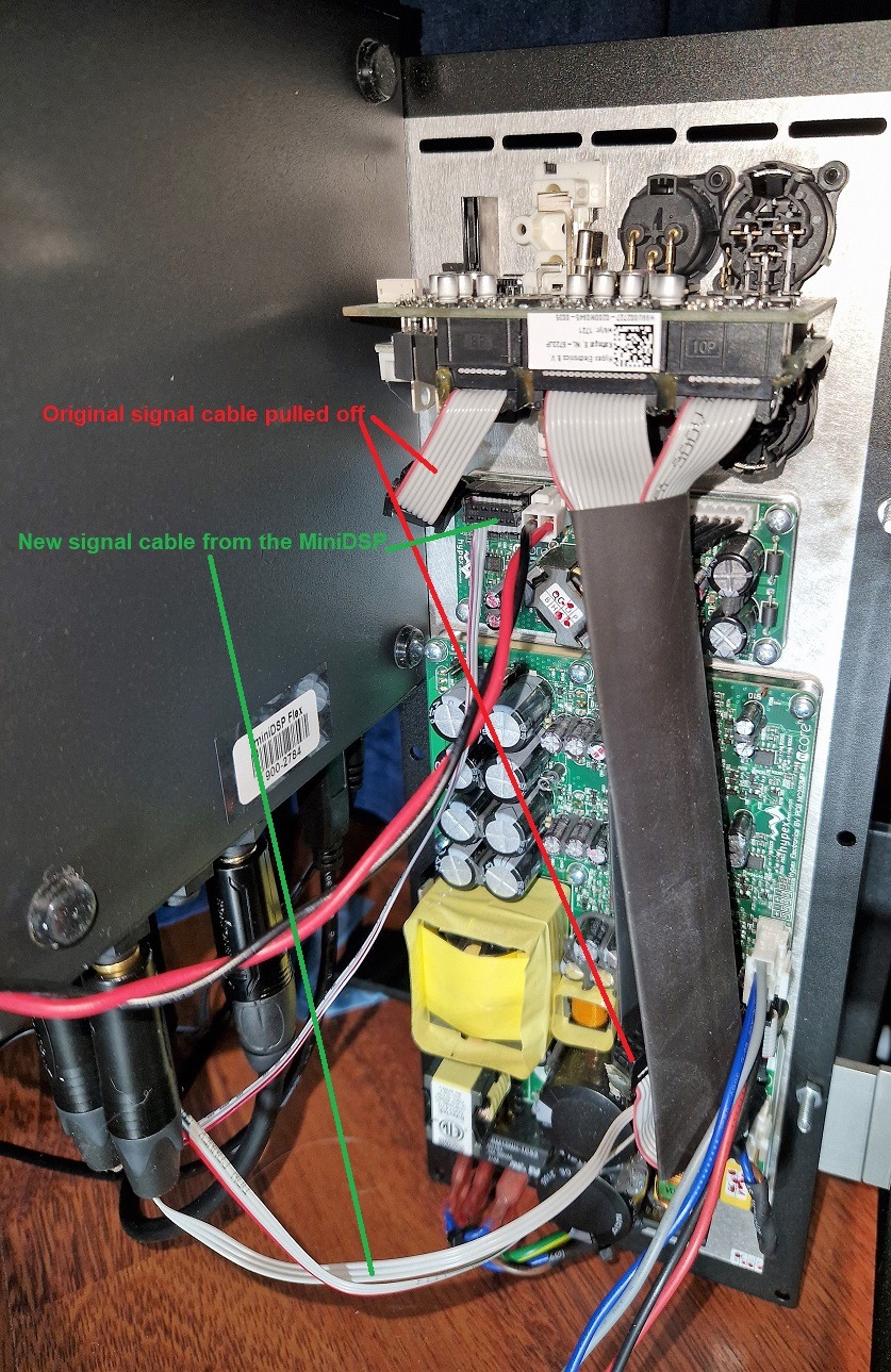

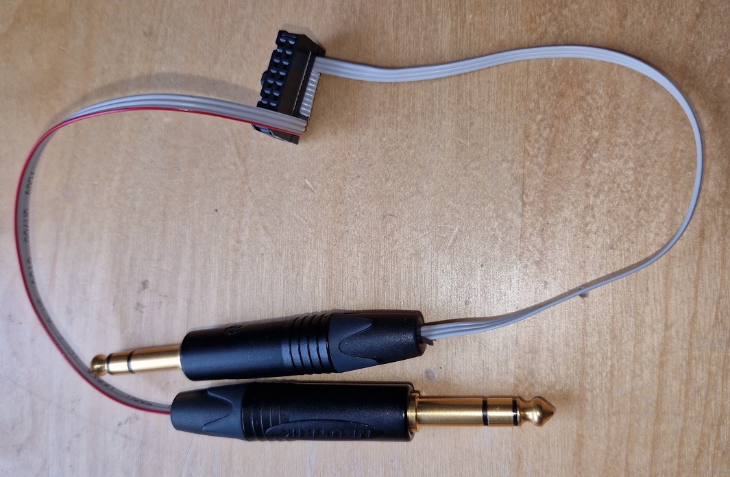

I've also switched DSP from Hypex FusionAmp to MiniDSP Flex. That is - I pulled the signal connector off the Hypex' nCore amps, and made new cables with TRS plugs that goes from the MiniDSP. The Hypex' control cable still goes to the DSP module, because it controls the fan, monitors temperature and other sensors.
The new cable looks like this:
The hookup to the MiniDSP

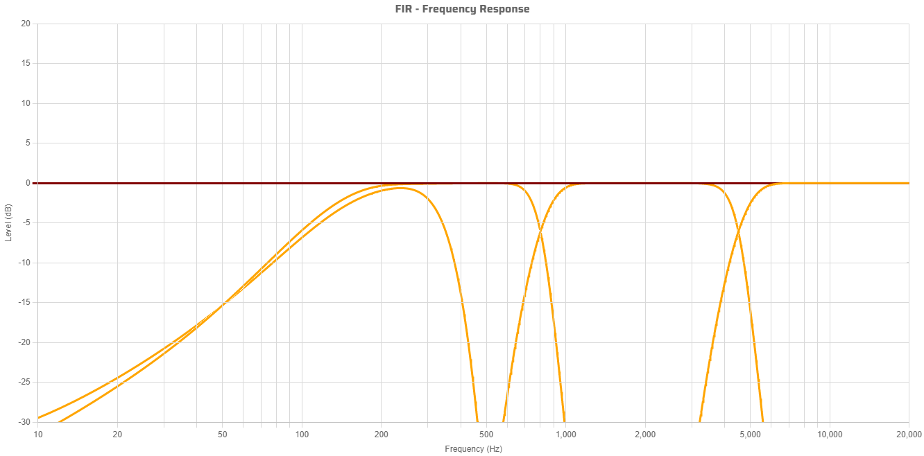

I also made all the crossovers with linear-phase FIR this time. It's much easier to integrate the two extra bass panels with the bass panel in the main speaker without worrying about the phase, and also possible to use very steep crossover slopes (96 dB/oct) with no phase shift. The filters look like this. Because of limited number of FIR taps, the lower crossover at 100 Hz is not very steep. The XO points are 100, 350, 800 and 4.5k Hz.
Is it a FA252 ? I got 2 of those. Would be a cheap way to make a hybride planar/woofer speaker with minidsp.
Ok I just cant figur out why the signal input are 2 different places on the board. And have you changed from rca to jack on the minidsp
