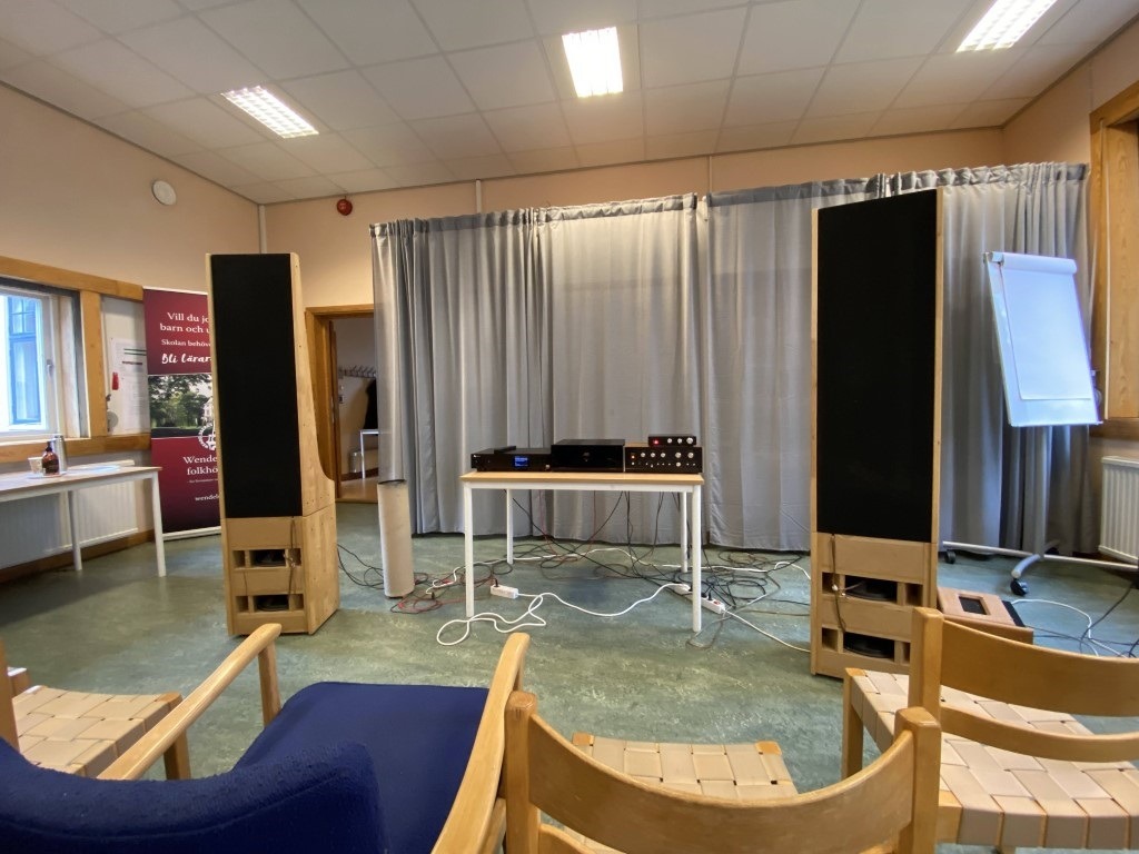

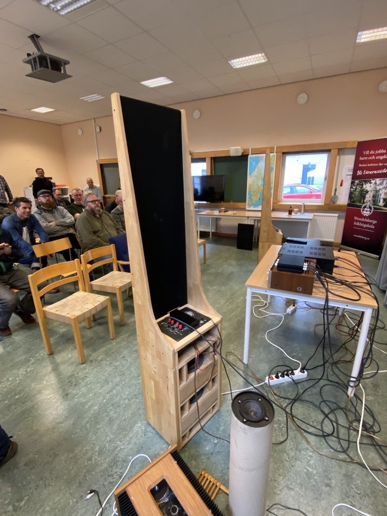

The H-frames have a 60x60 cm footprint, and the total height is 220 cm. It's like two large refrigerators really.i like the white covers in an attempt to hide the Hframes 😂
they do look close to the wall, I like to have my drivers at least 3 feet from the wall
We put them approximately 30 cm from the front wall to get a smoother bass response. Dipole woofers actually excite the room modes less when they are closer to the room surfaces, being sound velocity sources instead of pressure sources.

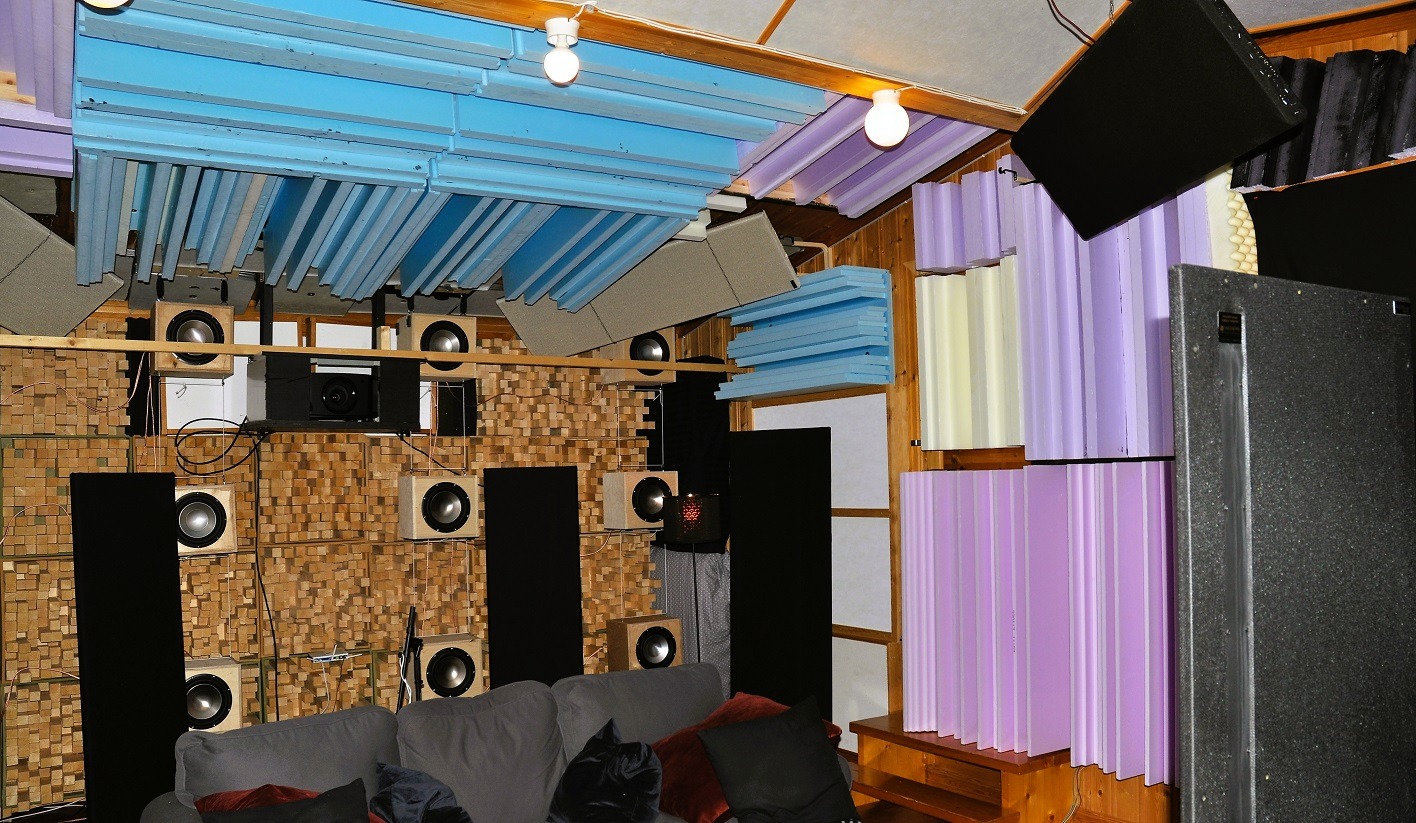

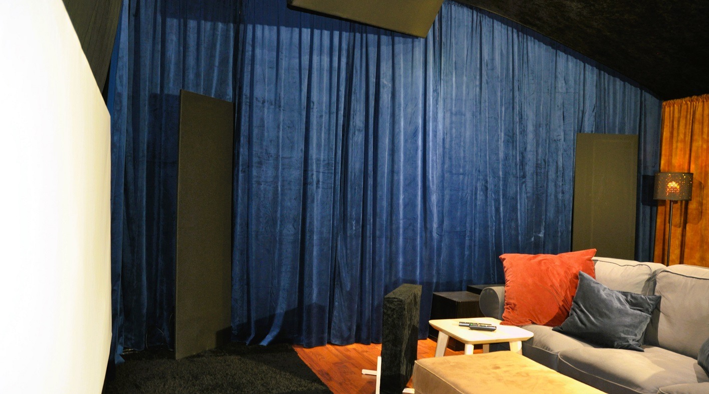

Here's a picture of my room as seen from the left front speaker. From left to right we see my 130' projection screen with a MG 3.6 center channel behind it, the front right MG 3.7, one (of four) MG 1.6 Atmos ceiling speakers, and a MG 3.6 surround speaker. The curtains cover up a lot of DIY diffusors on the walls and ceiling.
Rear end of the room, showing the amount of diffusion. There's also a pair of MG 1.6's behind the sofa on this picture, but they have been removed.

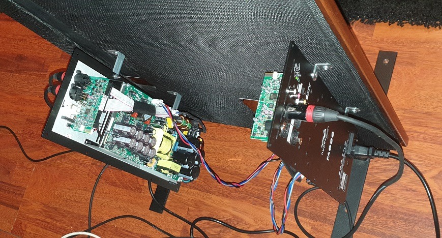

Interesting project,While we wait for more measurement, here's a pic of how I mounted the Hypex FusionAmps on the rear side of the speakers.
I like the way you mounted the amps. Any issues there?

Just be sure not to put your screws through the ribbon tweeter or anything metal. The frame is MDF, and regular wood screws work fine.
