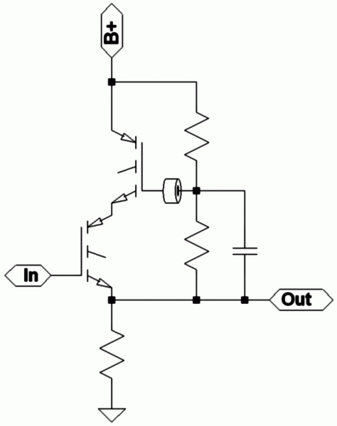

"magic" phase splitter for SimpleP-P
A lossy ferrite bead will do just as well.
Or at least let you use a lower resistor.
IXGH6N170A in TO247, a very easy package to work with.
330pF Gate, 6pF Reverse, 1700V, 75W@25C
IXGY2N120 in TO252 yet another surface mount pain.
110pF Gate, 2pF Reverse, 1200V, 25W@25C
might be worthy of the trouble.
Even the best IGBT of MOSFET doesn't compare with glass
for low capacitances....
ECC82(AU7) 1.8pF Grid, 1.6pF Grid-Plate
ECC83(AX7) 1.6pf Grid, 1.7pF Grid-Plate
But there are other factors to consider.
IGBT transconductance several thousand times higher...
If our purpose is a voltage follower / driver ...
Whats the capacitance we expect from our output tubage?
Are we driving a bigger gate than the grid we avoid?
The 6AQ5 George mentioned is only 8pF grid, 0.4pF Grid-Plate.
Do I really want a higher capacitance MOSFET or IGBT follower
to drive this, unless I am going for the full A2 experience?
What of a cascode, where the grid, base, or gate of the top
device, rather than tracking a fixed voltage, tracks the active
cathode, source, or emitter of the lower (plus some amount)?
Now we have all three terminals (rather than just two) of
our lower device follow the input, and the capacitance is
effectively eliminated no matter which device we use.
Any devices of your choice.... Hide all capacitance.
Like a cascode, only the top end follows too.
With no effective capacitance at the main input,
does that terminal require a stopper or not?

Any devices of your choice.... Hide all capacitance. Like a cascode, only the top end follows too.
I "discovered" this concept while developing some "other kinds of hybrids". Not only do the device capacitances disappear, the constant voltage across the bottom device remove many sources of distortion. I have built some fairly serious cathode follower output stages using 6336A's for both devices, or 6336A's for the output drvice and a mosfet for the top device.

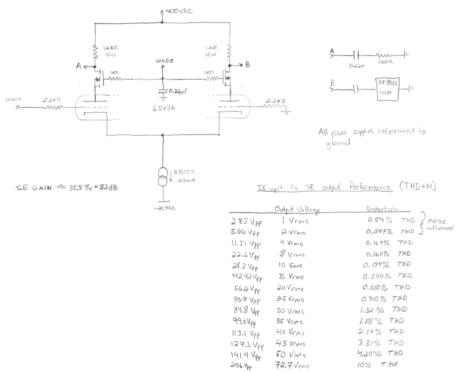

Ah! Here it is...I got home too late last night to think about it. And did other stuff all day today. This isn't a huge swingin' diffy stage, but it can use a lot of different cheap tubes, and only needs one per channel. Nothing about the circuit is really set in stone, all kinds of customizabiliity, this was just one setup i got to test so far...
hey-Hey!!!,
Nice work there! Can you re-measure with the gate cap moved from ground to the cathode node? ( keeping gate-cathode voltage more like constant )
