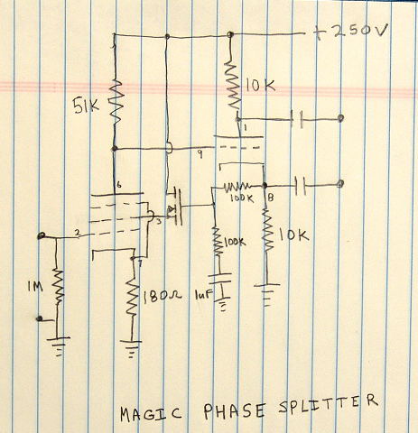

In my scarce spare time I have been researching circuitry for a SimpleP-P amp design. There will be more than one SimpleP-P amp, but I am working on the "little guy" first. This is a small low cost amp aimed at blowing some other low cost P-P amps out of the water. There are several compromises required for any low cost design.
Obviously reducing the number of tubes is a big one. As is a good low cost power supply. It would be possible to make an amplifier with 4 tubes (2 per channel) by using a pair of dual tubes. I built a few. After lots of testing, I came to the conclusion that I wanted to use a pair of "real audio" tubes in the output stage. This means that I would use a solid state power supply, and I needed to design an input stage with enough gain to drive the output stage (30 volts P-P) and allow for the use of negative feedback in pentode mode. I need to get a gain stage and a phase splitter in a single tube to avoid an 8 tube amplifier. No expensive tubes are allowed, and I would prefer a circuit that could use several different low cost tubes without readjustment.

OK, I had to pass on the LTP. I tried several of the usual concertina based phase splitters driven by a common cathode gain stage using the other half of a dual triode. These work well, and are the standard choice for this type of amplifier. The typical dual triode that works well here is the 12AT7 or 12AY7. These tend to cost at least $7 USD from most tube sellers due to their "audio tube" status. Others that work well (2C51-5670) may not be easilly available worldwide.
Next, I thought about the triode - pentode tubes used in TV sets. I tried using the pentode for the input stage, and the triode for the concertina splitter. Tons of gain, balance, I am on the right track, but the distortion is a little too high, and the DC voltages change a bunch when I change tubes. Time for some serious tweaking.
The breadboarded circuit was sitting on the bench feeling ingored and neglected for about two months when I saw this thread:
http://www.diyaudio.com/forums/showthread.php?s=&threadid=119821
The little wheel inside the brain started slowly turning. Yes, I tried connecting the screen grid to the cathode of the concertina. I had already guessed what would happen, and I was right. The current drawn by the screen just killed the balance of the concertina. Wheel turning slightly faster, digging through notes..... Then I found the notes that I had made during the experiments done related to this thread:
http://www.diyaudio.com/forums/showthread.php?s=&threadid=97384&highlight=
The wheel spun fast enough to light the light bulb in the brain. I could use a mosfet for isolating the screen grid from the concertina cathode. I could also seperate the DC and AC feedback and use a different amount of each. I added the mosfet today and tweaked it out. This was the magic phase splitter circuit. The distortion was in the 0.2 to 0.35 range at 30 volts P-P. The frequency response was very good (-3db at 250 KHz) and the circuit remained balanced beyond the range of my measurement capability. I swapped in a bunch of different tubes, not just different tubes, but different types of tubes. The distortion remained low for all tubes except the 6U8. It would work with a different cathode resistor. Tubes tried: 6U8 - ECF82, 6EA8, 6BL8, 6JW8, 6GH8, 6HL8, 7687, 6KD8, ECF80, and ECF802. Multiple tubes of each type were tried, all worked.
I plan to experiment further with this circuit, but for now I have to work on some TubelabSE issues (2SK2700 replacement evaluations).

George, this is intended in a purely constructive manner. There is no doubt that you are more knowledgeable than myself. This is purely a point of view.
30Vpk-pk doesn't seem hard to achieve unless your aiming for input sensitivity, or planning to use a large amount of feedback. Most sources will put out a good 2V. Some amps lack volume range from being overly sensitive and the amp will start clipping with the knob only 1/3 of the way up. It can be slightly frustrating from an end-user point of view.
I have nothing against Pentodes as I use them often, but think 12AT7 may work well. They can be a little pricey if bought new from a supplier, but are widely available and can be scored cheap from ebay.
If you do go with a pentode-triode tube, I'd stay away from the phase splitter-to-G2 feedback. Since you will probably be using Pentode output tubes, the feedback would be better used with the output stage in the feedback loop. And for a "simple PP" using 2 feedback loops wouldn't be so simple. A partially, or fully bypassed cathode resistor with feedback to the cathode of your gain stage would probably make the most sense. That would also avoid loading the plate and cathode of your phase splitter unequally (even tough the Zout is different, something just doesn't feel right about unequal loading), and leave the FET out of it, for the potential builders who want all-tube audio circuitry.
I am always interested in trying some new idea to see what might be discovered. Perhaps something great, or maybe not. Who knows without experimentation? I am really curious, what do you have in mind for output valves?

Hey, all opinions are welcome and nothing is cast in stone yet. I am throwing this circuit out there in case anyone wants to experiment with it. There is still a LTP breadboard, and a conventional common cathode feeding a concertina breadboard on my bench right next to this one. There will probably be a few more before I am done.
My usual design methodology will create a few different input stages, and an output stage or two, then I will put them together to see what works best as an amplifier using bench supplies and finally design a power supply for it all.
The DC feedback is needed to stabilize the operating point accross a wide variety of tubes. The AC feedback may or may not be used depending on how much gain is needed in the total amp design. I plan to allow for a reasonable amount of GNFB when the output tubes are operated in pentode mode, and allow for zero GNFB for triode mode. I would like there to be enough gain to make full power with a 1 volt signal when max feedback is used. I agree that too much gain is not a good thing, and I am not one to use large amounts of feedback.

The screen feedback approach (or upper grid for cascodes) opens a whole new area for design. Pentodes can now be seen as triodes with separated output and feedback terminals. So much more flexible than triodes.
One does need to keep the plate V above the screen voltage to avoid screen current distortion and preferably both V tracking too. Any of the follower type feedbacks from the plate will do this fine and the resistive divider gives a nice gain boost as well as dropping the screen voltage from the plate V. Should work nice for a splitter as long as the Mosfet is low input capacitance.
With a cascode instead of the pentode, could probably just use the Mosfet follower as the splitter itself, since the upper cascode grid would not be drawing any appreciable current. But this would eat up B+ headroom badly with the cascode unless a zener/cap gets popped in to lower the splitter drive.

In a source follower the "reverse transfer capacitance" (gate to drain) is the important spec. The "input capacitance" (gate to source) is bootstrapped by the follower action and does not do much damage.
There are valid reasons (phase intermodulation distortion) to look for a reverse transfer capacitance that remains constant with varying voltage. Most mosfets have a capacitance VS voltage curve buried in the spec sheet somewhere. For many the reverse transfer capacitance flattens out in the range of use for tube amps. The clear winner here is the Toshiba 2SK3563. The curve is a constant 7 pF at any voltage above 20 volts. I have just acquired a bunch of these for testing in a TubelabSE, and one of these was used in the phase splitter experiment.

Tubelab...Looking at that sketch/photo It looks doubtful if you are doing anything new here.
It reminded me of a close-to by RCA with the 7199 application notes (www.triodeel.com/7199.htm).A stab at the data sheet depicts optimising g2 as mission impossible.
I found this RCA circuits esp the g2 of the pentode section requires a totally different voltage than the cathode follower section of the concertina for optimum min thd v.s level.
The black anode originals (at a price!) are fairly consistent and work as enclosed photo cct, but plugging in a Sylvania the repeatable performance becomes choatic. However, when all NOS pentode sections are config as triodes, then things become far more consistent, even Sowteks are fine.
Although I've been thinking on the same lines, sadly the transconductance is a far from a set parameter. So I'm staying with pentode botched as triode front ends. Gain low so I use a step-up transformer.

Rich:
Interesting to see a diagram so close to the present screen feedback from a concertina. But it looks to me like C1 (from screen to cathode of the pent.) is an electrolytic since it has polarity signs. I think RCA's engineer was just taking advantage of the convenient voltage source for the screen here. What appear to be voltage markings on the diagram also indicate that it would be in a rather distorting mode with the idle plate voltage at 77V and the screen at 85V.
But I wouldn't be surprised if some old journal article somewhere explored the screen feedback scenario. Not rocket science really. I just don't think that it was making good sense back then without low cap. Mosfets for easy followers.
You know, I have that schematic but forgot about it. People have been saying that all possible tube circuits have been invented already. I am beginning to think that this may be true. I spent some considerable time making cathode followers that used a DSP based SMPS to "modulate" the plate voltage to keep the voltage across the tube constant. I thought that it was actually something new until I found out about Macdonalds work with "augmented cathode followers" in 1957. Maybe all possible circuits were invented years ago, but we have technology and components available to us today to reinvent them in an improved way.
Actually it is the DC feedback to stabilize the operating point that I was looking for initially. I have a 1uf cap there which limits the response to essentially DC. The resistor in series with the cap can be adjusted to add some AC feedback if desired to lower the gain. The mosfet is there to avoid loading the cathode, but it may be eliminated if the screen voltage is low enough compared to the plate voltage so the screen draws little current.
Thanks for the warning about tube repeatability. This circuit will remain idle for the next two weeks at least. After that I can run several hundred tubes of various types and conditions through it to see how well it really works with different tubes.
Annoying and critical that even minor diversion of the screen volts on a bench mock-up quickie has such a marked influence on thd. That's what the RCA engineers show with their 7199 data sheets..I 'm well aware that with an amp global nfb thrown in with the complete circuit in a 3 or 4 stage amp the whole trick with linearisating the pentode front end is so nicely accomplished in such a way that it makes the 1st stage screen volt variation a complete hoax. To prove this, I fitted a pot into the screen of the 7199 and adjusted it nearly a 1/3 and amplifier thd remained the same.
