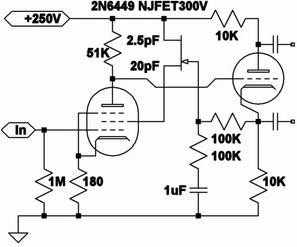

Since cathode follower is of lower impedance than plate, should
there be a 10K in line with the lower impedance coupling cap?
Still not sure how "impedance" of followers works, since its
obvious they can pull up a lot harder than pull down...

Ken:
2N6449? You found a decent source for these yet? All I could find was American Microsemi listing them as $16.51 and as an obsolete part. (Looks like Moto made them once) No fun burning those things out. How about using a cheap low volt JFET with a HV Mosfet tracking cascode above it, it's gate driven from the JFET source (zener volt shift, etc.).
The concertina splitter needs equal impedances on the plate and cathode sides to get equal drive voltages out. It does have a problem with capacitance loading, causing unequal slew rates.
Ya know, the cathode true complementary current mirror scheme (the SET from P-P thing) and a center tapped plate load inductor might make the ultimate spitter too. Equal slew rates and current drives. Maybe could replace the CT plate inductor with some P-channel voltage controlled Mosfet differential mirrors.

And if you get desparate, an augmented follower, any lame parts will do. But simple goes out the window.
I haven't had any time to experiment since the first post, but my somewhat misguided brain has cooked up several more ideas. Next chance I get, I am going to test the pentode based LTP that I mentioned back in post #21.
I am still looking for a design that is simple (no adjustments with a very high first time success rate) and low cost, that delivers the sound that I am looking for. I haven't found it yet, but I have about 15 more ideas to test. By the way my reference standard amp is a 300B P-P that I built about 6 years ago, lofty goals.
