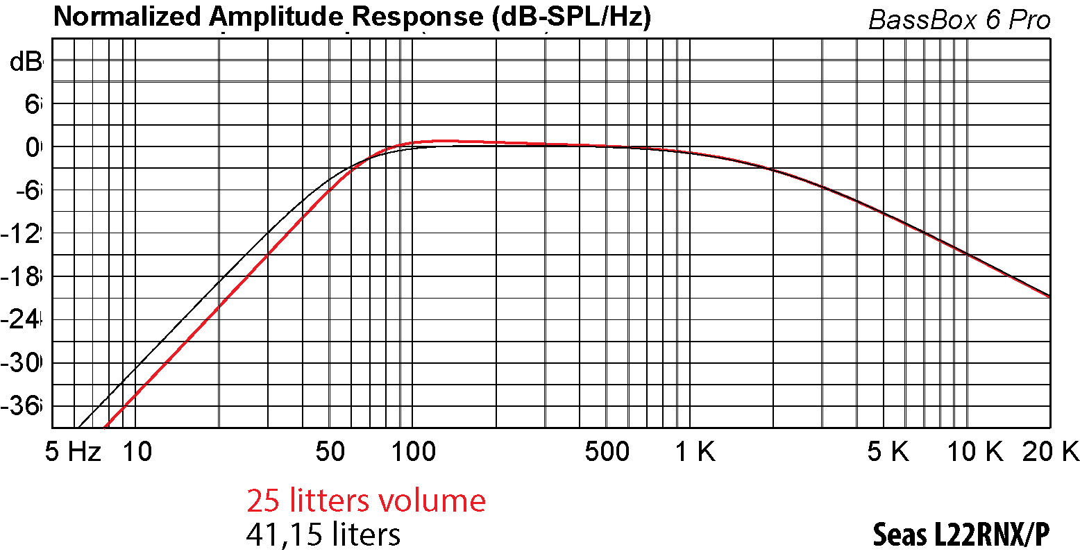

Have loaded Seas L22RNX/P data in to BassBox 6 Pro
Red graph- "bass box" was free to choose pipe volume with 2 drivers.
Black graph- 2 drivers in 25 litre pipe.

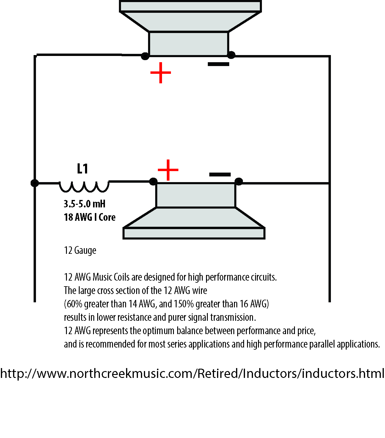

Have looked at 1 order filter coils and found this
Is it true coil wire gauge will affect sound quantity ?

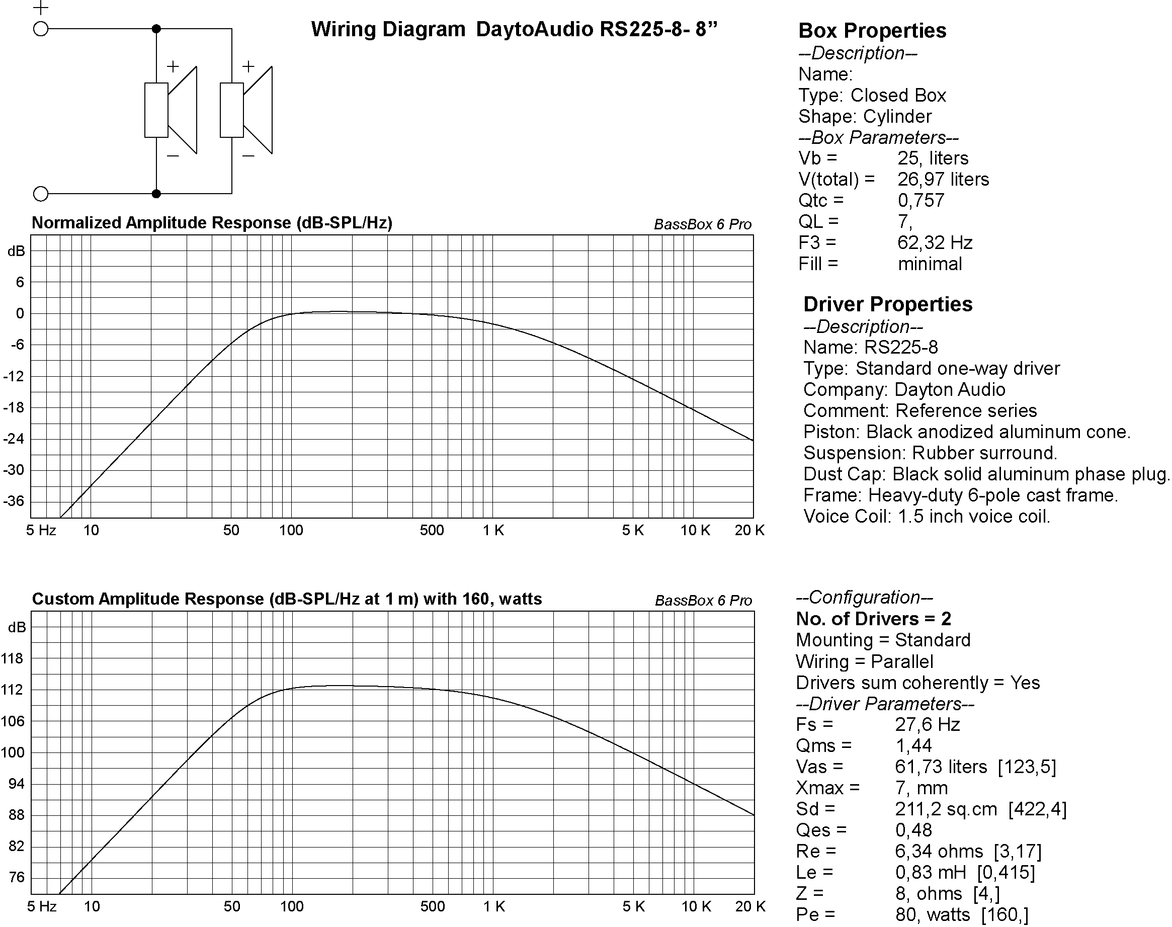

Was playing with BassBox 6 Pro software trying to fit all sort of 8" drivers to existing 25 litter volume enclose. Only one driver fit like a glove ....it was DaytoAudio RS 225-8-8".
Qtc ,using two drivers according to software, is still 0,757.
Speakers sensitivity quite impressive...
And have decided on to avoid using passive crossover...instead will order one more mini DSP 2x4 HD. Reason for avoiding passive crossover is...in the beginning is too many unknowns...precise value of coil, coil type and so on.
With active crossover ..sky is a limit....crossing points, type of filter is just under fingertips. Only then sound satisfactory ,possible to think about passive filter.

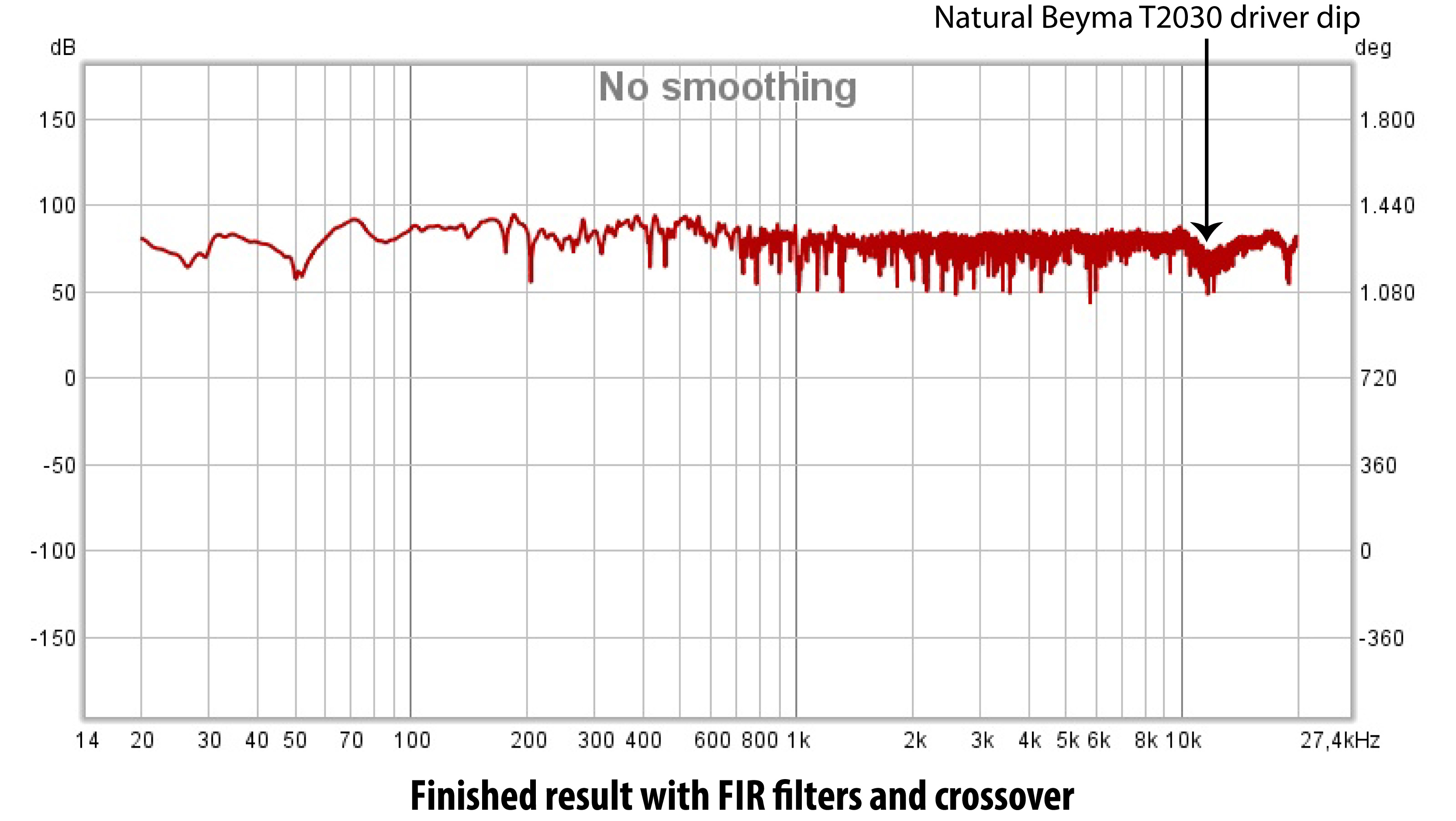

Enough with foreplay and let sum what was achieved with my approach to fine tune LX mini`s design.

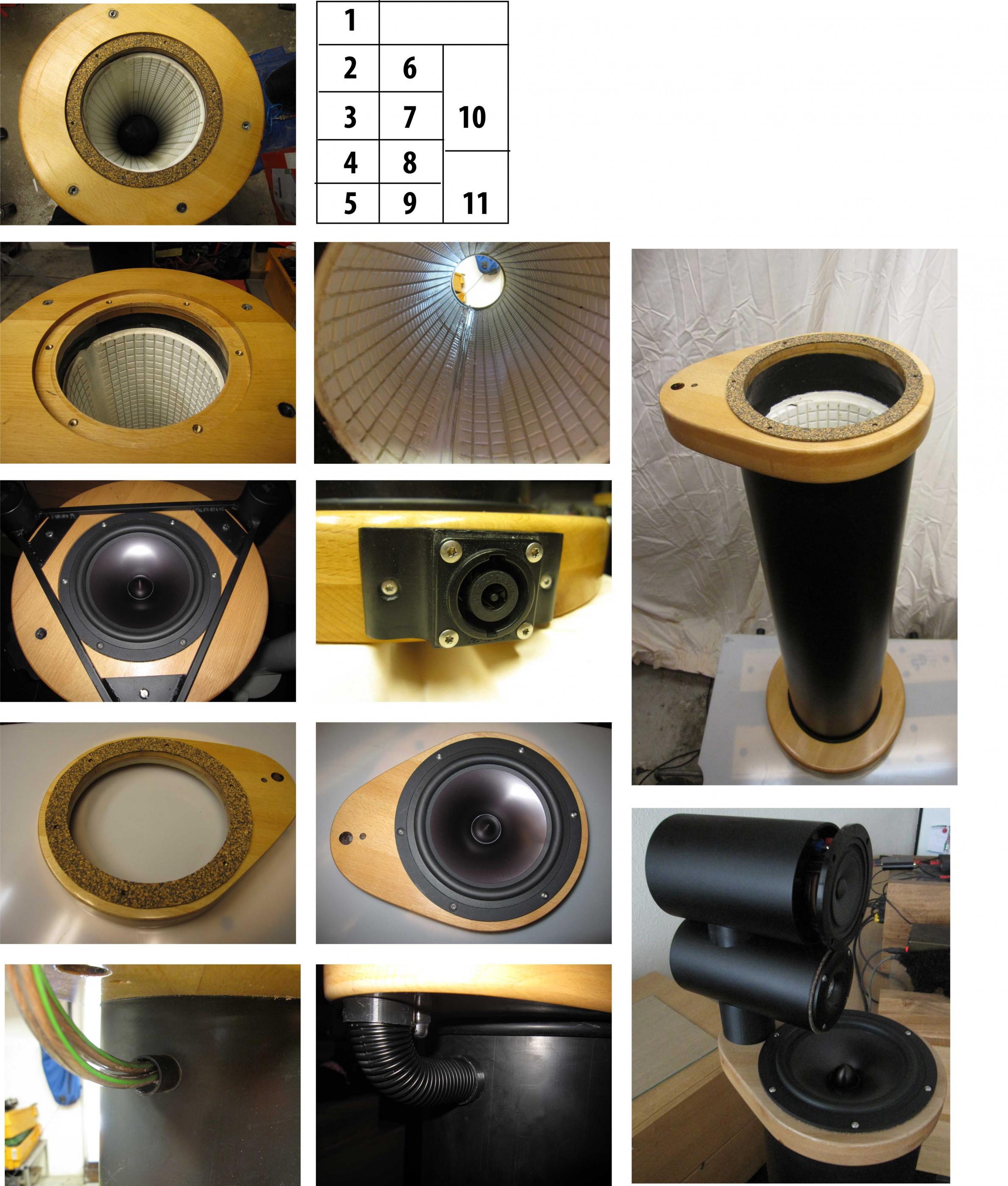

Mounting mid woofer driver vertically ( 5 or 6 inch drive just can’t reproduce low frequency in closed enclose to be called woofer) was genius SL solution to solve polar response and same of two-way loudspeaker design flows and in combination with full range drive it nearly have solved crossover flow in two way loudspeaker systems.
The problem is nearly –that is not god enough in a search for perfect sound reproduction.
That is driving engine for creativity and colorful approaches to the same problem.

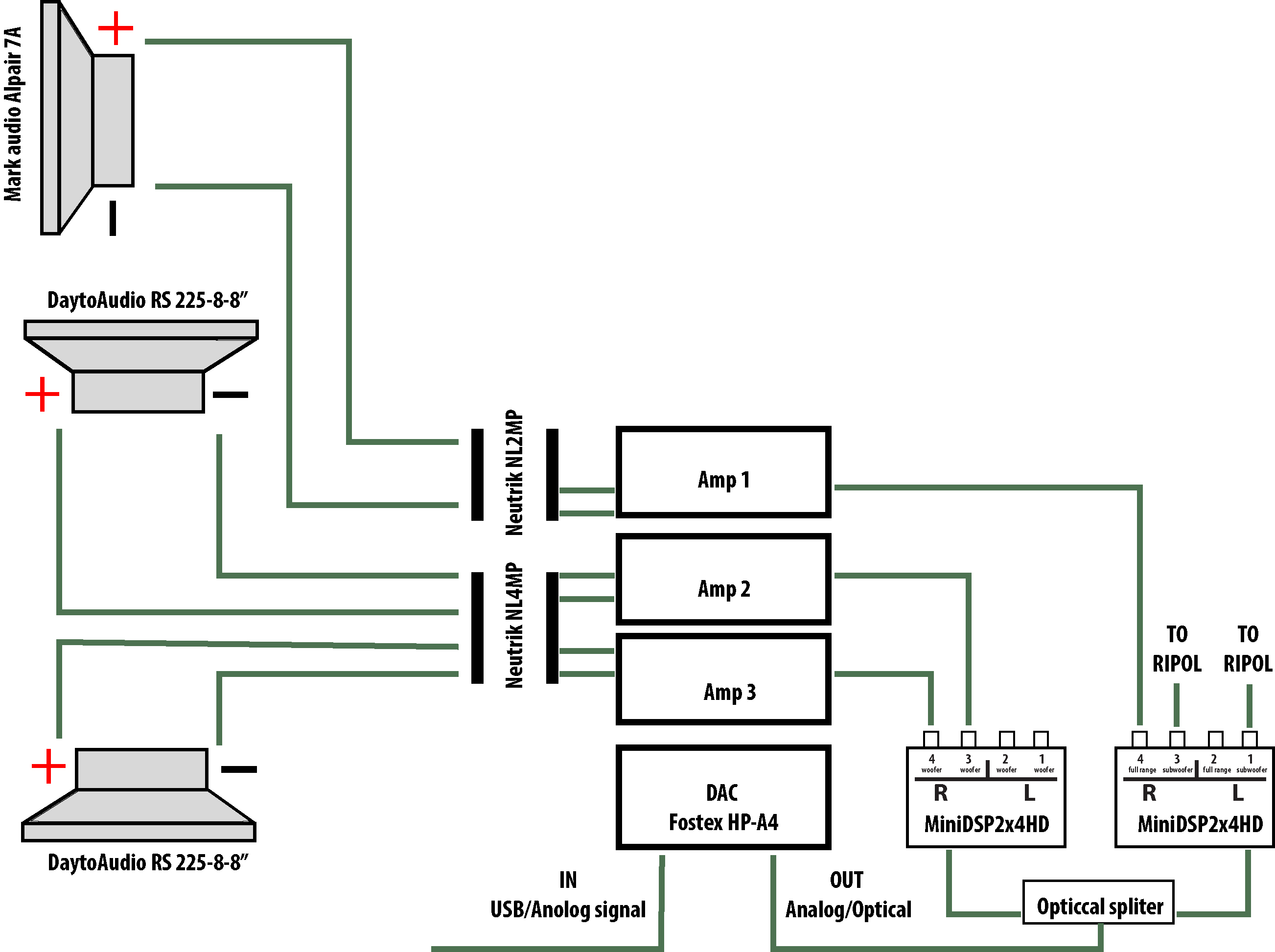

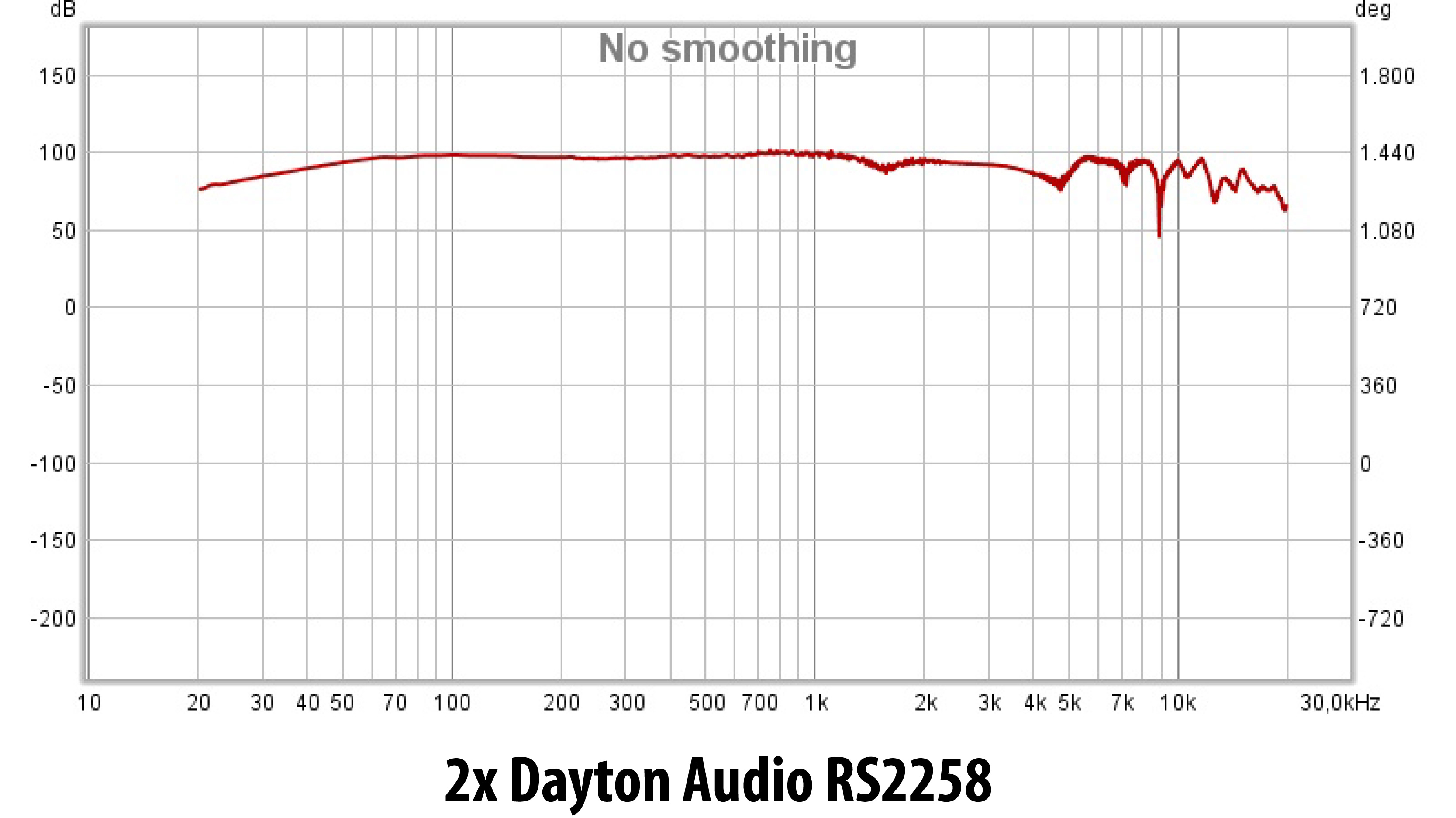

In my approach to LX mini design have ended up with 4 drivers in it:
1. 2x DaytoAudio rs225-8. Two drivers in parallel have solved closed loudspeakers encloses issue (google it) and boosted efficiency close to 100 dB, but left with natural 12dB role off from 60 Hz and excellent sound quality. Crossover at 700 Hz BW 6dB/oct, using only FIR filter.

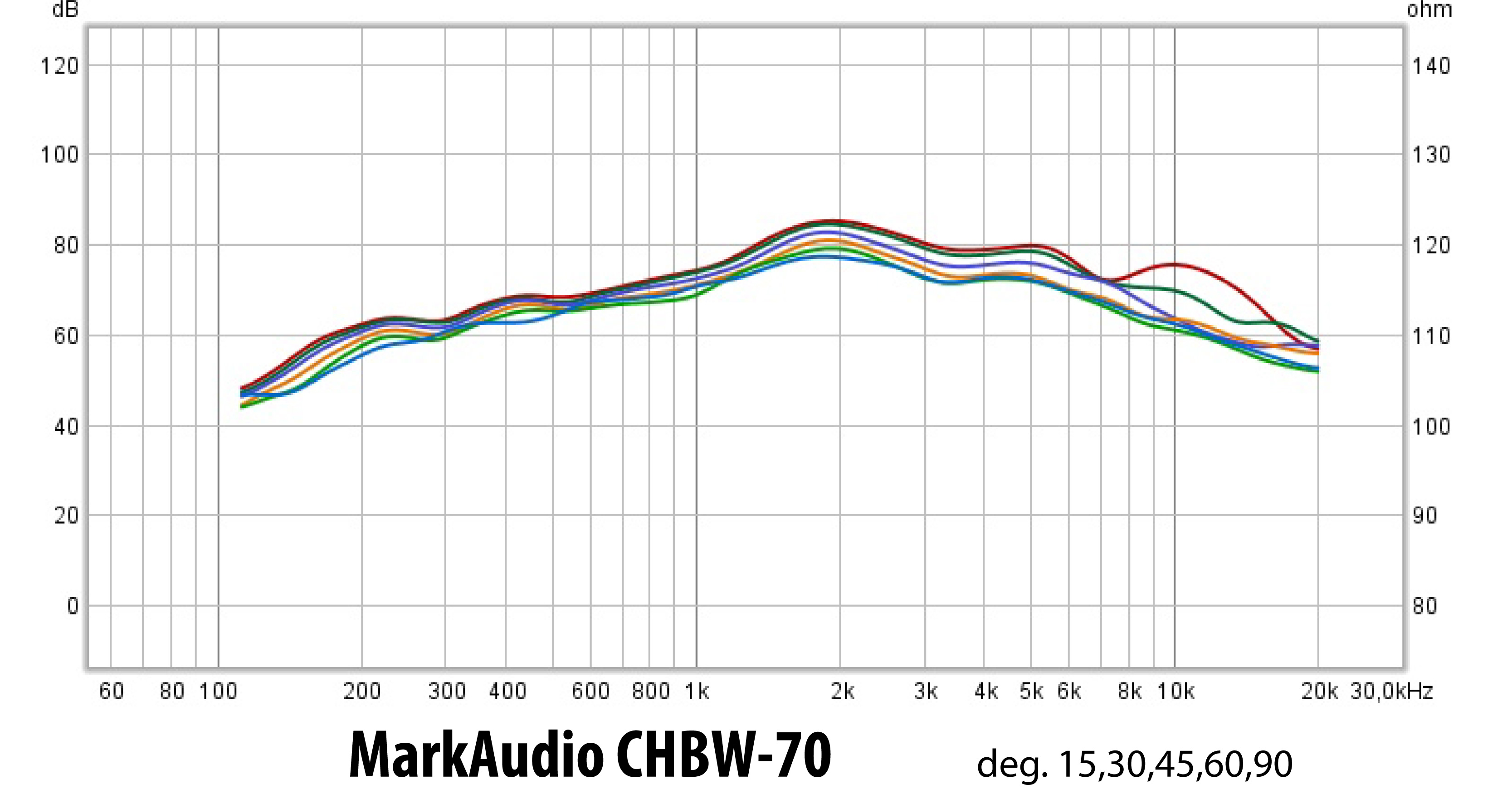

2. Mid woofer is a MarkAudio CHBW-70. Excellent polar response and natural vocal reproduction. This driver was crustal to end result of versatility of whole loudspeaker. Because it has, natural role off it was easy to combine with tweeter and remain as a two-way loudspeaker in whole.
3. Tweeter Beyma T2030. . Excellent polar response. Efficiency 95dB. Used passive First Order Crossover at 5,5Khz.
This loudspeaker can be used as 4 way, 3 way or 2 way system. 4 and 3 way is not interesting because it is a possibility to go crazy with endless settings and crossover combinations to your liking with DSP.
Most interesting is to remain like original LXmini -2 way loudspeaker and see have this entire job payed off in a sound reproduction quality. So, has is ….? Let me answer with an example, if any of you remember first time you heard serious HIFI system when normally your music enjoyment was thru radio on a table. The same difference is to original LX mini. Sound out of loudspeakers became liberated …bass is a joy, you can hear individual notes, vocalist know can flex vocal without having throat “sore” and pillow on a face. Musical instruments separated and established firm place in 3D picture. Personally, I’m happy with result ,for a wile…..

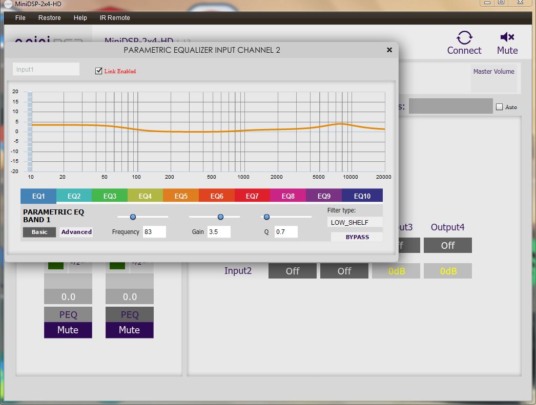

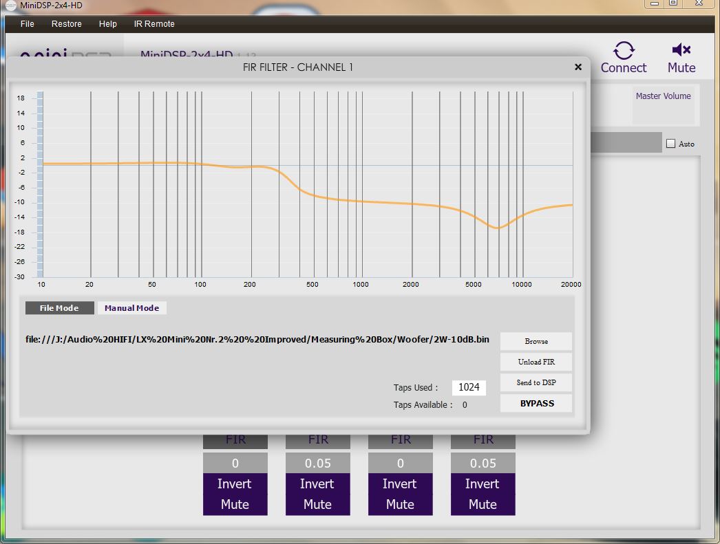

At same point SL have send me filters for miniDSP 2x4HD,originally lx mini filters was made for miniDSP2x4 with no FIR function.
LS filter version for miniDSP 2x4HD haven't used FIR function and remained such up to the end,
That bother me enormously...is the same like to use a horse for pulling brand new Ferrari.
FIR filter is crucial tool for linear speaker phase what results to to sound quality.

Are you saying FIR filter it is nonsense?
To be on the same lever and be ready for discussion what FIR filters are,lets start there. And there....
Correction and implementation a linear-phase loudspeaker crossover it is as far as it gets from nonsense.
All of us use huge amount of time to improve our HIFI even with in smallest margin and if we have succeeded -happy to share in this forum and discus it. So, even smallest victory is a victory....
