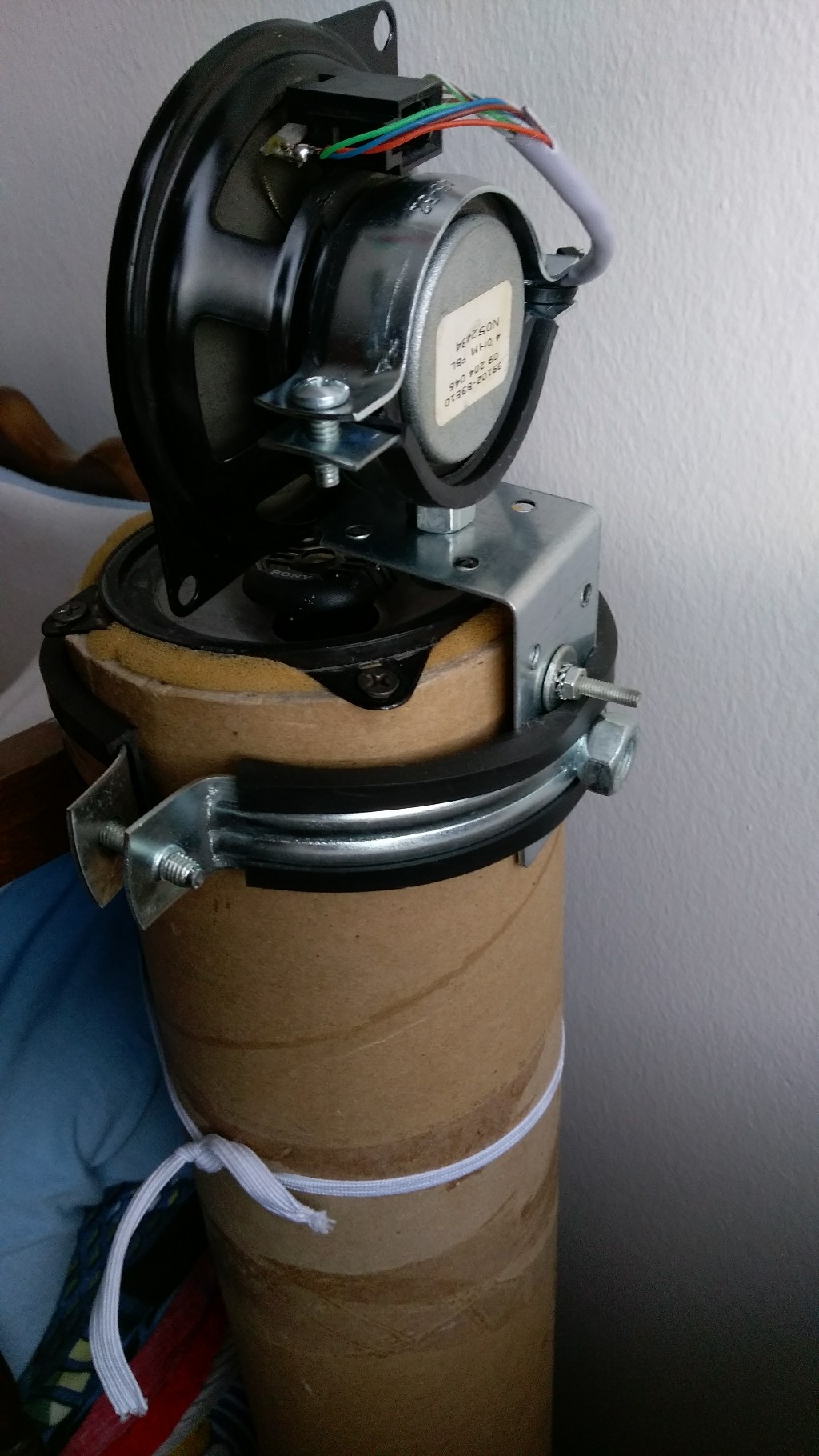

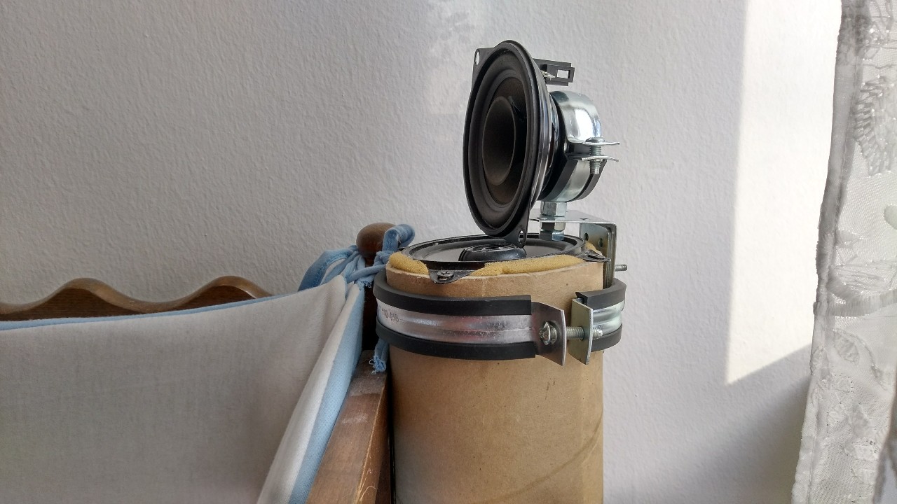

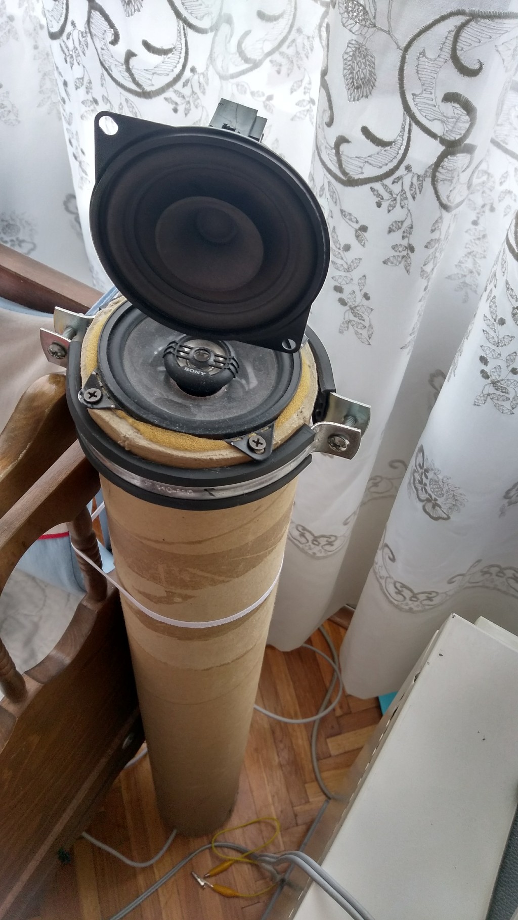

Speakers are just 4", 4 ohms speakers, the one on the pipe is Sony, the other one is no name OEM which I got for free. The pipe is a something like Sonotube,in fact it is a carpet roll, I got that one for free as well 🙂
Google for: Mass Loaded Transmission Lines
And : Pensil speaker projects.
This pipe is a sort of "Pensil" but the driver is facing upwards. (Google "Pensil" speakers)

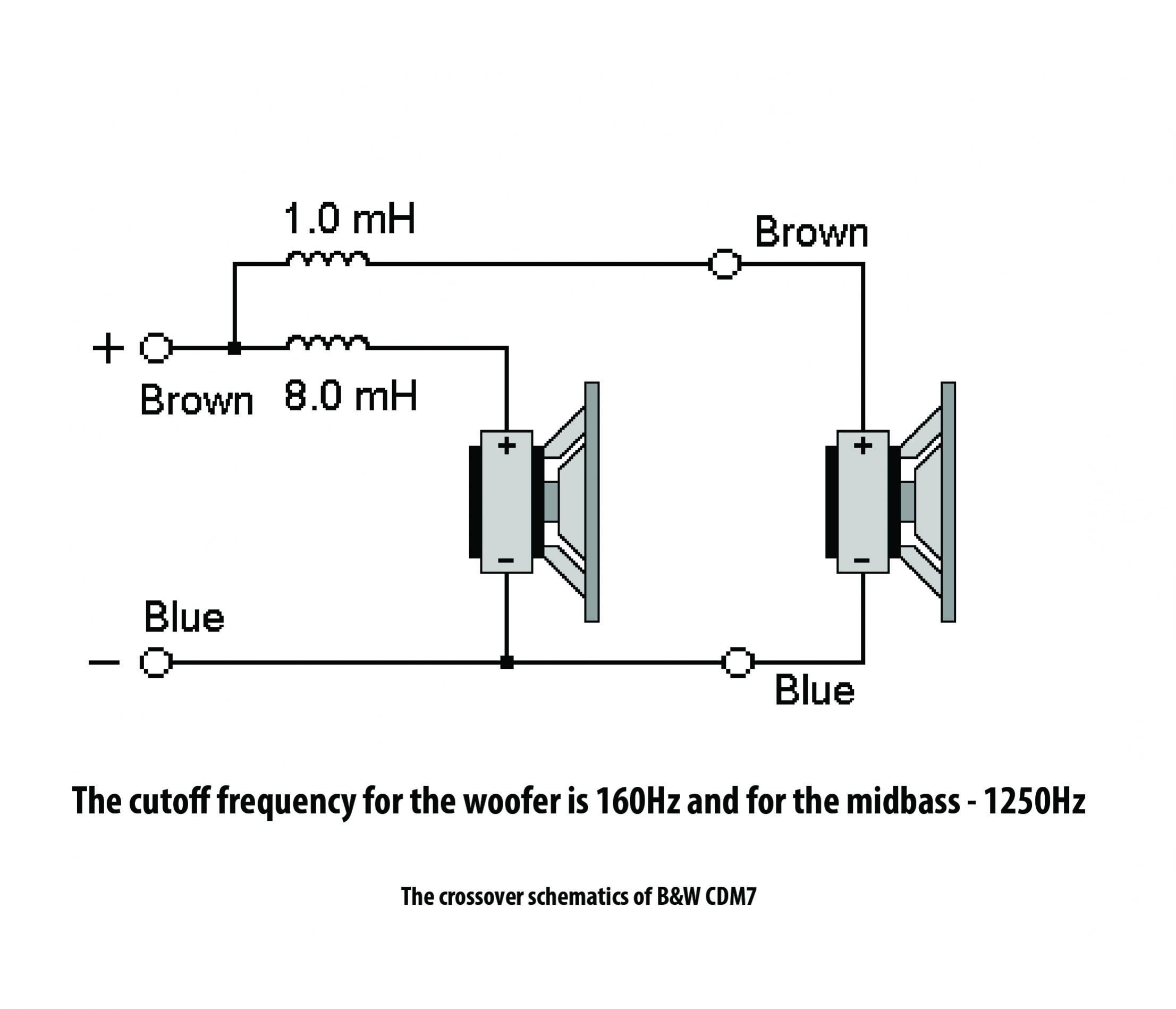

Crossover ...do you mean same thing like this ?
If you remove (short) the 0.47mH coil and use your active xover as you are currently, that will permit the usage as I suggested.

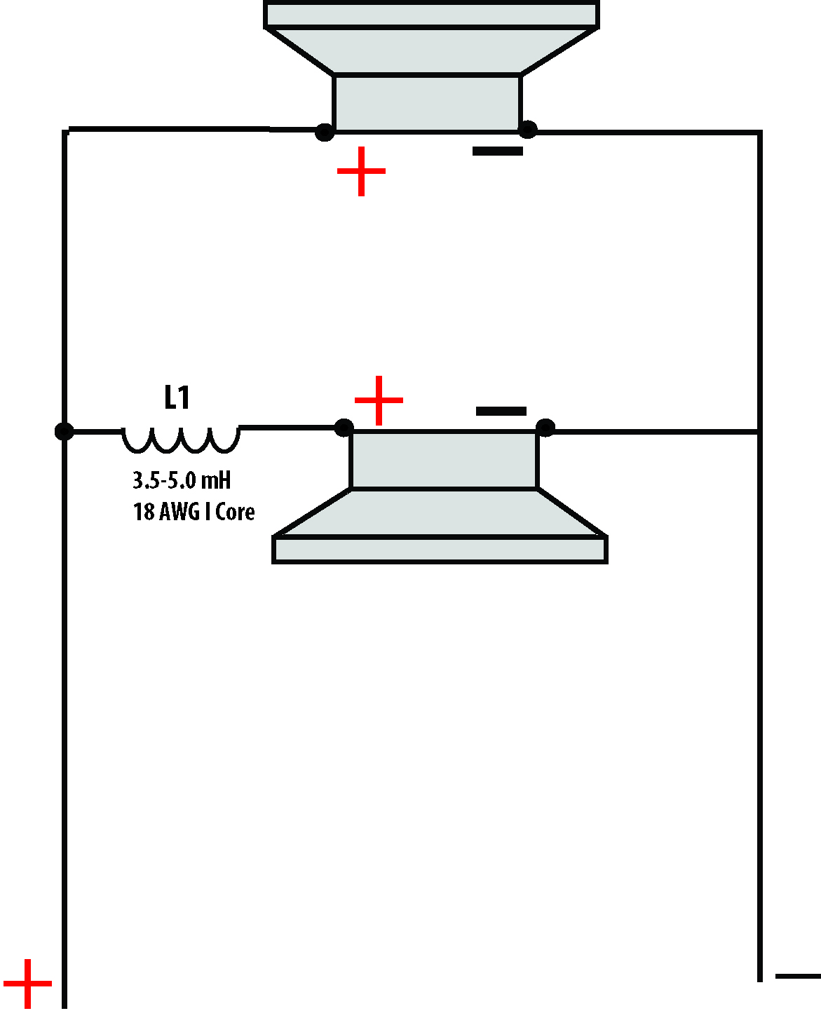

Dear Wolf,
I would like to thank you for suggestion to go 2,5 way configuration, I'm convinced this it is right way to do.
Such set up like LXmini ,I deeply believe, will benefit and a lot from 2,5 way configuration.
Personally I'm absolute idiot when it came to "hard" crossovers( never liked those).
Please take a look at drawing, is should be like this ?
If not can you make quick sketch, please.

Your previous image is correct in post #50. The photo you just posted is just another way of doing it, but not as beneficial in your case. The benefit with the 0.5 woofer is in it being in parallel with the 1st unit, and getting the same phase result as the first woofer, and the same upper xover point and blemish remedies.
Basically, both woofers will do the bass sector, as both are rolling off the upper end. Since the rolloff starts lower on the secondary unit, you can use it to gain back for Baffle Step response if necessary. You may have to play with the value of the coil to find the best compromise.
Some other info- as the woofers re in parallel in the bass, that is +6dB in that range over a single. The upper woofer will be mating the widebander, and the lower one will rolloff where it won't have to. If you think point-source, this is better in terms of wavelengths. The wavelength where the lower rolls off will be a lot longer, and easy to sum with the upper woofer. Since it will be on the bottom, it may also get some boundary reinforcement from the floor, giving you more bass than you might need. The other thing is that Omni-radiation actually eliminates the need for BSC, but introduces greater off-axis responses.
