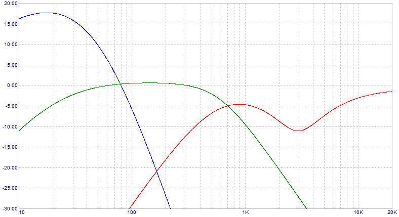

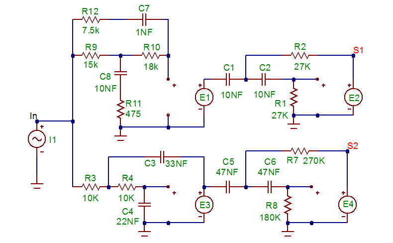

Has anyone been able to implement this crossover with the LX mini +2 with suitable adjustments?
A couple of analog Linkwitz sub-woofer ASP boards in a Pluto +2 sub-woofer configuration could be a solution...
This board can be adapted to the +2 and S versions without much trouble.
It needs some different RC values and an additional 4 pole low pass filter.
A Class D subwoofer plate amp will take care of the latter.
What appears to be suitable is the following for $95
Yung SD300 300W Class D Subwoofer Plate Amplifier Module No Boost
I tested the smaller version and was surprised at how much value it
offered.
Here are the desired response curves and a MicroCap schematic of
the components that deliver the mid and hi curves for the board.
