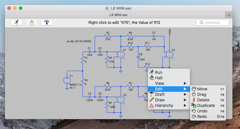

Hi lovely DIYers,
Not sure if this is the right place for this question, but someone may have hit the same pothole?
I want to configure the ACN for a bass / full range combo with a crossover somewhere around 120 Hz.
I've downloaded LT Spice and the ASCII file for the LX Mini crossover on a Mac desktop running macOS 10.13.6. I can get the sim working (yay!), but when I try to edit values I get this:
https://www.diyaudio.com/forums/attachment.php?attachmentid=835755&stc=1&d=1587331936
And nowhere an option to actually edit values. I've tried editing the ASCII file (no cigar). I've tried LT Spice help. I've tried deleting and reinstalling LT Spice, deleting and re-downloading the ASCII file.
Any help greatly appreciated!

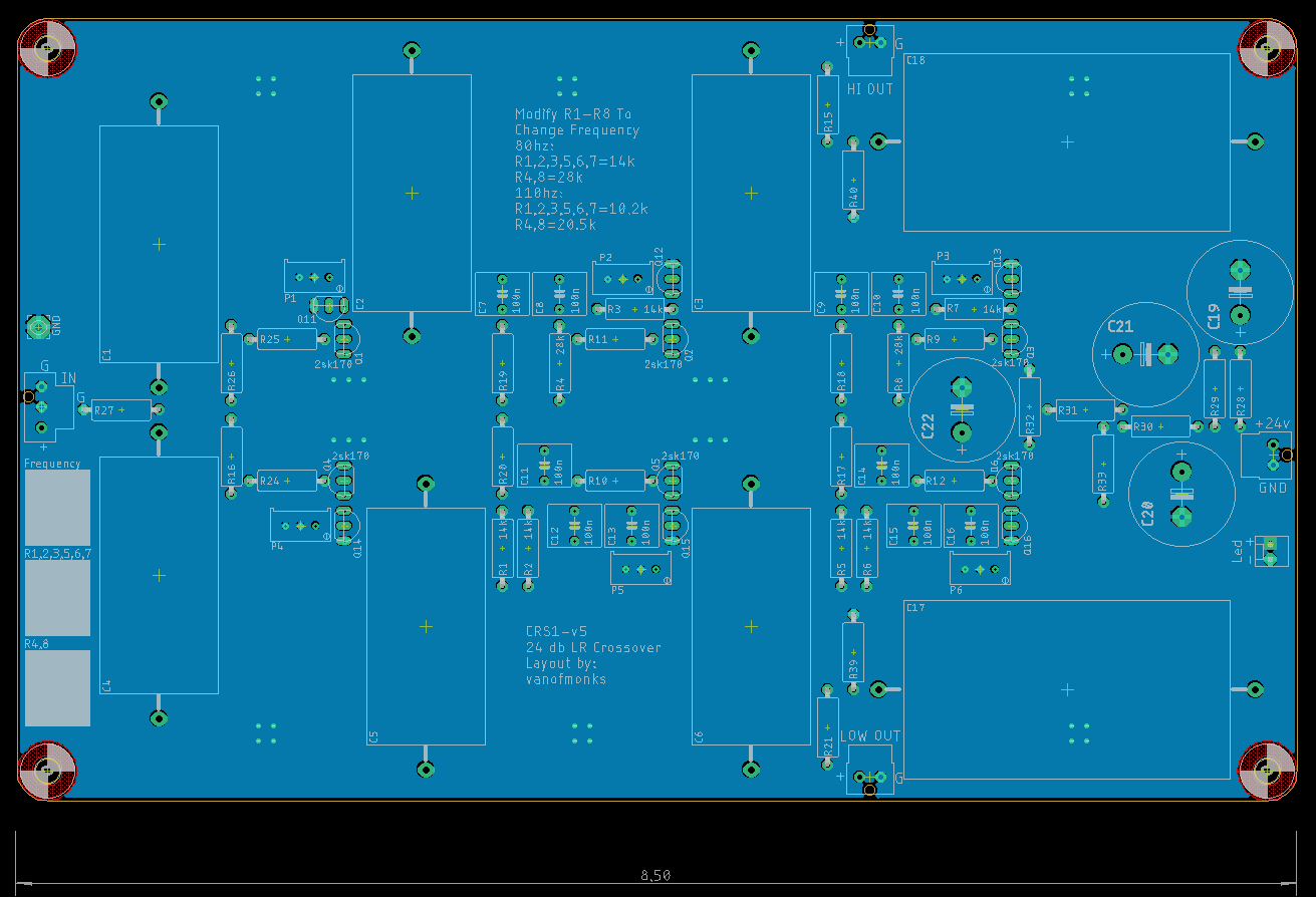

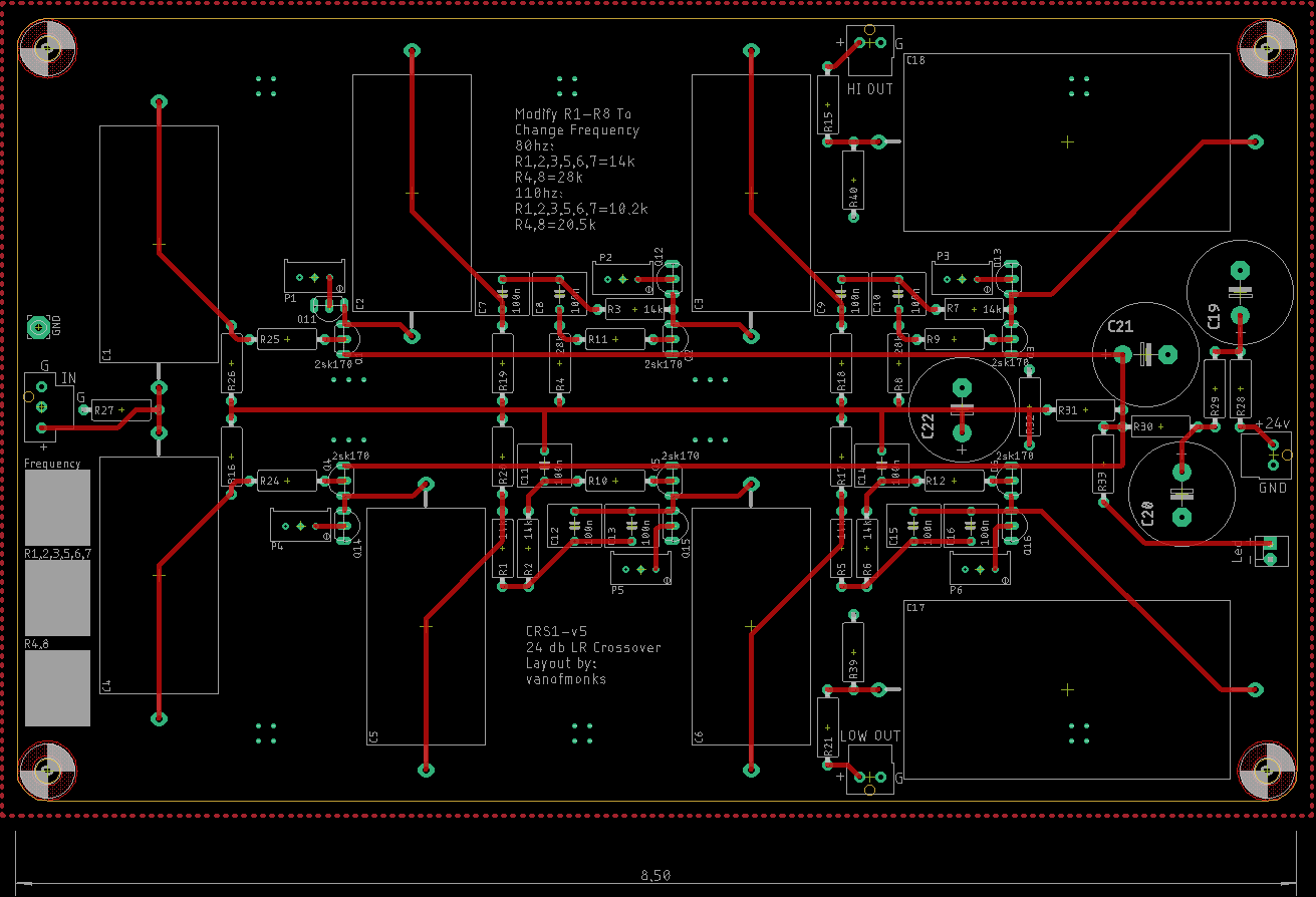

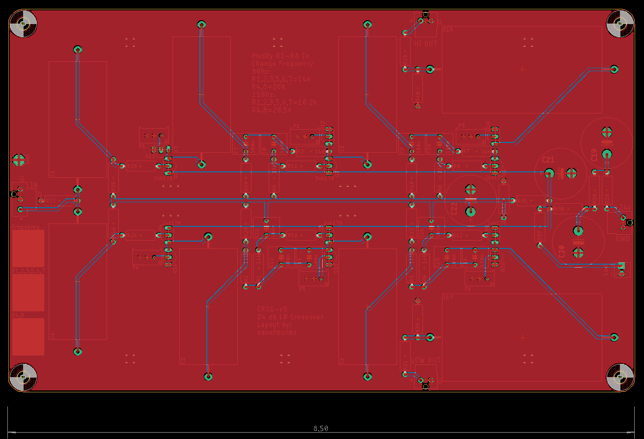

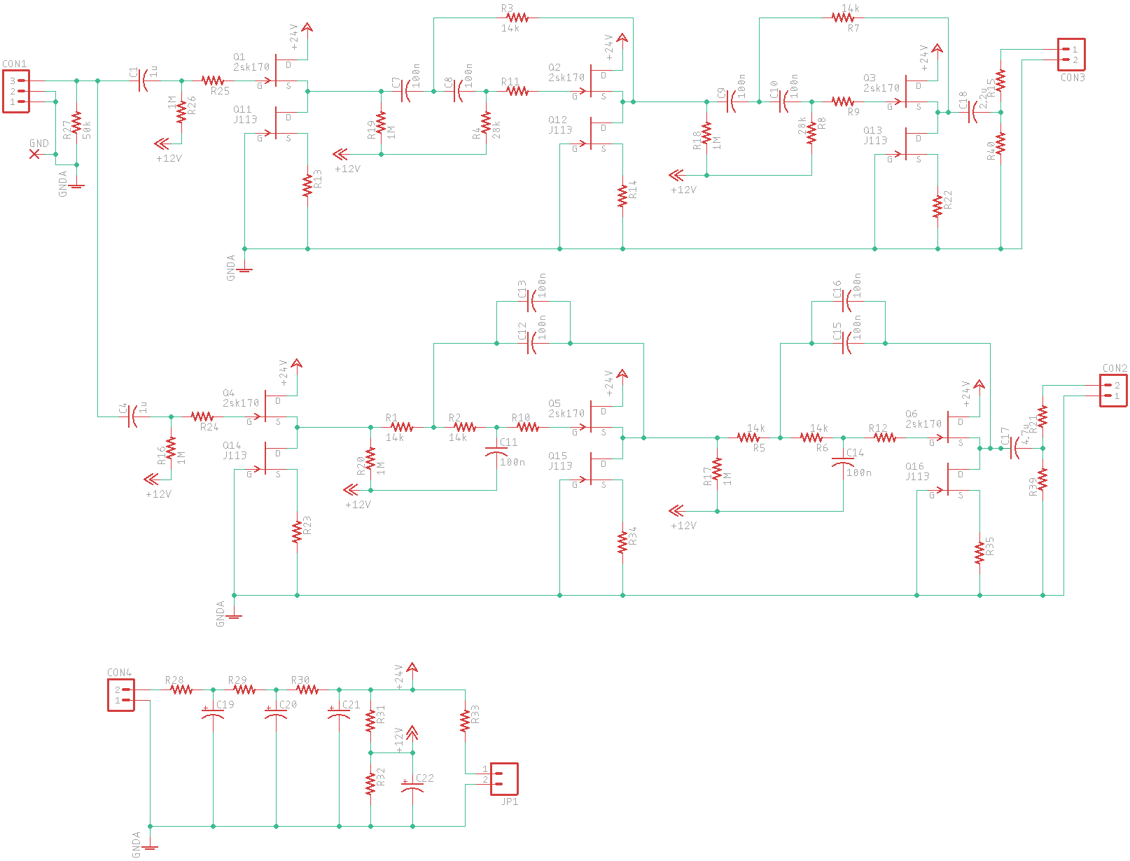

24db/octave lr
Here is a 24db / octave based loosely 😀 on the lxmini with 2sk170 loaded by the j113. Any thoughts?
You have what appears to be unnecessary DC blocking caps at the
output of the filters. In my experience you can arrange for sufficiently
low DC shift on each stage that you can get away with just the one
at the main output. Selecting the J113's and their Source resistance
will also allow fixed resistors instead of pots.

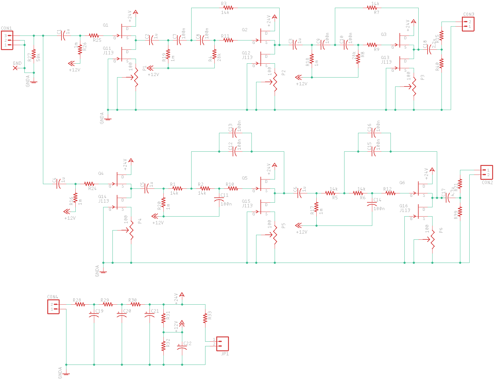

OK, I think this is what you were describing. I realized I didn't have it labeled on the original schematic, but this would be using 2sk170s loaded by the j113s. the 2sk170s and the j113s are matched, so i suppose need to set up a jig with a pot and determine the value of the load resistor. Or would loading the 2sk170 with a j113 require the coupling caps? Thanks for the help.

Usually you want to run the 2SK170's at slightly less than their Idss, which
gives them a slight DC offset, but not enough to create problems as long
as there is a cap at the end of the chain of circuits.
You can run them at Idss if you want, the difference is subtle.
Most of the J113's have higher Idss, so you would pick a resistor value
which biases them at the figure desired for the 2SK170's.
