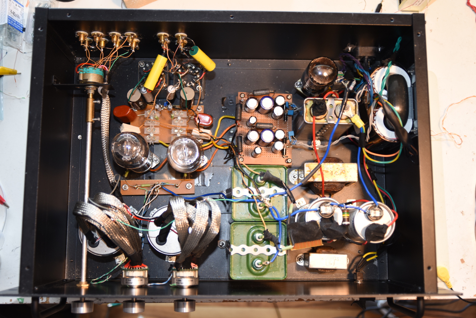

My old preamp was DIY 01A tube based with filament bias and output transformers. I really liked it a lot, but the old tubes are getting harder to find and my stash is running low. I was resorting to using 112A tubes, which are the power version of the 01A. So, it was time to cut my dependence on the old tube market.

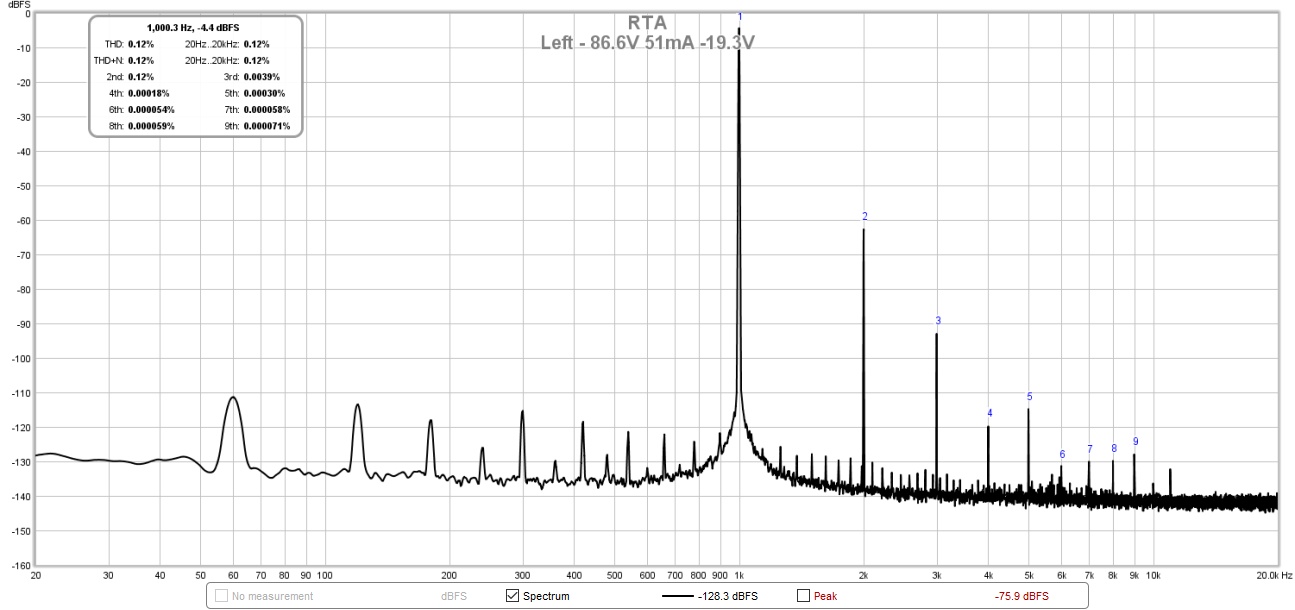

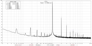

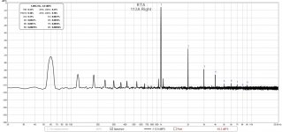

I measured the distortion spectra of the tube preamp using the 112A so that I had a basis for comparison when I got my LuminAria running. I've included FFTs of both the tube and LuminAria preamps for comparison.
I used fixed bias for the Luminaria as several other people have done so. It makes for adjusting the operating points easy.

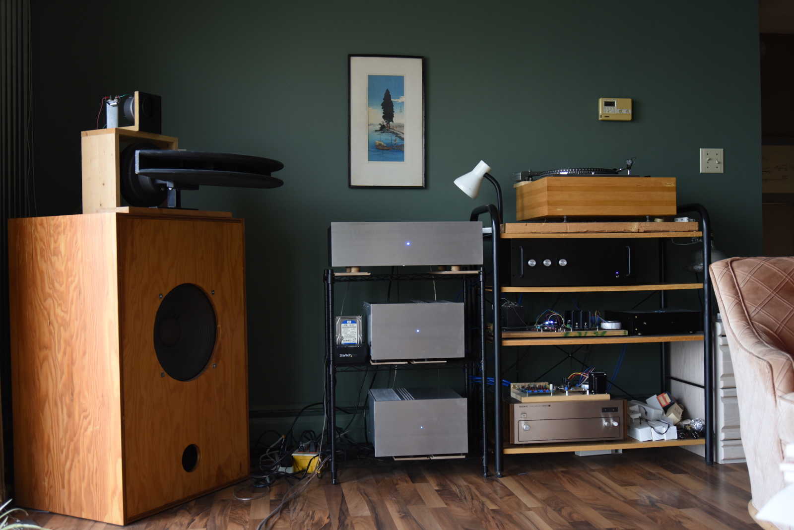

Now, my amplification chain is totally VFET. I run a biamped system with a 2SJ28 L'Amp 193V for the top end and BAF2015 THF-51S amps for the low end. VFET heaven!
Another great Rothacher design. Thank you, sir.

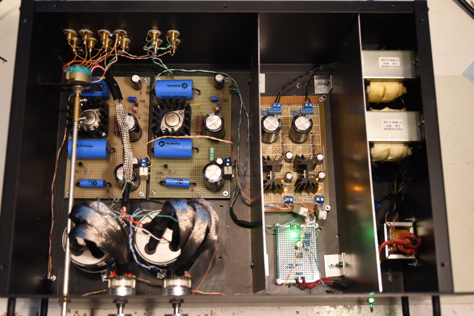

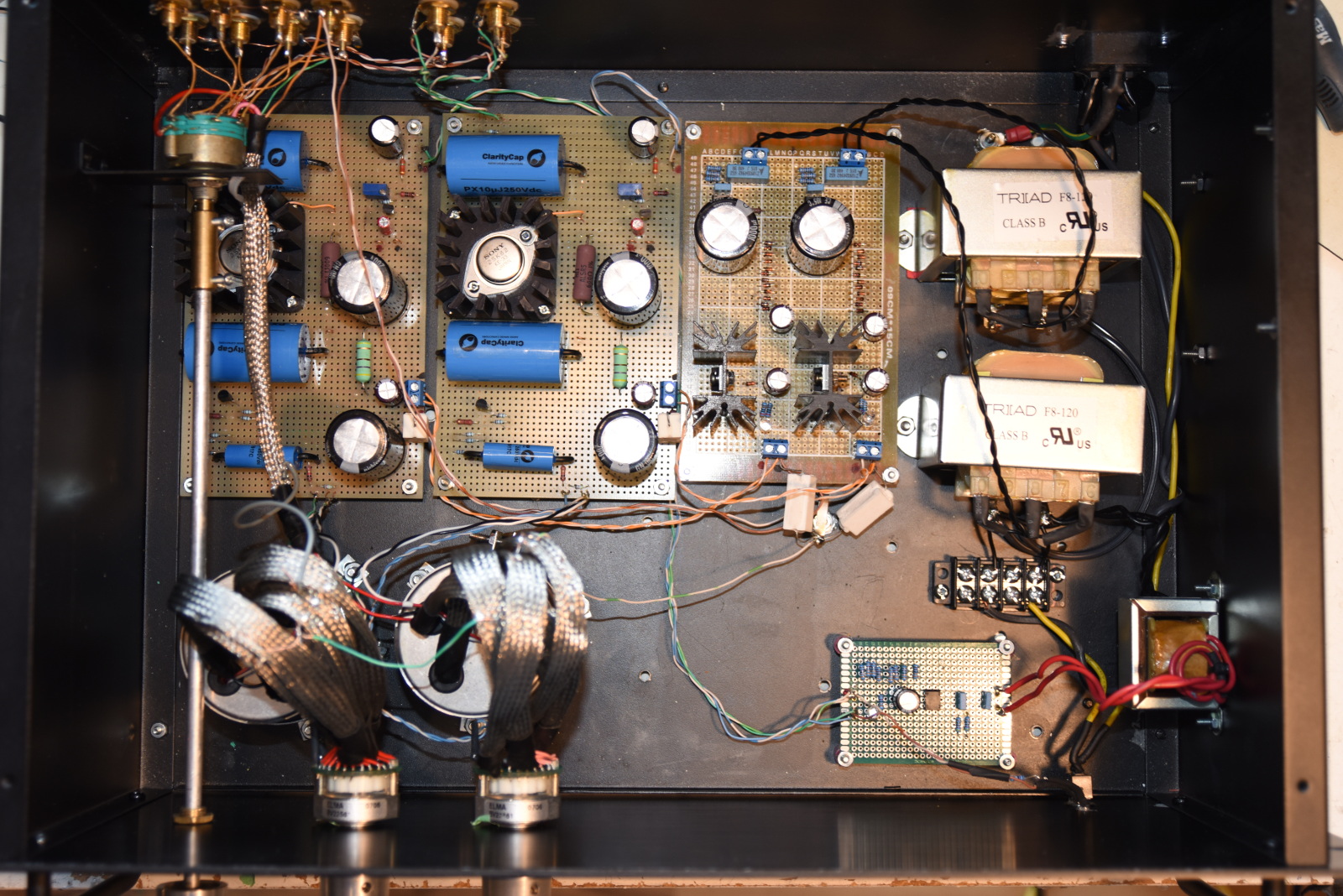

I've been listening to my LuminAria for about a week and I am not missing my 01A tube preamp at all. One thing I really don't miss at all is the tube noise, the hiss and slight hum. The LuminAria is dead quiet even with my fairly efficient speakers. I can't hear a thing with my ear right up against the speakers.

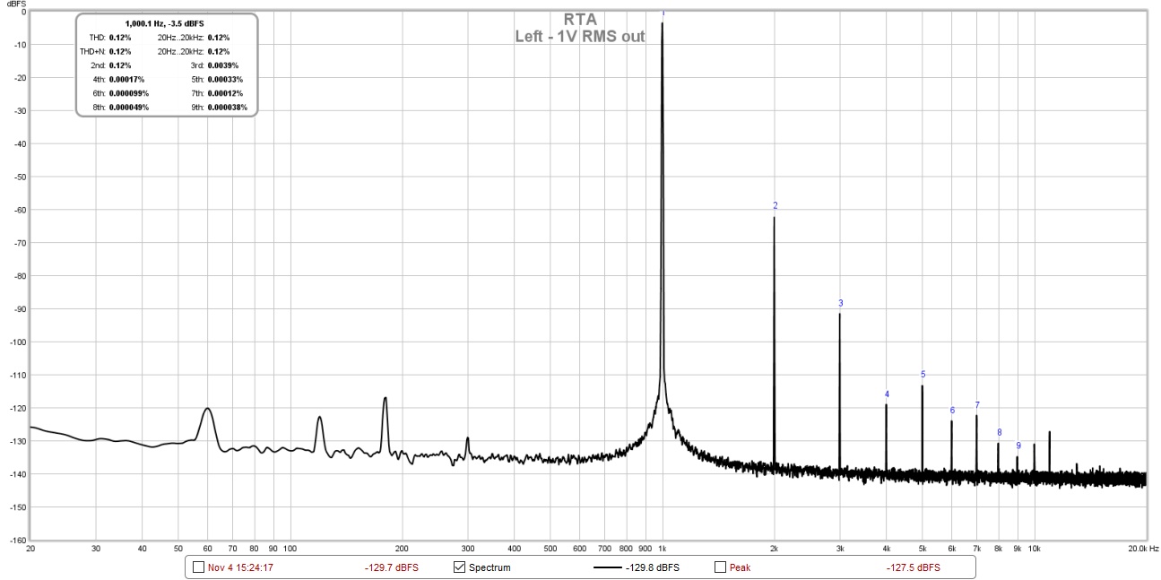

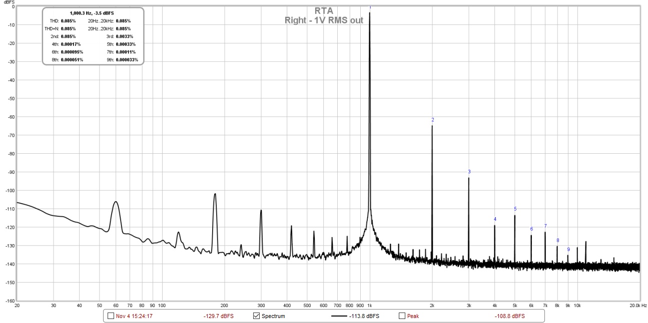

When I measured the LuminAria's distortion last week, I noticed that the right channel was noisier than the left. Even though it was not apparent when listening to music, it bothered me. That's the problem with measurements, sometimes.

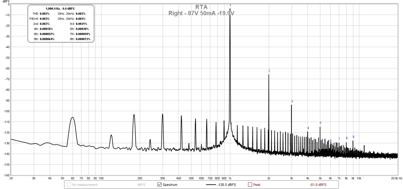

So, after analyzing the situation, I decided to relocate the two large transformers and add some shielding. I installed 22 gauge mild steel sheets between the transformers and the power supply boards, and also between the power supply boards and the preamp boards.
As a result, the 60 Hz and harmonics have decreased greatly on the right channel, although it is still noisier than the left. However, I'm not going to worry about it anymore. Time to listen to more music.
