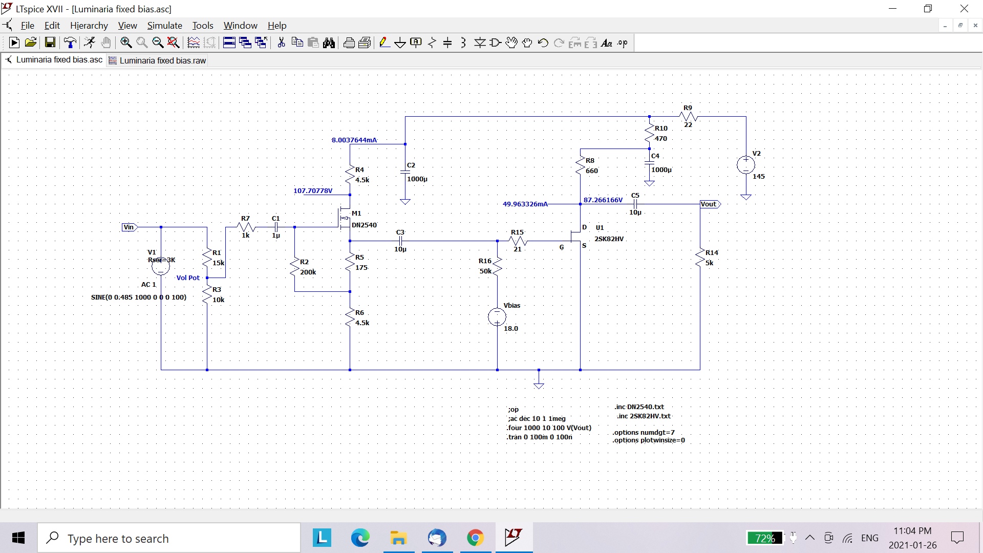

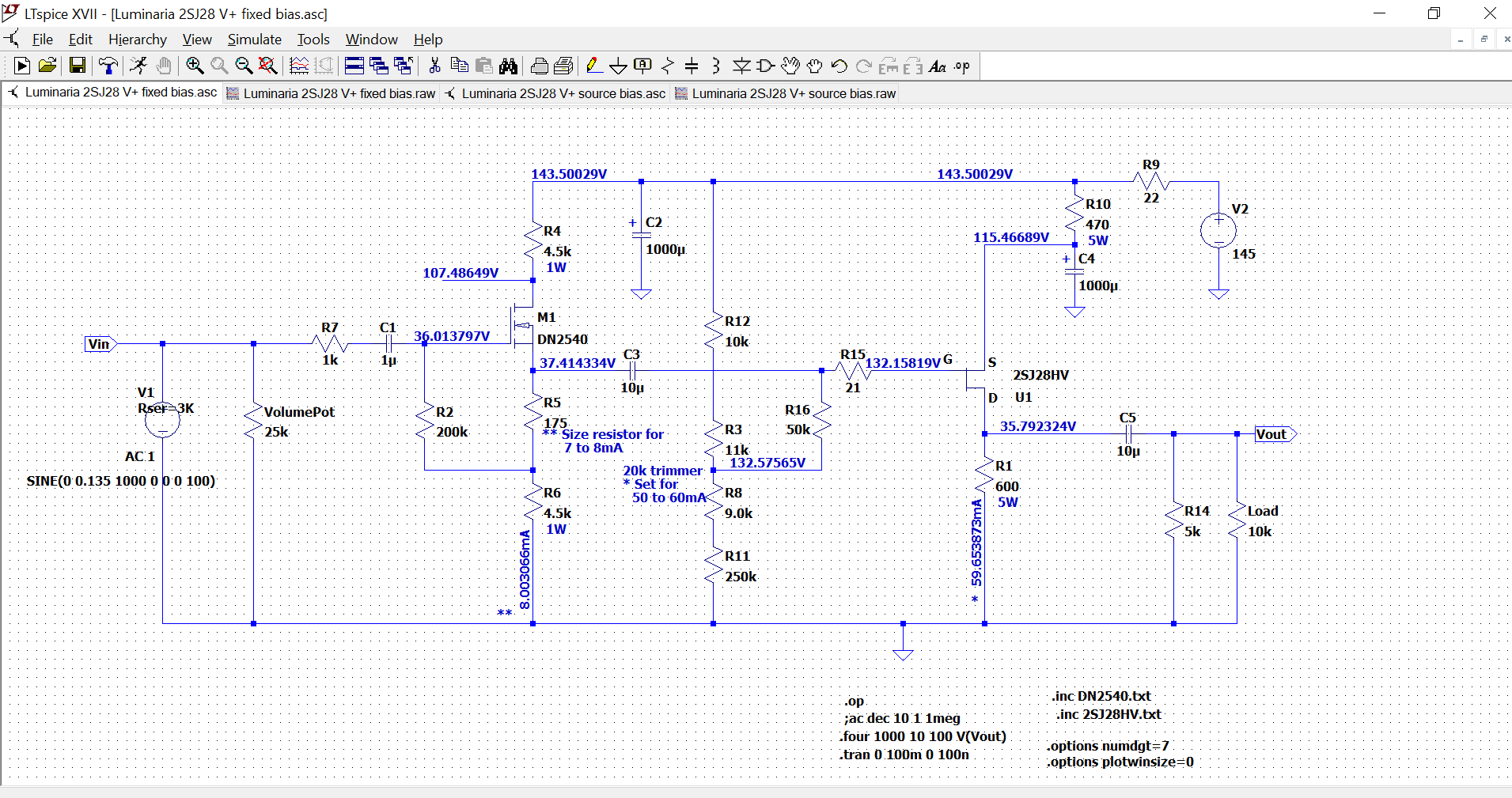

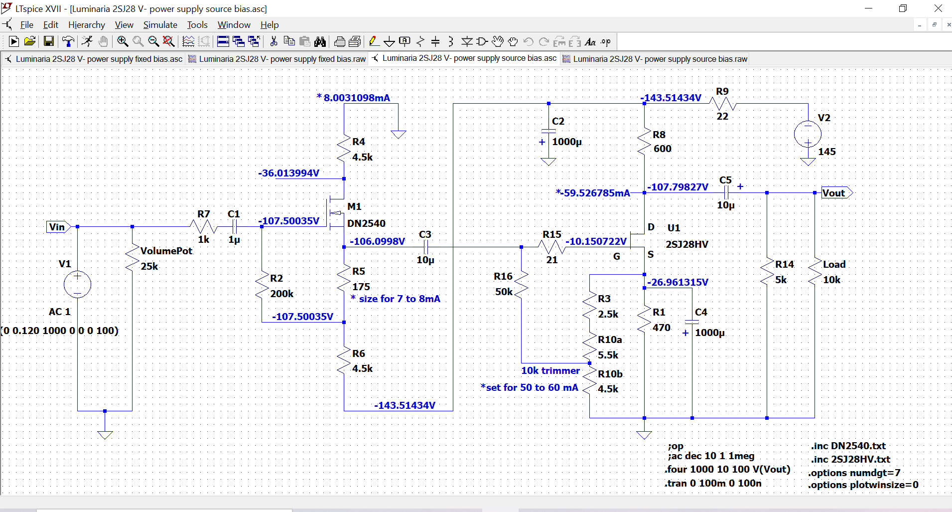

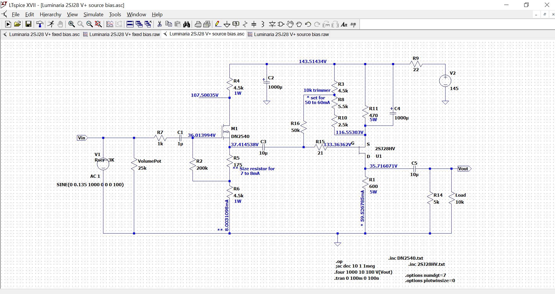

I know 2SK82s are hard to find now but perhaps people still have 2SJ28s. So I was playing with LTSpice and modified the Luminaria circuit to accommodate the 2SJ28. It worked in the simulations, so I expect it to work in real life. Comment and critique if you see issues - I'm not an expert.
I hope that it will help others to enjoy the sounds of a Luminaria preamp, and also get some 2SJ28s out of Greedy Boyz's stashes.
One plus of the 2SJ28 is that for fixed bias, a separate bias supply is not required when overall power is provided by a V+ supply.
