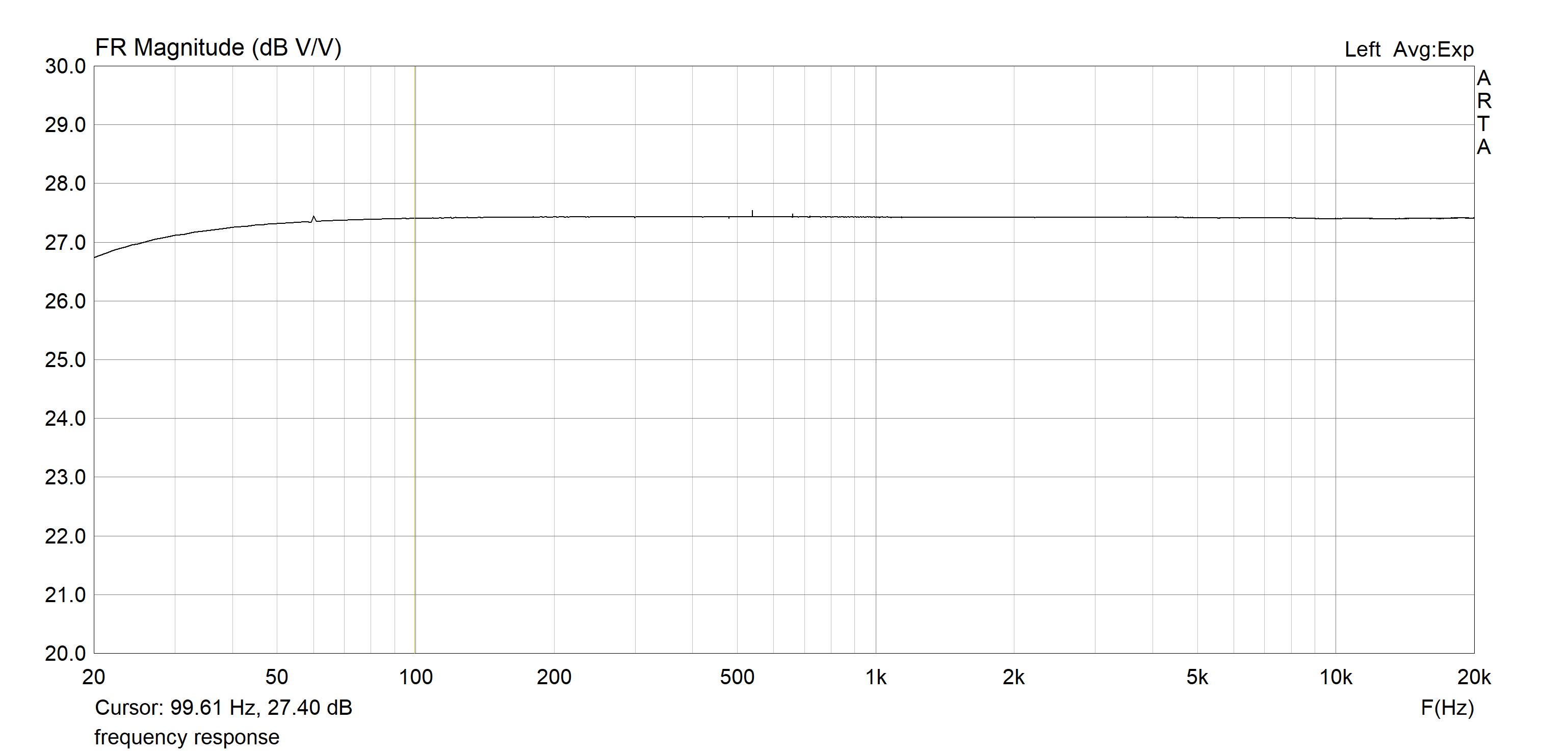

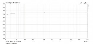

I did run a few measurements. Getting flat out to 20 kHz. I undersized the input cap because of what I had on hand, so it is about a db down at 20 Hz. I too am getting second dominant and a good bit of it, about -60 db, though I failed to check the Vout at that level. Will do so later.

Yes, your low frequency response does need a boost.

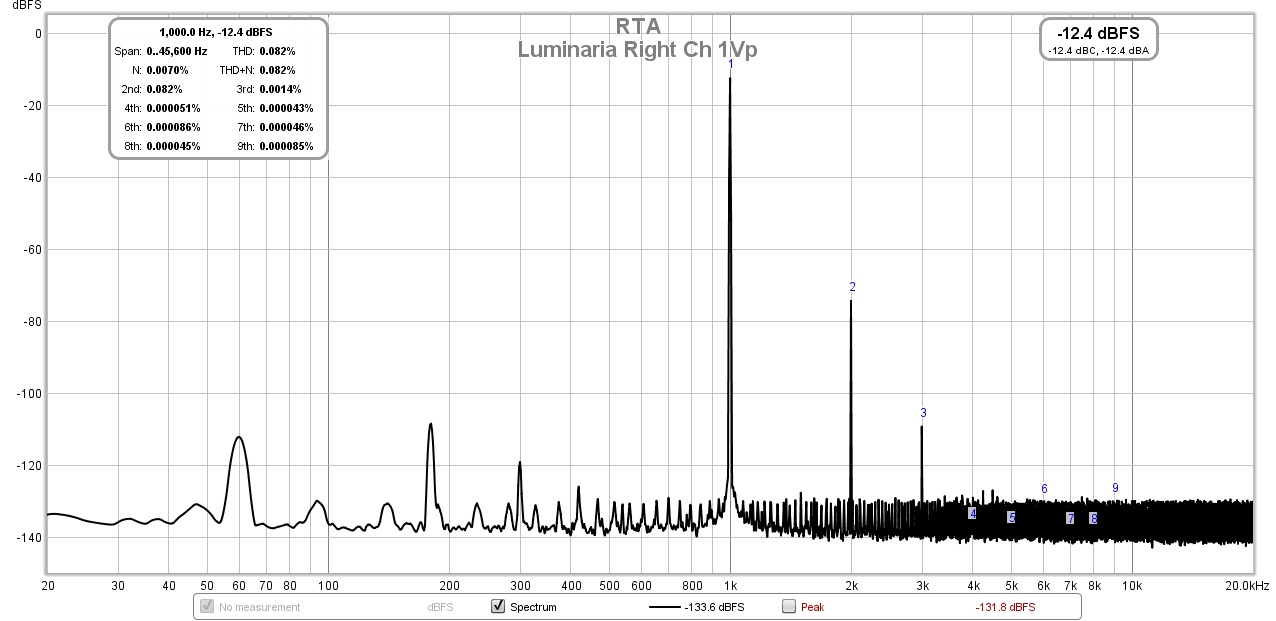

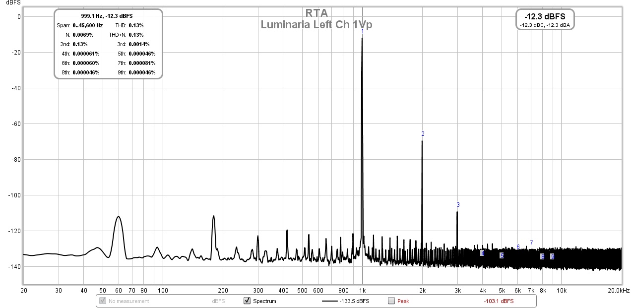

Too much distortion is audible and can be grating to the ears. But I think it needs to be much higher than -60dB to be bad sounding.

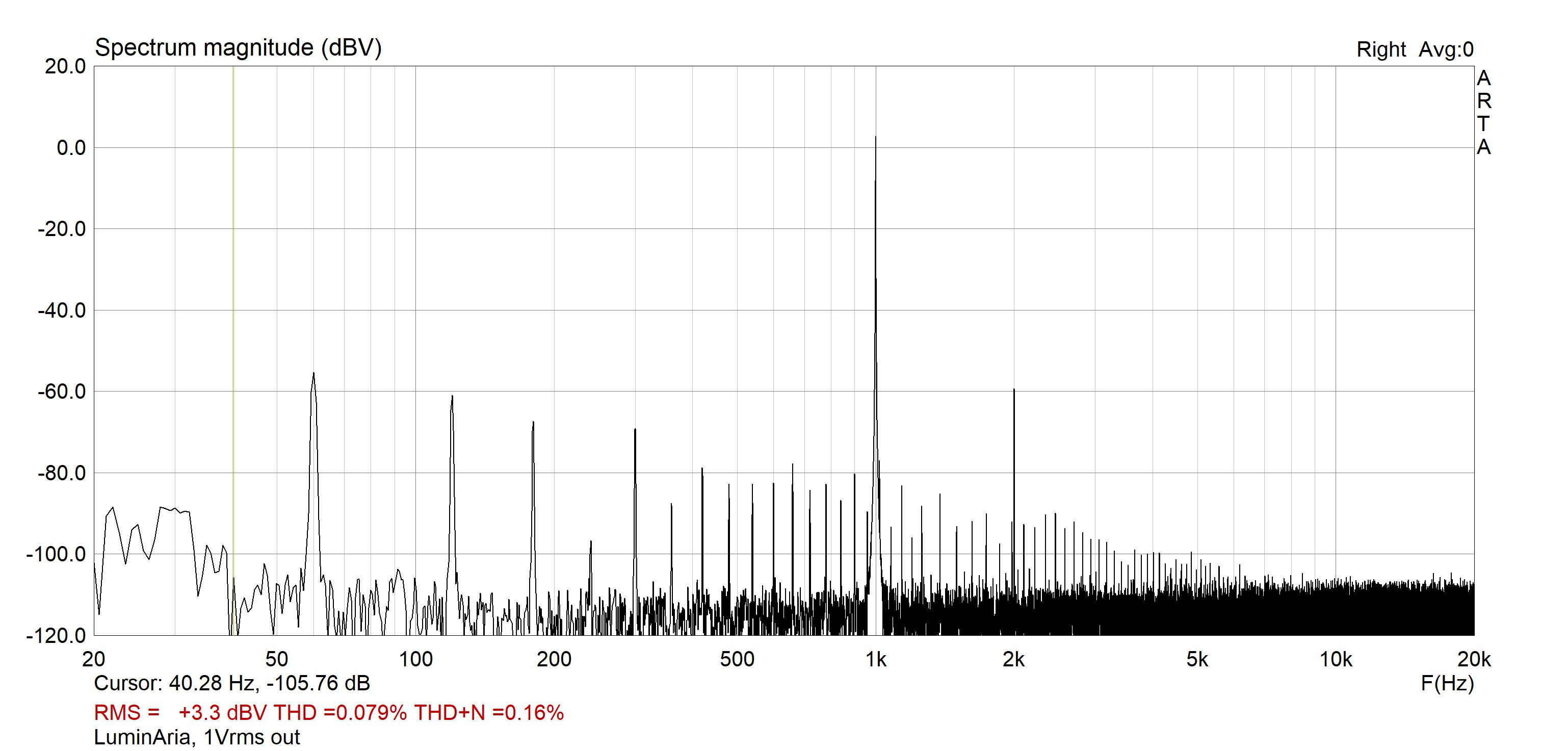

Here is the my Luminaria's distortion 1.0Vp output (approximately -60dB):

Okay, on to the measurements. It is not really that far off on the low end. One db down at 20 Hz is fine with me. I knew I was going to get that with a small cap.

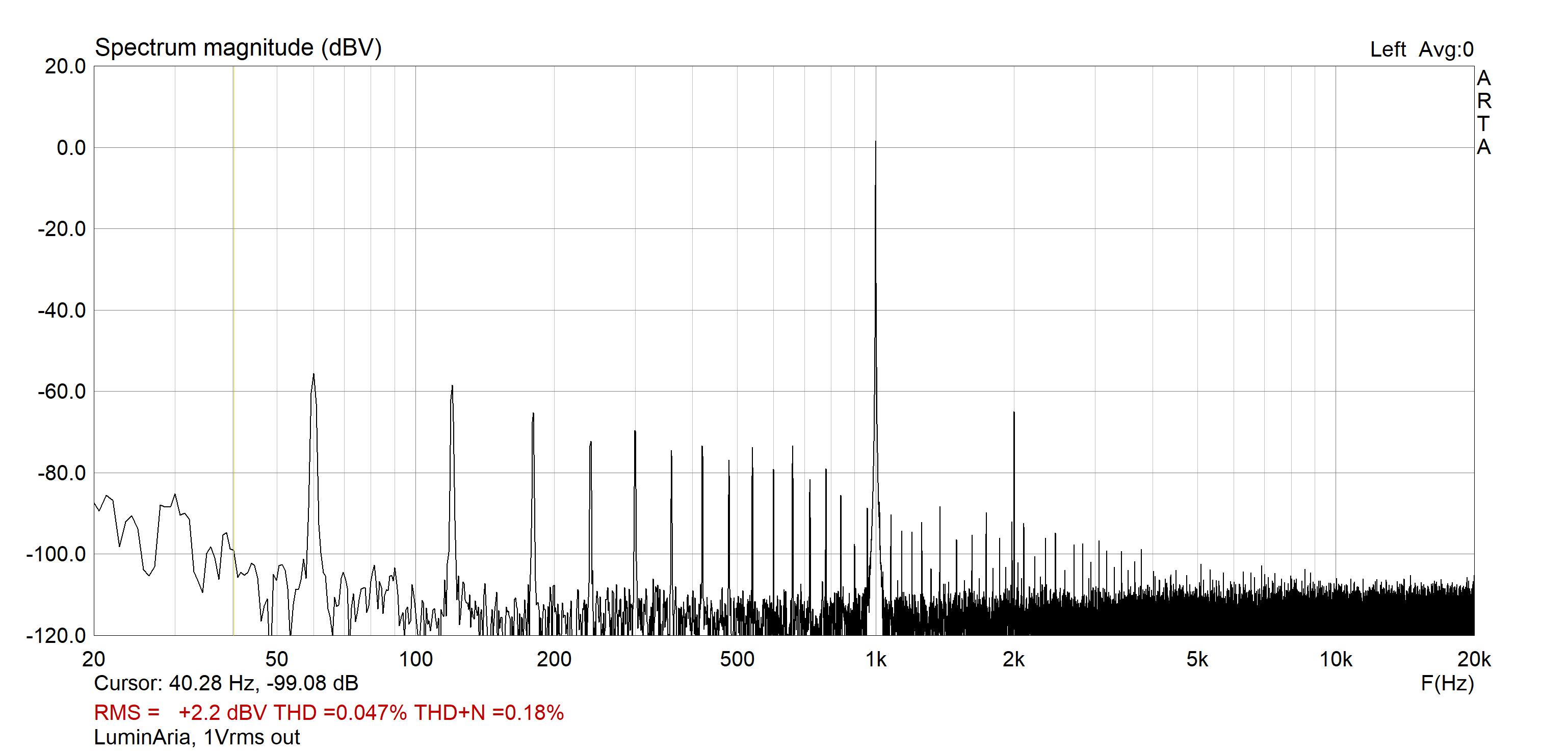

THD at 1 kHz looks similar to yours. Not a problem there, except the PS harmonics.

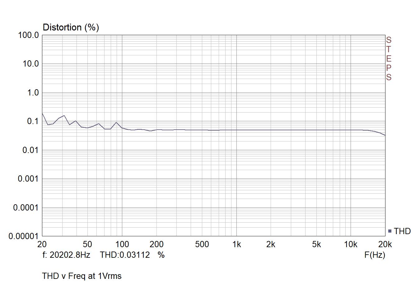

THD versus frequency at 1Vrms (higher output than 1Vpk) looks pretty decent also. Now, the problem might be above 20 kHz.
