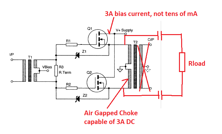

With a balanced design it would look like Susan Parker's Zeus (Audiophonics -).
Because she used lower transconductance power mosfets (also depletion type IXTH20N50D), the output transformer has a step down ratio.
Another, and one the best commercial solid state amps I auditioned is the Grandinote Shinai, following the same design principle: class A with high power bipolar emitter followers loaded by a center tapped autoformer (no step down). This one does not have output coupling capacitors as the + and - output have the same (low) DC potential.
The same could be done with a pair of LU1014D's (or more pairs...).
To get some 20 watts of output power each LU1014D would have to dissipate 20 watts, no idea if that is realistic as it is a tiny device.
10V supply (only one positive supply needed) and 2A of current you'd reach almost 50% of efficiency.
"Descending harmonic distortion profile" is not a holy grail IMO; distortion profile of the Zeus amplifier looks excellent as well.
Here is Susan's explanation of the topology:
Neither MOSFET turns off at any time (during normal operation) so there is no Class B bit, however this isn't the same as my understanding of normal Class A operation where lots of power gets disapated all the time.
My amps quiescent is low and the heatsink is correspondingly small, being barely warm to the touch when idle. Of course it warms up a little when in use. The only time it has got seriously hot was when making power measurments and driving full peak to peak sinewaves into an 8 ohm load.
An inportant thing to understand is that the output transformer's primaries swing negative as well as positive and the MOSFET for the half of the cycle which is negative is still powered but "idles" with most of the current flowing through the MOSFET going positive. However the negative arm MOSFET "WILL" regulate if something tries to overrun the main positive arm MOSFET position.
Make of it what you will, but I don't see a hot running always-on SE Class A amp with the choke serving to provide reactance to double the output. The output is doubled because it is a balanced (like a BTL) output. The output is transformer coupled not capacitively coupled. Depending on the winding ratios, it could have voltage gain from the transformer.
attachment.php
Maybe if the Zeus was modified to this, it would be similar. This requires:
  • Air Gapped DC Choke with center tap or two regular ones in series with common tied to GND
  • Increase bias current to always on 3A vs miniscule tens of mA
  • Capacitive coupled outputs at Source of MOSFET not transformer coupled outputs.
OK, after you edited:
When making the LuFo balanced, you will use a center tapped choke; the DC currents cancel.
This is exactly how the Zeus output stage functions; no matter whether you bias for class AB or rich class A, the DC cancellation remains and does not make an air gap necessary.
So you could bias a push pull LuFo class AB or whatever.
Instead of output coupling capacitor(s) you could use an output transformer with secondaries; Susan had to (with step down) in order to load the mosfets appropriately.
1014's are very high transconductance so you don't need step down, and then a choke / capacitor combo is an option; 1:1 output transformer would work equally well.
The output coupling cap can be calculated to create the correct high pass when for example driving a tweeter and will be higher quality than the 4700uF or so electrolytic required for full range.
