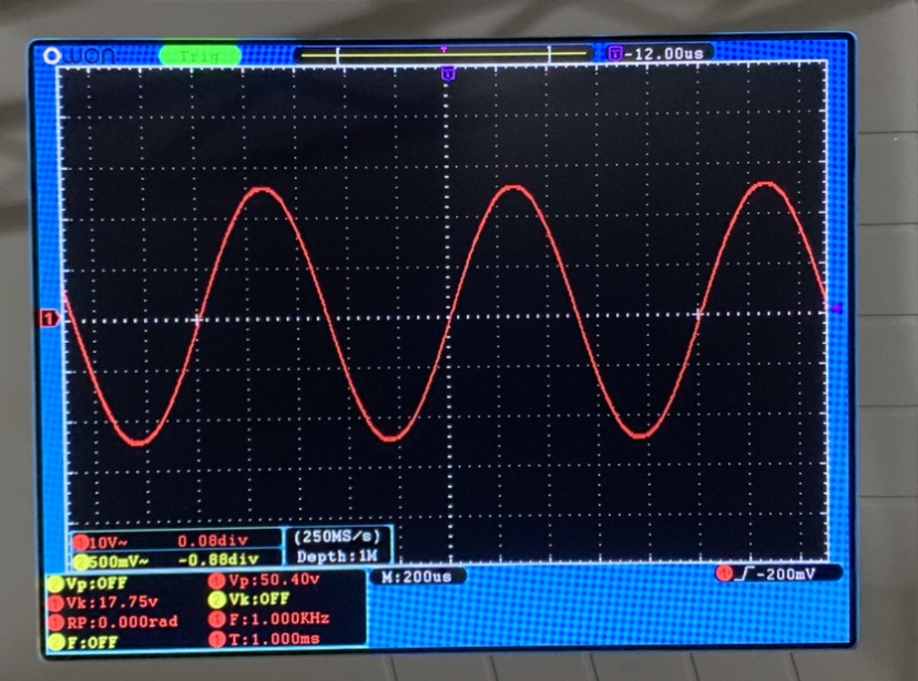

I guess we have to see what the Vpp is at 20Hz vs 1kHz into an 8ohm dummy load. Although that’s HT bass, I think the majority of bass we need for dynamics is kick drum which is centered around 50Hz. 20Hz is artificial flappy bass. Unless you listen to cathedral organs, very few instruments make music down below 40Hz.
My gain stage was a discrete SE Class A affair using 55v single rail. I don’t think you need 100vpp.
Take a look at OPA454. $6 part with nice specs (+/-50v) and give it say +/-35v should do the trick.
Sorry, I screwed the math. 17.7V RMS is 25Vp or 50Vpp.

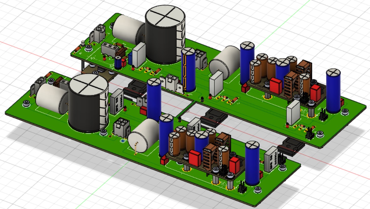

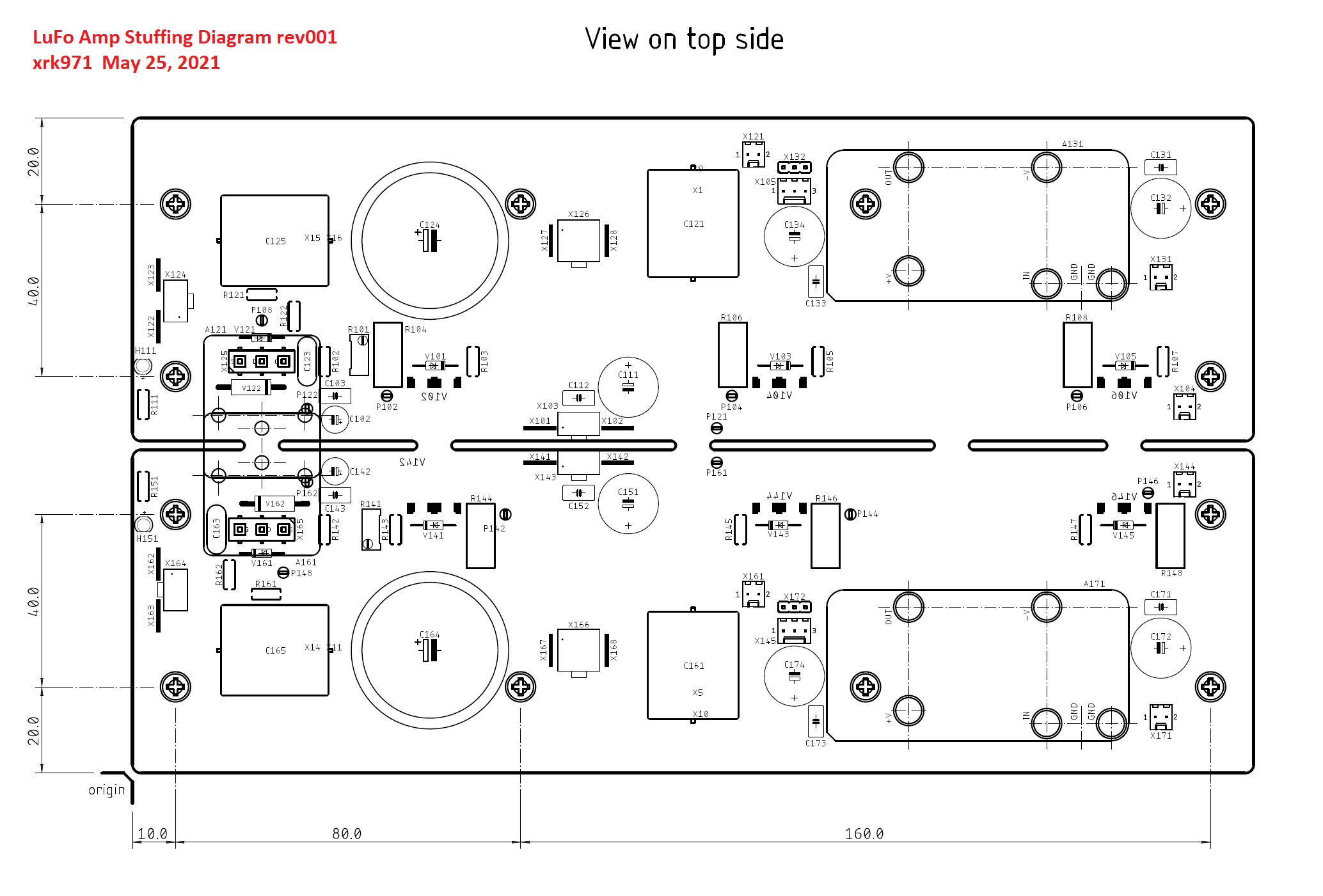

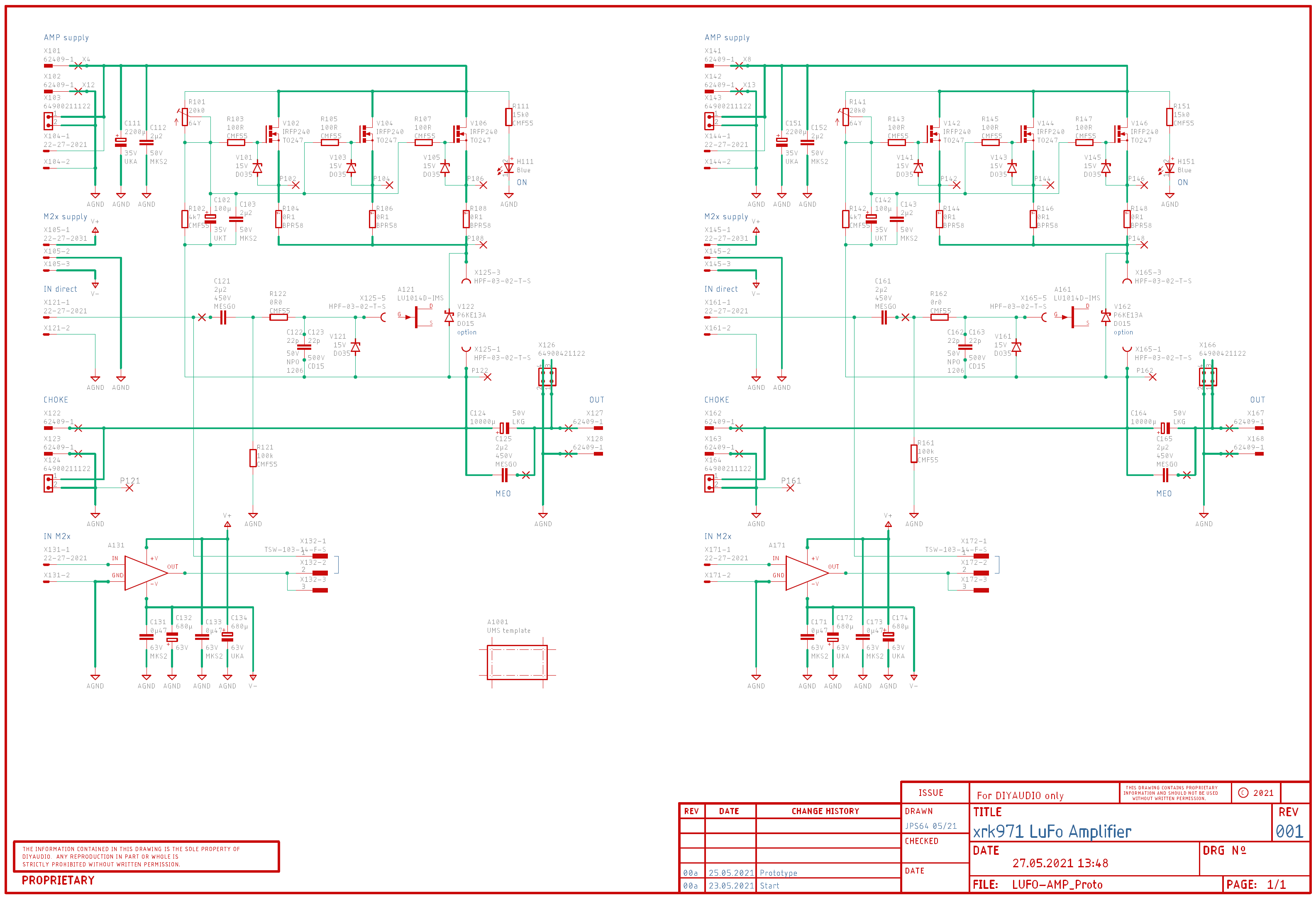

Here is the latest LuFo amp schematic that corresponds to the prototype PCBs that have been placed. I have added an (optional) TVS protection diode across the JFET drain-source to protect from any transient above 18v (clamping voltage). The boards are made in mirror symmetry for Left/Right channels. JPS64 tells me that there are 21,000 via drill holes to stitch the two sides together!
Stuffing Diagram:
3D render of both boards (panel size is 260mm x 152mm):
The BOM is in a zipped Excel file below.
Stuffing Diagram:

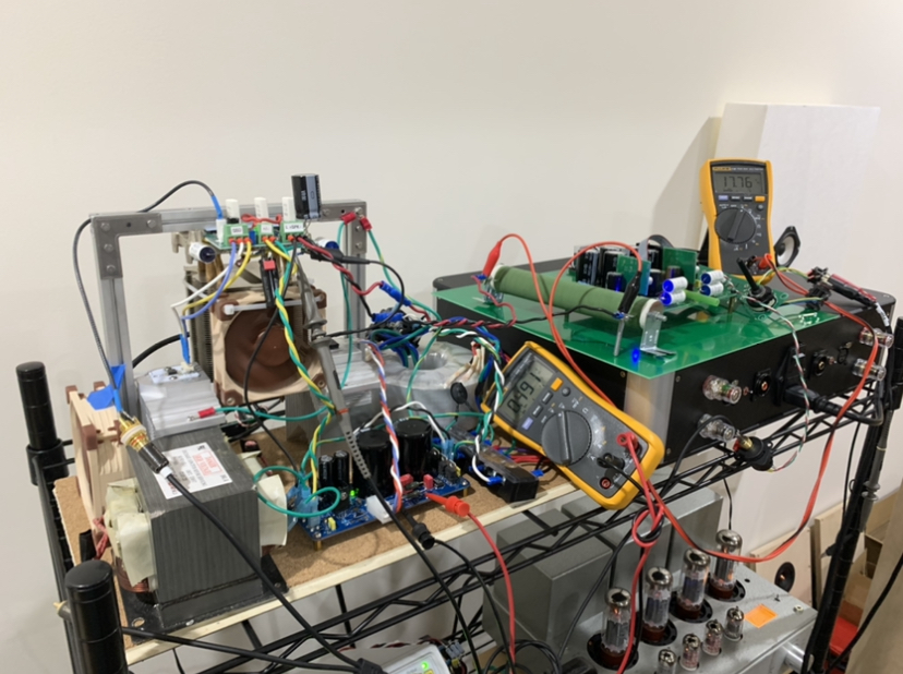

I ran the LuFo with the new LD1014D at 39.5w for a full 30min. No problems and works like a champ. Here is new setup on my front of the house amp rack so that I can listen to the LuFo on my main 10F/RS225 TL speakers. The stress test was on the 100w wire wound dummy load resistor (green cylinder on top of the large green PCB). I even took it to 6A bias current for a few minutes to explore possibility of driving 4ohm loads. With a fan on the LD1014D heatsink it was no problem.

Fantastic work here Fellas! Love the mirror image pcb layout.
Looking forward to building LuFo 😉

Well, I have CPU coolers and fan to extract 150w from the 3 MOSFETs and 20W front the JFET. I can employ the currently unused secondary from the power trafo and connect it in parallel to extract more current. Crank up to 6A and see what it sounds like. It already sounds gloriously powerful and smooth. Could it get better? Sure. 😀

Well, I am playing the amp at 6.0A bias current and maintaining 28.1vdc at the amp supply now with both secondaries of the the 400VA trafo being employed. (This says that if running 3A bias current, a single 400VA trafo should be enough for a dual mono stereo setup). I decreased the resistance and increased the power dissipation of the CRC resistor by using 4x 0.33ohm 3W Vishay in parallel. With two in parallel the resistor was hitting 190C, now running at 104C. Music sounds good! Temp of LD1014D body is 54C and air blowing out of CPU cooler for the three MOSFETs is 50C - fan speed kicked up a notch with the auto temp feedback speed of the PWM controller doing its thung.'
The amp is still absolutely silent with no music playing. Quiet as in you cannot tell it is turned on with ear pressed to speaker cone. The DIY Sony VFET amp is also like this but uses a SMPS whereas here this is a linear supply.
