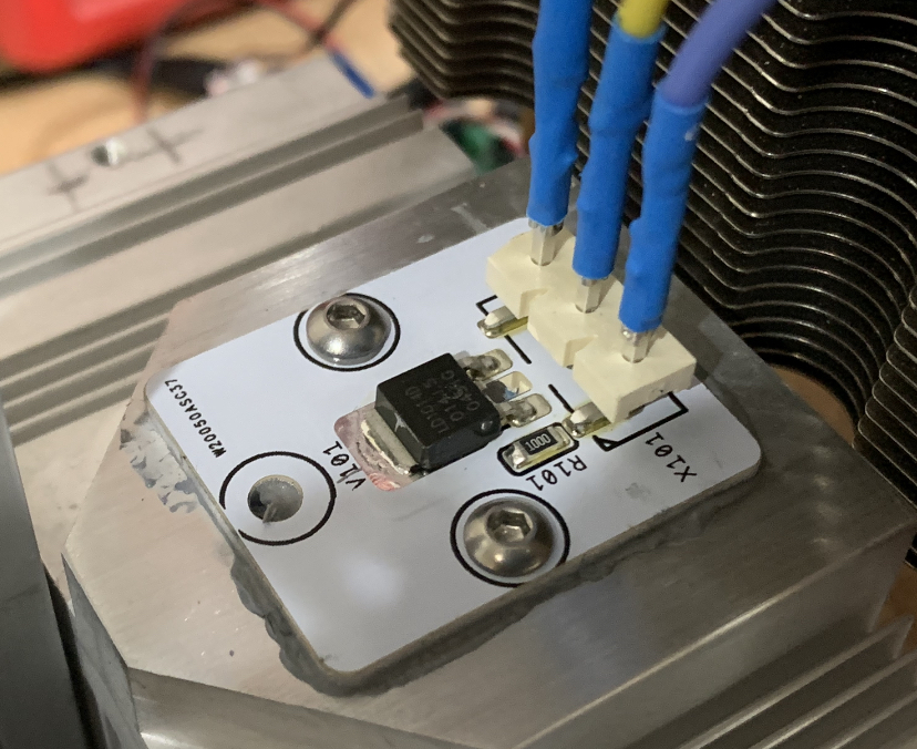

I just got a shipment of AliExpress LD1014Ds. They are so easy to solder into the adapter boards. I installed and tested. Works fine. Bias current is stable and music sounds good.
This is where I got mine from. The price is amazingly low - so the risk is low in the event they do not turn out to be real. But the ones I got seem to be the real deal.
