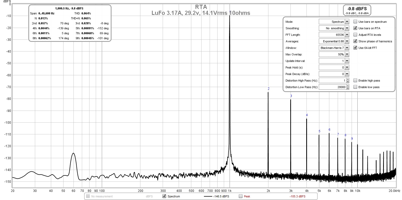

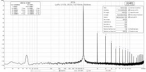

Another data point for 14.1Vrms into 10ohms - about 0.06% THD:

I have a feeling that the very low noise is a very good PSRR AND a SLB regulator; you could probably run a simple CRC and it would be very quiet.
Outstanding harmonic profile, and very low THD, although H3 is a bit close to H2, a characteristic of many semis. But an excellent amp and very good measurement technique.
OK at high volumes? Should have very low congestion with busy music because there is no complicating feedback.

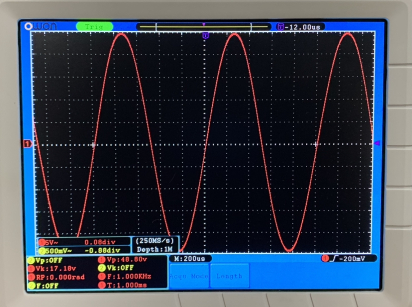

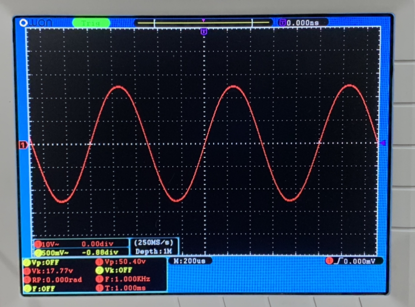

I am not sure if this was what you were all waiting for - is a 39w amp with a cheap salvaged choke made from a microwave oven transformer and 28v single supply possible?
The specifics are: Vsupply of 27.3vdc, voltage as LU1014D was 1.527v, bias current was 2.90A, and Vrms according to the Fluke 116 was 17.77vrms. The Oscope shows 17.77Vrms as well. That’s 39.5wrms into 8ohms - well before clipping starts. One interesting thing to note is that backing off on the bias current to 2.9A yields better clip performance than 3.0A. Not sure why, maybe combination of voltage sag on limited voltage from time of day max voltage of 27.3v vs 28v nominal.

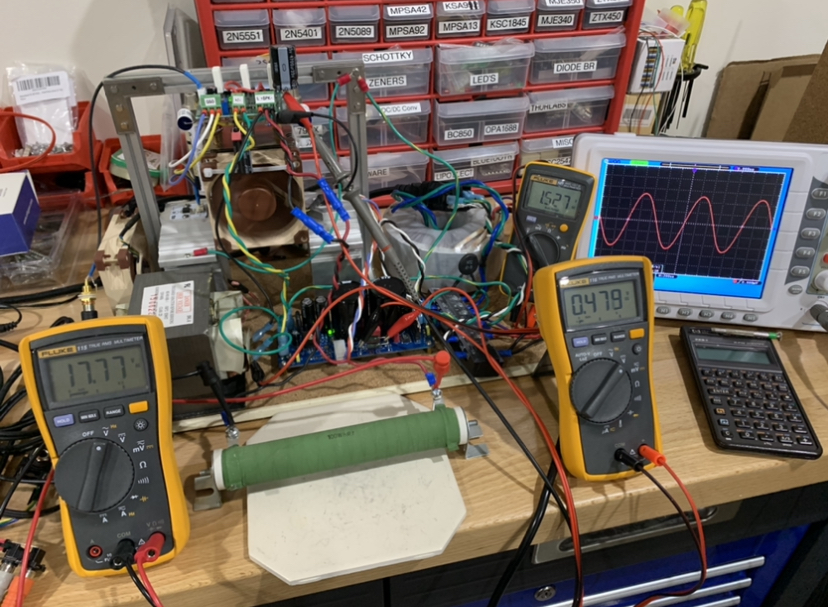

In the photo of setup and you can see the big green wire wound 8ohm dummy load. The 8ohm wire wound is not good for distortion measurements but adequate for max power. Fluke meter on left is Vrms of the output. Fluke meter on right is voltage across the R (0.165ohm) of the CRC, yielding 2.9A current. The smaller Fluke meter in back is the Source voltage of 1.527v setting.
There you have it, a cheap MOT indeed has the guts to belt out the predicted 39 Watts from a LuFo amp.

Looking at the waveform, there may be a small amount of compression setting in. Still not clipping, just some compression. The positive peaks have a different shape from the negative peaks. Probably sonically unobtrusive.
I’m sure you are right - if I back it off to 17.1vrms, it looks more symmetric.
