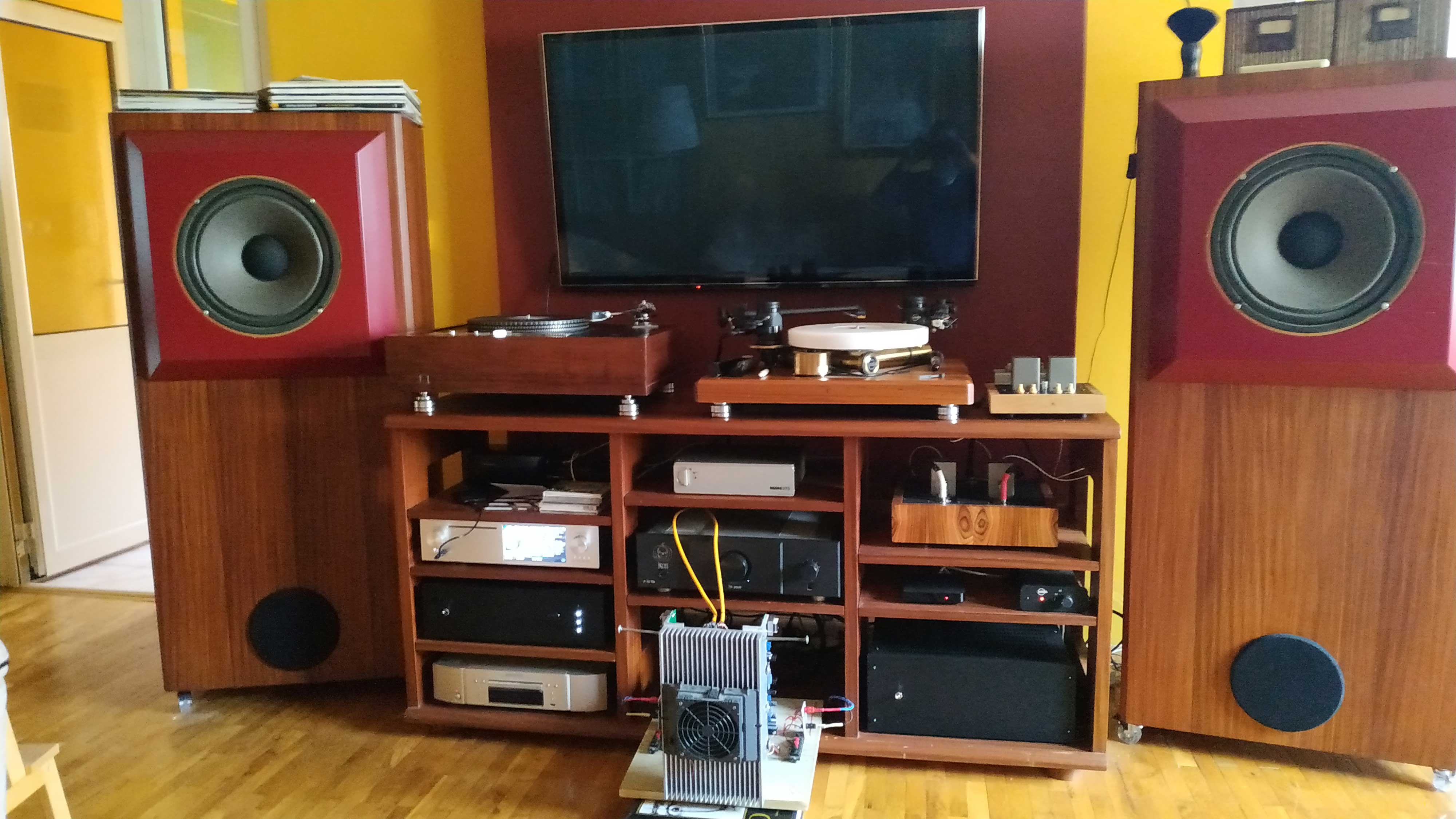

tomorrow I'll get LuDEF to my friend Woland , to whom ears and brain I always trust ......... ......
preliminary and still not-so-detailed string of information from my Official Second set of Ears..... I got Goodness Approval 🙂
compared with reference (SissySIT) - no drawbacks, same character, little more detailed, Foot-tapping factor not disturbed
good enough for me
I did keep the picture for my wife... my desk is quite clear compared to this one...Now I see why ZM was photographing my bench when he was here.
She will never again ask me for wiping this out!!
- LuDEF
