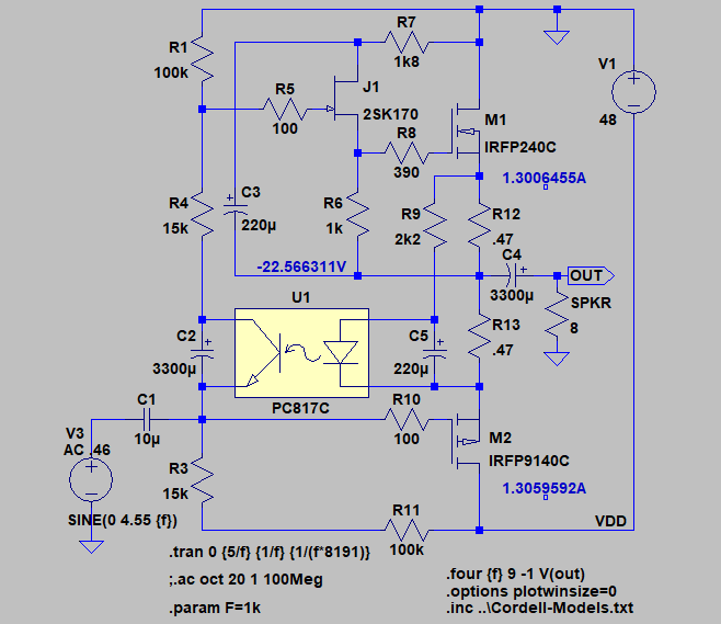

Is it mandatory to measure the current on both +and - rail? Couldn't it work with only one opto coupler in the positive or negative rail?
I bet the answers would be two No, No.
But for this particular LuDEF, the answers could be Yes, No.

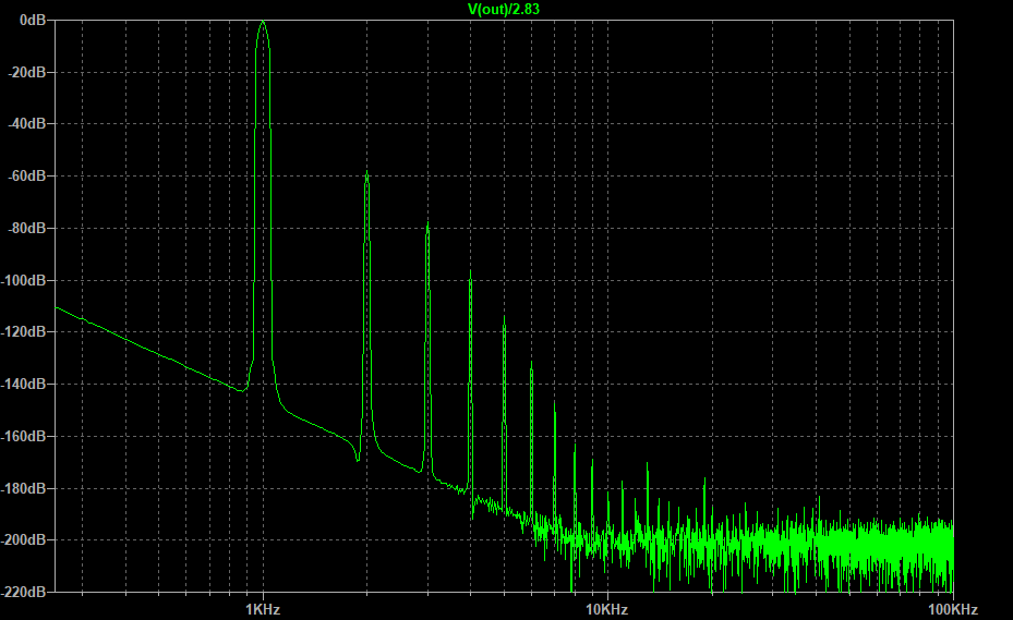

How do you like this output stage? Spice predict neg phase H2 with H2/H3 >20dB.
Code:
Harmonic Frequency Fourier Normalized Phase Normalized
Number [Hz] Component Component [degree] Phase [deg]
1 1.000e+03 4.000e+00 1.000e+00 0.33° 0.00°
2 2.000e+03 5.050e-03 1.262e-03 92.85° 92.52°
3 3.000e+03 4.206e-04 1.051e-04 1.99° 1.66°
4 4.000e+03 9.427e-05 2.357e-05 -140.21° -140.53°
5 5.000e+03 6.728e-05 1.682e-05 -179.65° -179.98°
6 6.000e+03 4.960e-05 1.240e-05 178.80° 178.47°
7 7.000e+03 4.230e-05 1.057e-05 -179.94° -180.27°
8 8.000e+03 3.716e-05 9.289e-06 -179.90° -180.22°
9 9.000e+03 3.304e-05 8.261e-06 -179.95° -180.27°
Total Harmonic Distortion: 0.126718%(0.132002%)
of course possible, but better having same "additional" resistors in both rails; when having that, lets make everything else symmetrical, not just for sake of powering up/down cycles but for all phases in operation
do not forget that some of these wakoo amps are having unequal loading of rails in AC domain, especially SissySIT and future SET amp - up to clipping levels, two output parts are working one against other, speaker getting difference of currents, not sum, as in "normal" amps
as always when Mighty Indra is devising something, I like it 🙂
edit: I see that Pa spoiled you with his later time mischiefs - single rail, coupling caps everywhere
how's offset stability, temp/rail change?
Iq must be stable, huge reference

<3% Iq change @ 10% rail variation. Basically it's an ACA gain stage configured as a follower mated to a P-channel.how's offset stability, temp/rail change?

pc817 is of common variety, same as 4N25
I did found them being of decent current transfer ratio, decent uniformity, cheap
didn't tried any other in this prototyping, even if I have them
that's good 🙂
while we at it (anything
know for some decent P channel mosfet, preferably through hole T0-220-ish case, with Ugs in range of 1V5 to max 2V?
I did found TP2640 as best candidate, but taking care of T092 dissipation too much, never been my favorite activity....
logic level N channel everywhere, but P channel ones are hiding of me .....
