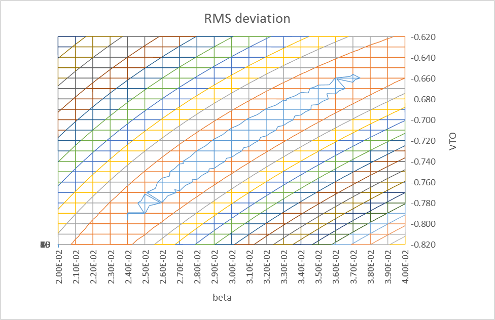

I finally got around to do a pedestrian version of measuring (Vgs, Vds, Id) tuples to characterise a given device.
I use a lab power supply connected to gate and drain of the jfet.
Between gate and source I put in various fixed resistors and measure the voltage dropped.
Vds = Vdg + Vgs and Id = Vgs / Rsource (or measure it directly)
With Vgd = 2 .. 10V and Rsource = 0 .. 1kOhm I cover Vgs from 0 close to -0.6V.
I can then fit the regular Id=beta*(1+lambda*Vds)*(Vgs-VTO)^2 by minimising the RMS differences between modelled and measured Id values.
What I want to share here is that the RMS difference minimum is very shallow along a step trough when you plot it along VTO and beta. The attached graph shows “iso RMS” lines (and some Excel artefacts) and you can see that you can vary VTO within a range on the order of 100mV and get a fit of almost equal quality if you adjust beta accordingly.
So much for reproducing fitted VTO values in measurements. You can basically pick a number for VTO (eg. Vp @ 1% Idss) and use beta for fitting. The quality of your model (in a range of Vgs = 0 .. -0.6mV and Vds = 2V .. 10V) will only be mildly affected.

Yep, to disambiguate between VTO and BETA you need to give higher weight to the linear region (VDS < 0.8).
Another option is: you can boldly declare, "I don't care about the linear region! My circuits will always operate the JFET where it is an excellent voltage controlled current source!"
The second candidate is especially appealing if your simulator doesn't provide Taki-equation models.

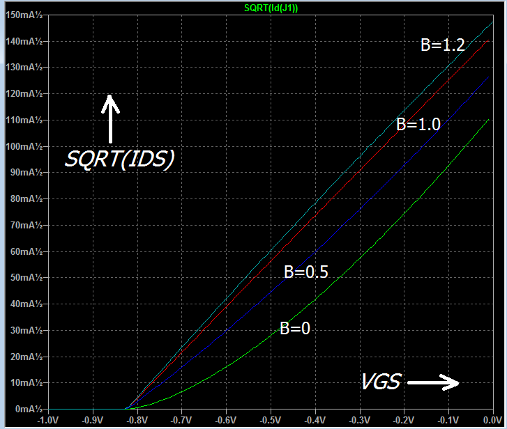

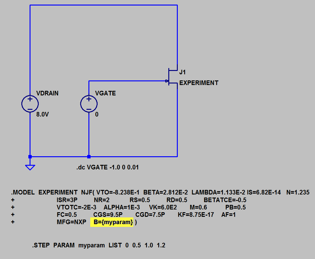

But the transconductance (hence gain) is a function of only beta and Id and I would think this is at least one thing you would want to get as close as possible. Using the value of Vto from the extrapolated slope of sqrt(Id) vs Vgs, taking care to get the portion of it closest to a straight line, will help you get the best fit to actual gain vs Id. If you're forced to use the basic model I would choose this. If you use LTSPICE you then can also correct for the slope not being 1/2. IIRC you might need the paper they reference in the users manual to compute B from the slope. Mark has a copy if he has the DVD collection. If it's one of the things they don't archive I have it.

Fitting a straight line to sqrt(Id) instead of fitting a parabola to Id basically amounts to giving higher weights to smaller Id values, doesn't it?
Or do you suggest this procedure to censor the data to give most relevant results?
If anyone could provide me with that paper (A. E. Parker and D. J. Skellern, An Improved FET Model for Computer Simulators, IEEE Trans CAD, vol. 9, no. 5, pp. 551-553, May 1990) I'd be grateful, b/c I would like to understand what LTSPICE really does.

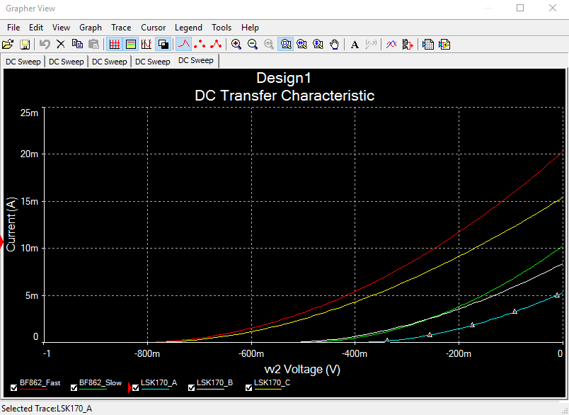

- LTSPICE models of worst-case BF862 JFETs
