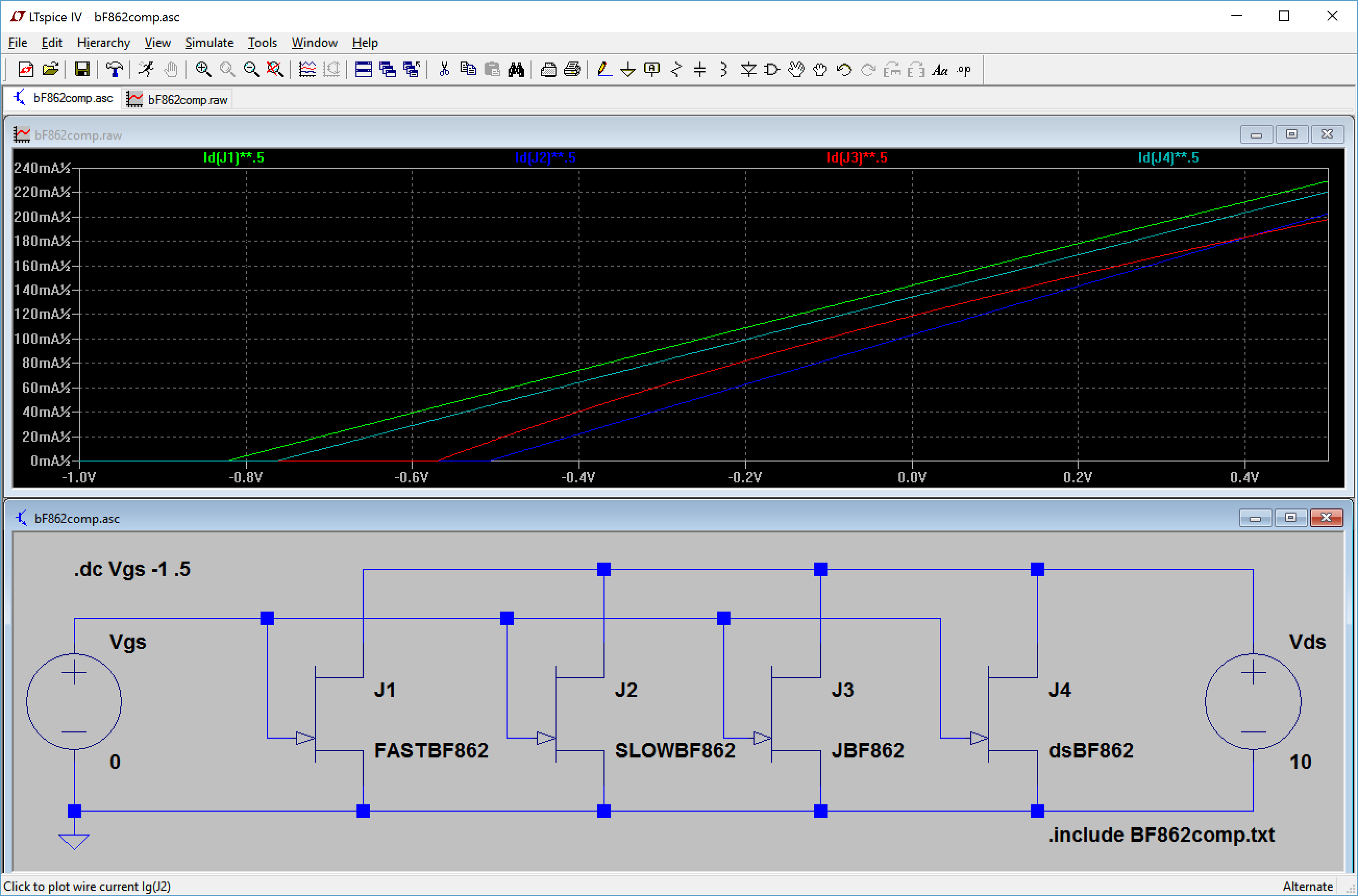

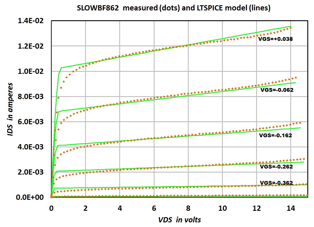

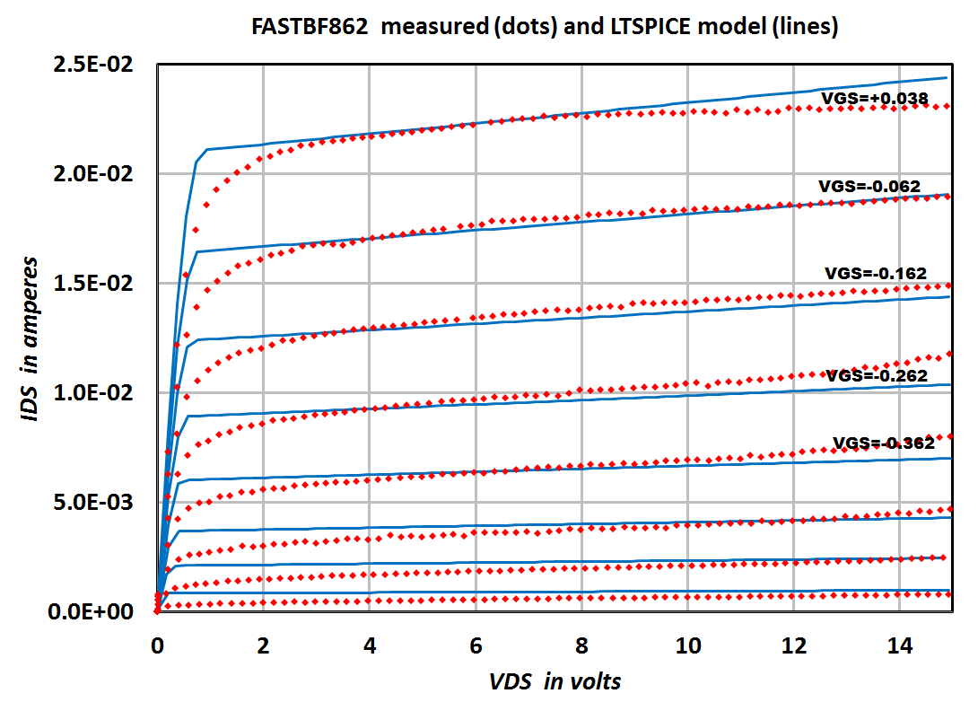

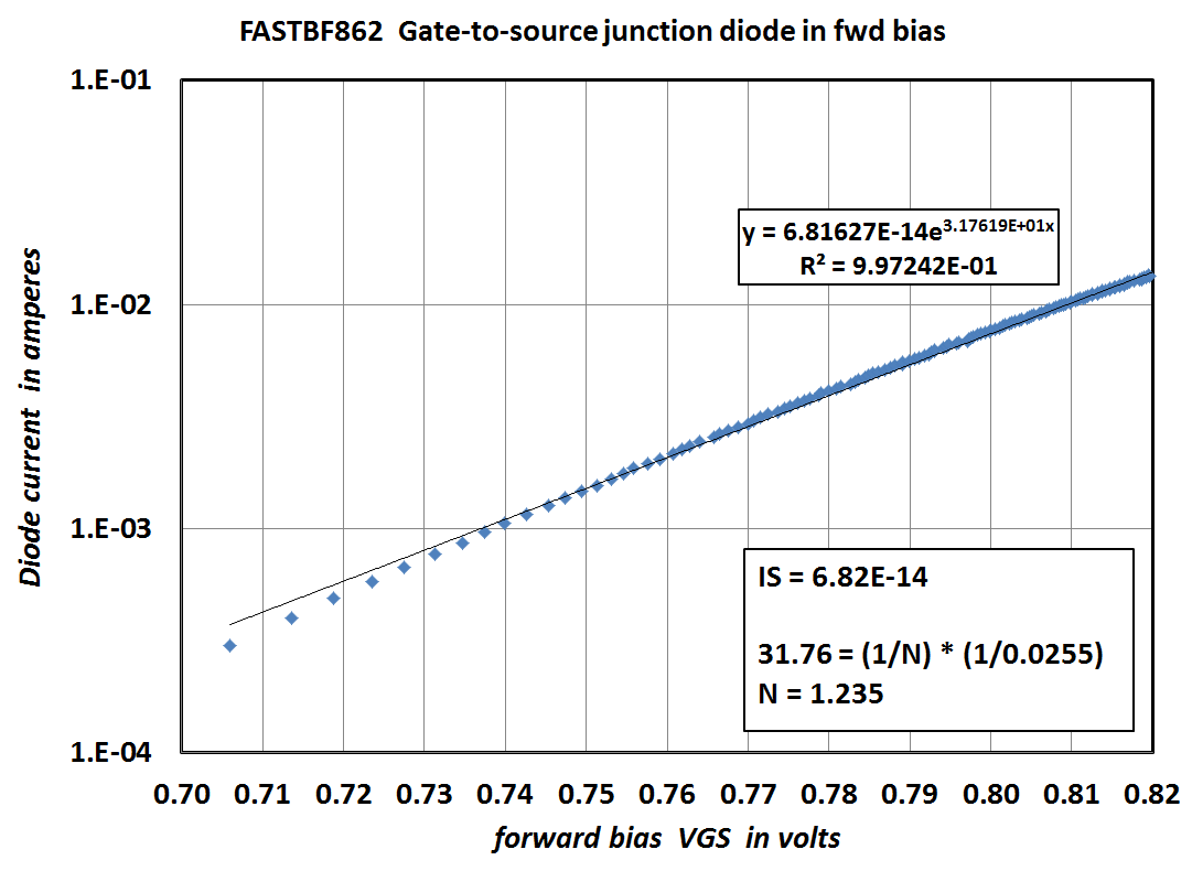

Hello, I'm sorry for resurrecting this old thread, but, lately, I've been investigating a little bit on various JFET Spice models, the ones included in LTSpice, the ones available at LTWiki and the ones available at InterFET website and, to my great surprise, I've discovered it is really really difficult to find a "trustable and reasonably accurate" JFET models, BF862 included (apart from the ones made by Mark Johnson, the author of this thread: they seems to be really well made instead!)
More specifically:
1) I discovered a good 80-90% of the models included in the default LTSpice jfet library have really high values (greater by a factor of 10 millions!!) for the Af parameter (exagerating flicker noise really a lot, example: J113), or, on the contrary, have Af = 0 (hence, as far as I undestand, ignoring flicker noise completely)
2) InterFET library, on the other hand, seems to suffer of wrong Alpha and Vk values, being a lot of the jfet in their library having Alpha = 1 and Vk=1 (that seems the default values for Orcad PSpice, while LTSpice default is zero for both)
This makes the drain current of their models hugely dependant on Vds, hence they behave more like a resistor/forward biased diode than a transistor! (at least in LTSpice)
I already reported the anomaly described in the 1) to AnalogDevices and LinearSystems: they generated a case for my request and are looking at it.
I reported the 2) to InterFET but they didn't give me any feedback yet.
On the 2) I would be really grateful to anyone who will be so nice to explain why and how Alpha and Vk parameters can have so much strong impact on the jfet model behaviour. On this matter, I found another BF862 model on DIYaudio forum, here:

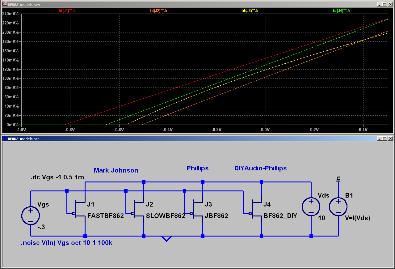

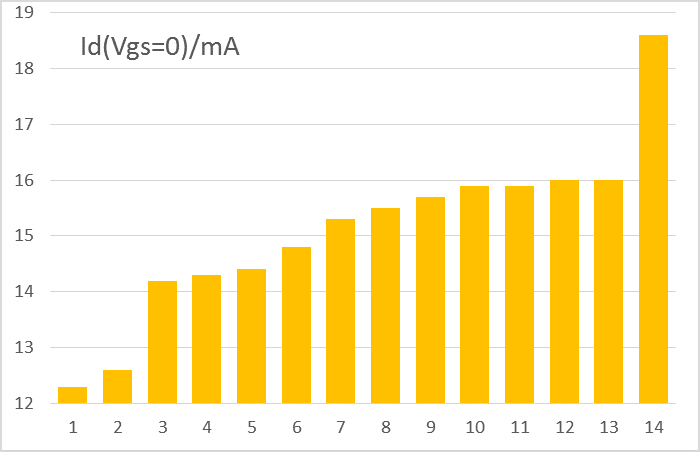

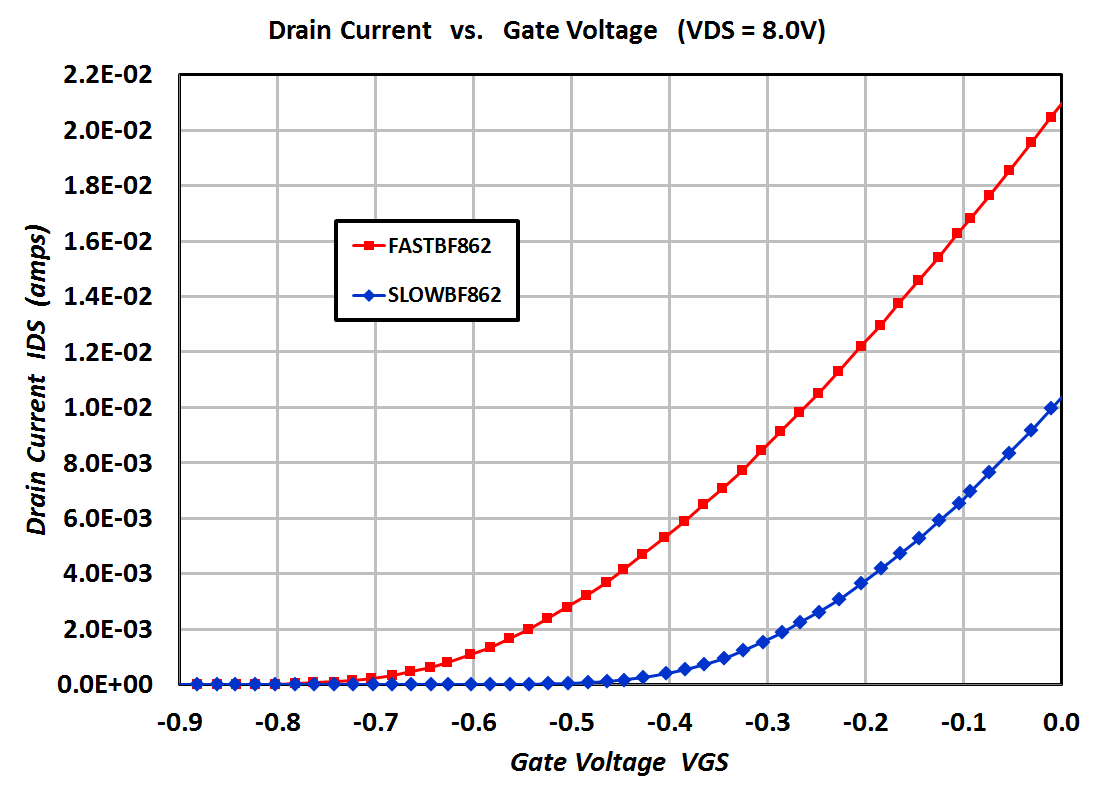

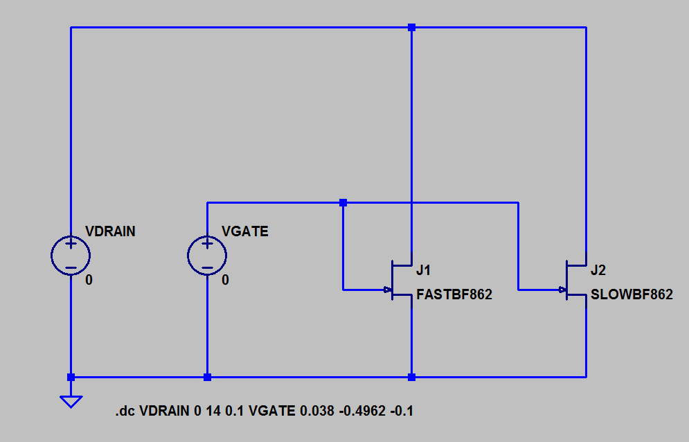

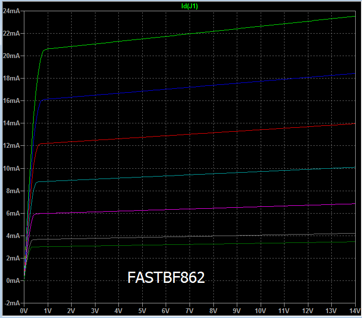

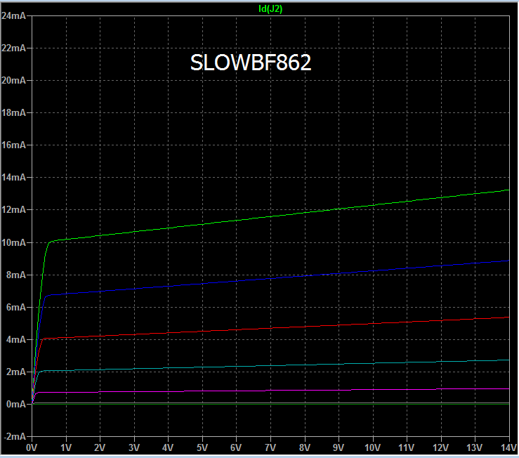

LTSPICE model for your BF862 JFETs
The latter is made by the user ElFishi and it behaves a lot like InterFET models: drain current is immensely dependant on Vds! This doesn't happen on the models made by Mark Johnson and the major difference between the ElFishi model and Mark Johnson models are Vk and Alpha!

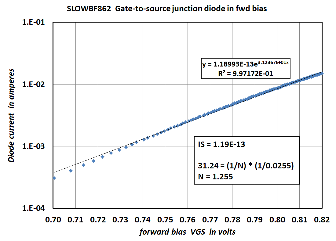

I put them below for convenience:
Code:
*Models by Mark Johnson at DIYaudio, fitted from real measurement of 100 *BF862 transistors, they seems to behave really really well!
.MODEL  FASTBF862  NJF( VTO=-8.238E-1  BETA=2.812E-2  LAMBDA=1.133E-2 IS=6.82E-14   N=1.235
+                       ISR=3P         NR=2           RS=0.5         RD=0.5         BETATCE=-0.5
+                       VTOTC=-2E-3    ALPHA=1E-3     VK=6.0E2       M=0.6          PB=0.5
+                       FC=0.5         CGS=9.5P       CGD=7.5P       KF=8.75E-17    AF=1
+                       MFG=NXP)
.MODEL  SLOWBF862  NJF( VTO=-5.083E-1  BETA=3.394E-2  LAMBDA=2.426E-2 IS=1.19E-13   N=1.255
+                       MFG=NXP)

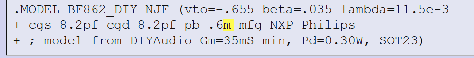

*Model by  ElFishi at DIYaudio, measured the device characteristics of 14 *JFETs and fitted the LTSPICE model for the saturation region.
*STRANGE BEHAVIOUR: THE DRAIN CURRENT IS HUGELY DEPENDANT ON Vds!!!
.model BF862_ElFishi NJF(beta= 0.049998 VTO= -0.5967 lambda= 0.036629 Rs= 7.234 Is= 9.36E-14 N= 1.245 Betatce=-.5 Vtotc=-2.0E-3 Isr=2.995p Nr=2 Xti=3 Alpha=-1.0E-3 Vk=59.97E1 Cgd=7.4002E-12 Pb=.5 Fc=.5 Cgs=8.2890E-12 Kf=87.5E-18 Af=1)
Please, could someone give some deep insight on the reason of the very different behaviour of these models (As I said, I guess Vk and Alpha are the suspected parameters)?

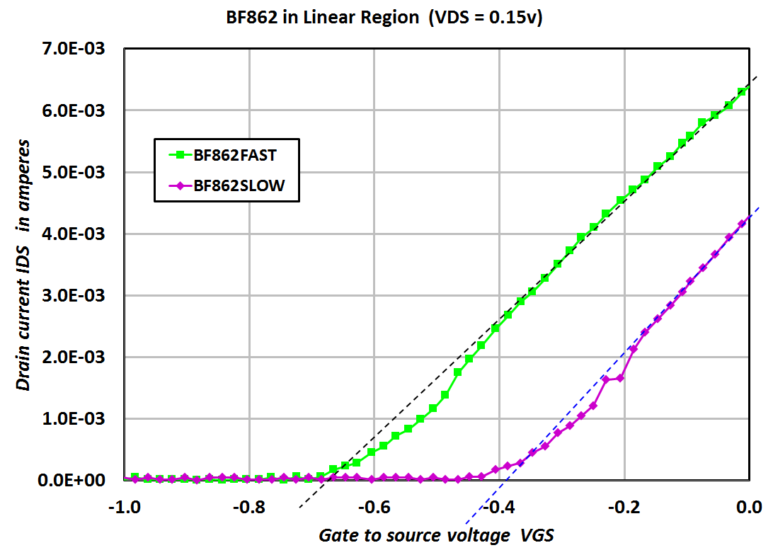

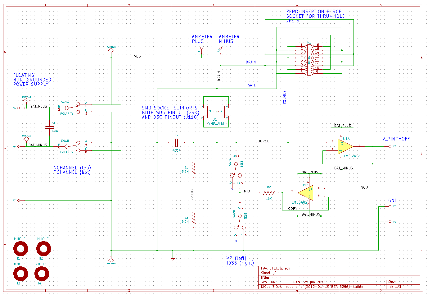

I only measured the zero-hertz ("DC") behavior of BF862 devices, and I only fitted the drain current versus gate voltage (and drain voltage) parameters VTO, BETA, LAMBDA , and the gate-to-source junction diode parameters IS, N. These are DC parameters. It's all explained very thoroughly in post #1 of this discussion thread.
All of the rest, I simply copy-and-pasted from some SPICE model or another, I don't remember which, because I wasn't interested in those other parameters at that time.
I invite you to follow the same approach that I took: (1) identify the parameters that you really, REALLY care about; (2) obtain a population of semiconductor devices to measure; (3) obtain the necessary test equipment to measure those devices in the regime you really, REALLY care about; (4) measure the parts and capture the data, yourself; (5) perform linear regression or if necessary, nonlinear regression, to extract the parameter values from the measured data; (6) victory!
As you have seen, it may not be wise to rely upon SPICE models created (or just copy-and-pasted) by complete strangers on the internet. Their region of interest may not overlap yours, and their idea of "good enough" may not agree with yours.
Best wishes,
Mark Johnson

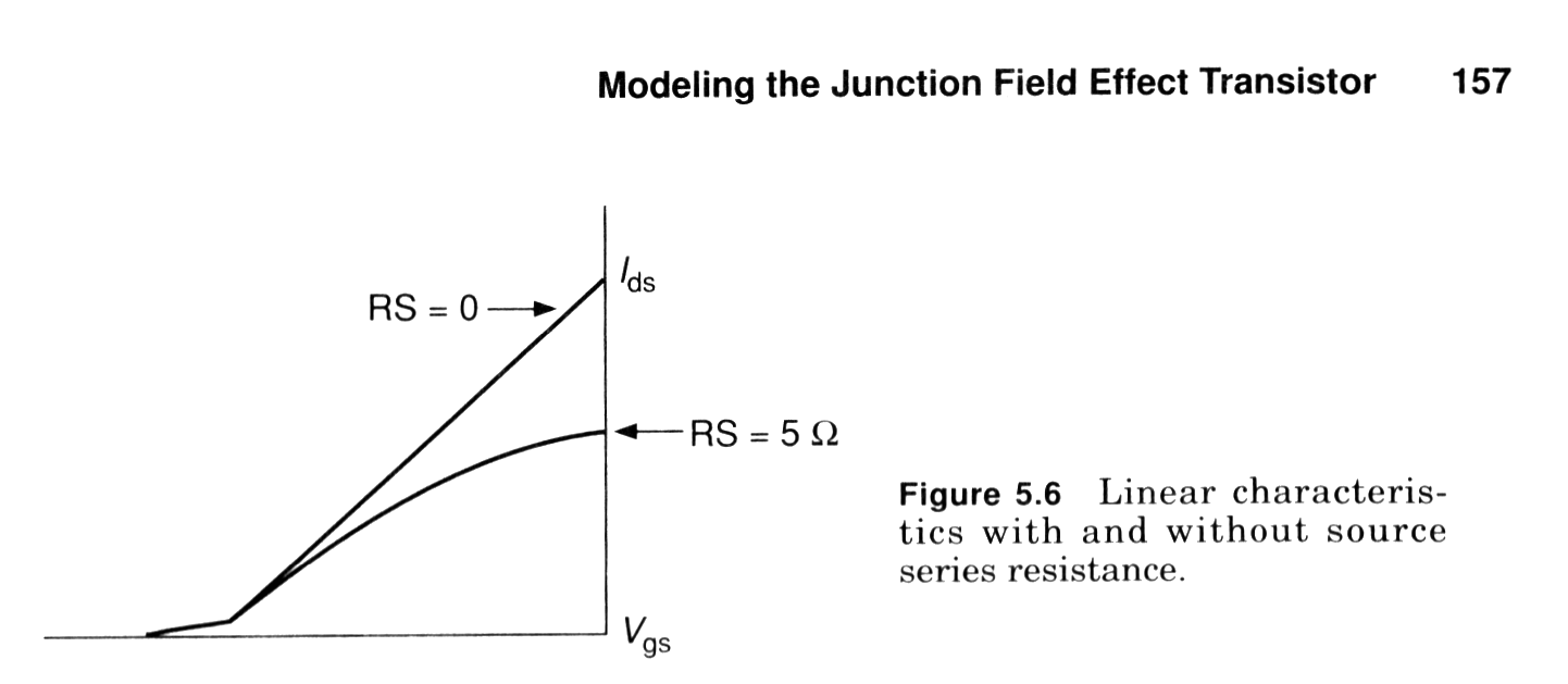

Hello, kind sir. I need to use such a nice intro, because you have helped people a lot.
I wanted to share with the world my experiences with analysis and such. So, first, the fitting should not be done to a whole data set, but only for the one which the equations are relevant in simulating.
Example, you could see the lower current BF862 to start having an inflexiion upwards at higher voltages. That one zone should have been excluded from the calculation of the output conductance, and thus Lambda, since it is caused by an entirely different effect, the ionisation, in simulation of GASFET, under alpha, Vk and B. (alpha Ionization coefficient, Vk Ionization knee voltage, B Doping tail parameter) Basically, think of everything as some regions, and you do the best fit for only that region. If the inclination of the data and of the model are different (different Early voltage, that is g(os), that is LAMBDA), they are not the same thing. Ideally, you would want the model to be so good as to represent all the process variations by changing only a single parameter, the VTO.
Of the Vto, treshold voltage, that one should also be selected not to be smaller than the real one... especially not measured at some high current, such as 100 000 000 picoamperes, because, the simulation is ordered to drop the Id to zero once below the Vto gate control voltage. What's going on here? For some people (Me, specifically), the femtoampeters are VERY important, or at least balancing them out. And the datasheet varyingly specifies the "VTO" at 1uA, 10uA or some other current. That is for practical reasons, for measuring picoamperes takes a LOT of time.
There is some strangeness going on from what I read about people reporting the difference of using a B parameter and not using it, namely, that without that parameter, a different equation set is used. In other words, since the B parameter truly invokes much more realistic conditions simulation, there is no other option than using it. There is a simple explanation: at high DS voltages, the current flowing trough the channel will cause the same effect as injecting current into the gate. that means for accurate simulation, the parameters should be used. I think the equation set for the B-doping tail parameter, is the same as in the GASFET Level2, as there is no other equation using the B parameter, even.
What else: internally, BF862 is composed of two identical antiparallel-connected JFET transistors, so that D1-S2 and D2-S1 are connected, so any model not using Rd and Rs and Cgd and Cgs of identical values is going to miss some important aspects. Of course, in simulating just a limited operating area, it may not come up.
What else have I learned: It was discovered long, long ago, with the National Semiconductor P51 process (well, discovered likely before, but this one has a record of being made eons ago) that combining JFET transistors of varying treshold levels and W/L ratios will lead to lower distortion. You may see the very sharply turning switching JFET transistors of Motorola/ON datasheet that have different markings and such. While the sharp breakover is interesting as a constant current source, it's not universally desirable.
The 1976 Siliconix datasheet has a uniform structure for the J202, but the 1989 had a 2-transistors in parallel system used. (change happened sometimes earlier)
Implications? If you can't do a fit in any way, the real transistor could be composed of several different types anyway and you would do better not to torture yourself and do the same, connect two+ models in parallel. A hint: one of the transistors has a lower treshold than the other one.
You can also see that the ionisation is important in simulating the gate current, or put in another way: seeing the gate leakage in datasheet or in reality quickly allows you to determine the ionisation parameters, if only as some starting values. In case of teh siliconix SST201, SST202 (J201, J202, etc), it starts at only 15V. This is easy to verify in simulation and it can possibly lead to good starting values for those parameters.Of course, one blink of an eye into the equations is always healthy.
