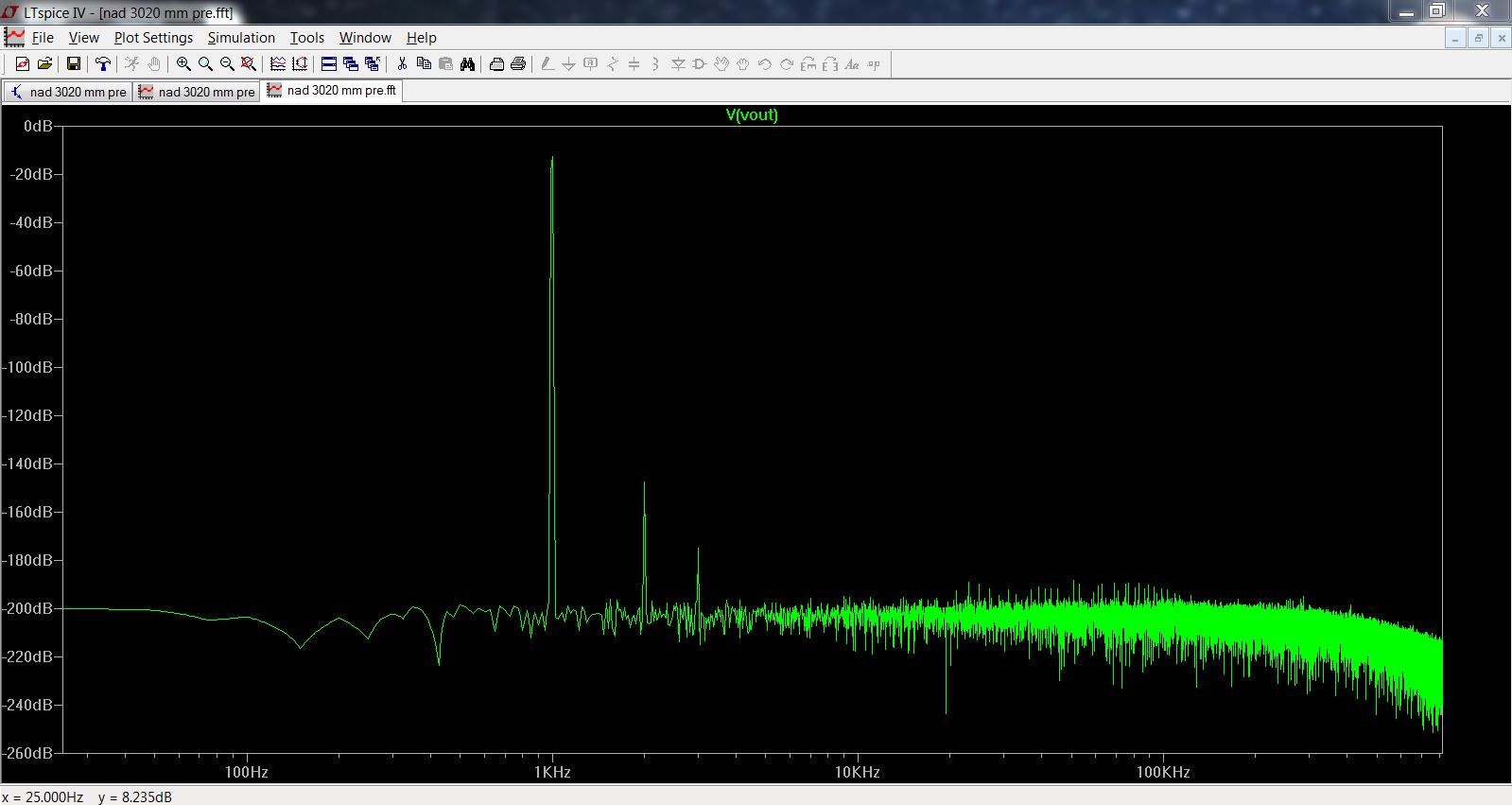

LTSpice FFT simulation settings and inconsistent results.
Firstly, though I am resisting, I'm glad for your input on this matter, so I'm not thinking in a vacuum.
I am trying to come up with a valid test that doesn't take an indefinite number of hours to simulate.

Oh, I actually already figured out that it was non-periodic spectra causing the problems, though without the confirmation of math. I knew that windowing was only a workaround for that.
But about windowing distortions, I had the idea that the Hann windows, taken sequentially, overlapped and due to the symmetric bell curve, summed to 1 all across like you would hope for the crossover points of a speaker, thus resulting in no distortion. It seemed so elegant to me and nothing in the articles I (tried to) read suggested otherwise. Is this not how it works? Again I thank you for shining some light on my dim constructions, and this knowledge will be helpful to users new to simulation.

"I had the idea that the Hann windows, taken sequentially, overlapped and due to the symmetric bell curve, summed to 1 all across" - that is correct. It is also correct for Hamming window. And for triangular window. And probably for many others.
However, this is absolutely correct for stationary signal which, because it is stationary, is also periodic.
With non-stationary signal not everything caused by the amplitude modulation inflicted by windowing cancels out, even though for the majority of practical applications it's quite OK. The bigger is N, the better.

If you are iteratively running simulations and calculating THD or DFT, with small changes to the circuit, maybe you could speed up the settling time by specifying all of the initial conditions, with .ic, e.g. all of the capacitor voltages, et al.
I have found one way to eliminate the sine wave starting spike at turn-on is to add another source with the frequency {Freq+Freq/numcyc}. This gives the input signal a sine burst-like behavior, with an envelope spanning the simulation range. The two sources initially cancel. There is still some abruptness, but it's much reduced from an ordinary sine and it decreases inversely with the total simulation time, as the second source frequency moves closer to the fundamental. This method allows to not use any rev cycles, so simulation starts plotting from the beginning. It is especially helpful in troubleshooting anomalous behavior and oscillation that slows the simulator to a crawl before the plotting starts. It also gives a much better indication of dynamic behavior. I kinda wonder if I shouldn't have been doing this all a long.
The problem with this approach is that it's unconventional, so the results cannot necessarily be interpreted normally, although in my experience it gives equivalent THD figures. One problem is that the peak level is twice as high as the effective level where distortion is measured, so you can't measure distortion at levels higher than half clipping volume.

I never thought of making a rig based on savebias stuff. I would have explored this earlier, but when designing an amp so much changes, the operating points are changing all the time, so the saved values are always invalid, so you will have to run extra simulation every time to find the right operating point anyway.
I wondered if something were wrong with LTSpice. After learning more about FFT I think this is normal, it's just other simulators hide it or work around it somehow. There would not really be a problem if the LTSpice solved the operating point to a reasonable accuracy each time.
OK. I got this anyway,
You'll see how I set it up in your simulation file above. Run the .op command and note the voltages at the input and feedback caps with the original circuit. Then add that offset to the AC input voltage source and replace the feedback cap with a fixed voltage source. Short the input cap out and run the sim for a long time period because there are still a lot of time constants in the circuit.
