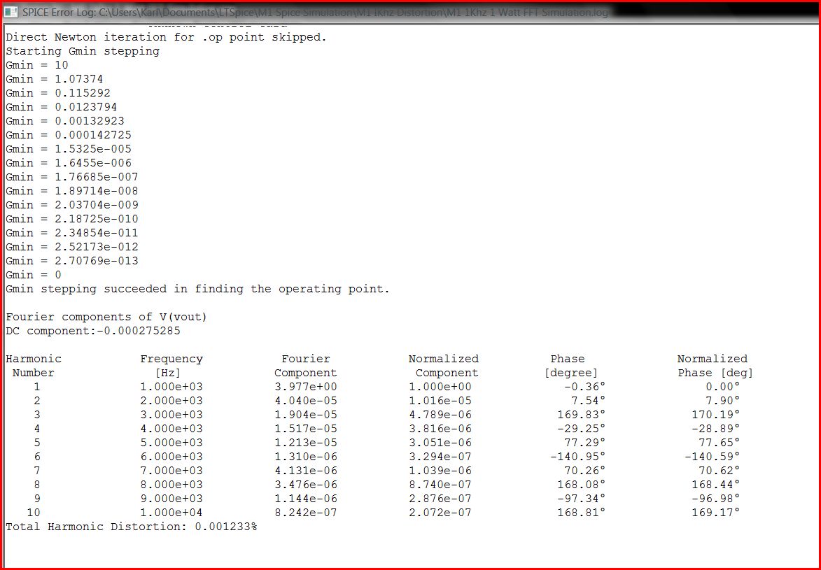

OK, here's the circuit,
If anyone could contribute to this it would be much appreciated. I'm trying to keep this really simple and explain every step I take here.
So here we have the circuit set up for an output of 1 watt rms into 8 ohm. How would you set up a simulation to find a realsitic THD value for this ?
The settings I am using are these,
.op
.option noopiter (because the simulator can not find an operating point using the default method and the error log suggests adding this directive)
.option plotwinsize=0
.maxstep=0.488331106u I've read up on this and how to calculate the value (I think :))
.four 1khz 10 4 v(vout) I understand that looks at the first 10 harmonics over the last four cycles.
.tran 8m
The input signal is 1khz for 16 cycles at a level that gives 1 watt rms output. So I run the simulation and get the following THD report showing 0.0011%.
So first question... is there any problem in the settings used so far to derive that figure ?
Next part of the question...
The figures in the THD print out seem to be the figures that really matter. The FFT plot which I'll come to next can be made to look beter or worse depending on the settings used for the plot while keeping all the spice directives that were set above the same. To me, the text print out is the real guide here.
So second question. Is that a fair statement would you say ?

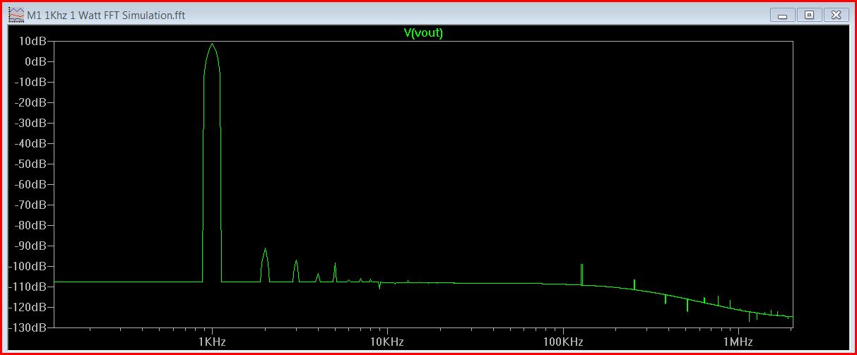

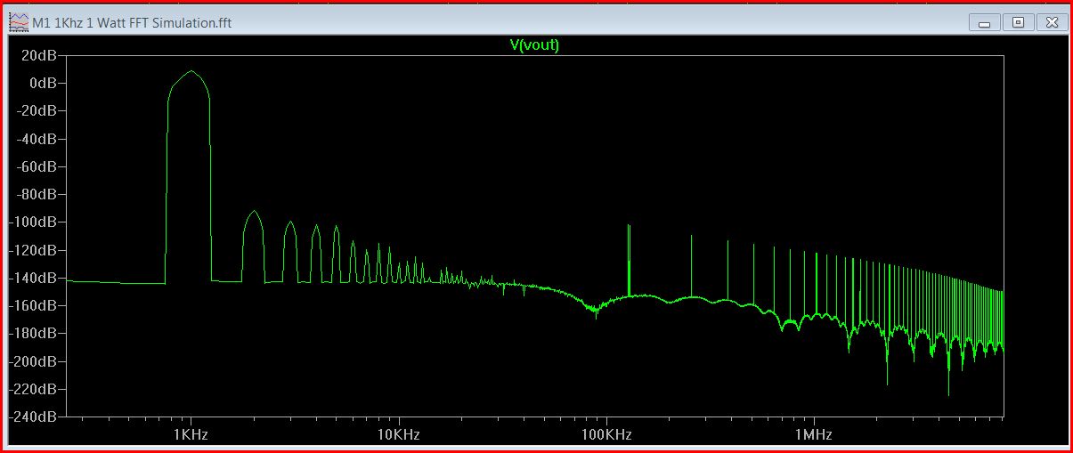

So I run the FFT plot. My version of spice gives 262144 as the default number of data points. That setting appears to alter the extent or bandwidth to which harmonics are displayed. So am I correct in assuming that a higher number isn't neccessarily better as most of what can be seen in the MHz and Ghz region will just be artifacts of simulation and have no bearing to reality ?
So that's the third question :) That's enough for now I think.
So here is the plot using a much reduced setting of 32768 and using the full extent of the data (0 to 8ms) and another using the more widely recommended 65536 points and a 4ms to 8ms time range. Although the result looks totally different the peaks are still at the same amplitudes.
Thanks for reading.

Only use the .noopiter command if the simulation hangs while computing the operating point. It is normal for the first method to fail and SPICE to revert to Gmin stepping. In most cases the .noopiter command is not necessary and will not give a significant increase in performance.
Increased FFT samples will lower the noise floor and increase the frequency resolution. The biggest reason I found to use a large number was for a low noise floor. All this becomes trivial if you synch everything using my command set.
Your noise floor is wrong. It is flat line, this is not normal and it means potential is being wasted. First thing you need to do is to run the amp for at least 1 sine cycle before starting the simulation. This will get the drift and pulse caused by the abruptly starting sinewave input signal out of the measurement, and out of the FFT, greatly helping resolution. This is the only thing restricting your FFT, since you have no large time constants in the circuit.
It is best to give the simulator the equations, rather than numbers you calculated yourself, as the simulator has 32 bits of accuracy. This is why I use equations in my command set. Everything is nearly automatic, and trivial as long as you understand what the equations do.

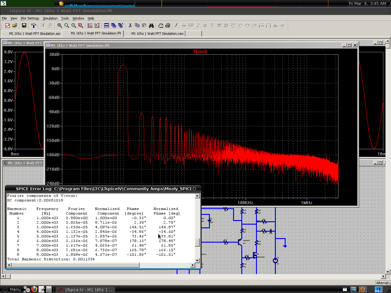

First, I define the number of FFT samples I need:
.param FFT=2**16
Because the FFT sample number are selectable from powers of 2, it is easier just to change the exponent (the ** means a ^ to LTSpice). 2**16=65536. With everything synch'd you can get away with a much lower number of samples.
Next, I calculate the timestep for taking that many samples in the given simulator time frame.
.param timestep=10mS/FFT
Because I add an extra rev-up cycle to the beginning, I use this .tran command:
.tran 0 11m 1m {Timestep}
Your .four directive is messed up, it gives a 10-harmonic analysis by default so you only need this:
.four 1kHz v(vout)

It is important to use a large number of samples because without a very low timestep/high samplerate, stability cannot be simulated correctly because the frequencies are beyond the Nyquist frequency.
Sleeping now! There is some more stuff in my command set that I can explain to you, it is a convenience really, there is not much more to it.
The noise floor can be decreased a little if you use more FFT samples than in your simulation, but it doesn't change much.

It's understanding the way it all fits together that is a steep learning curve. Such as the value {timestep} being entered in the CMD box for max timestep.
So that looks at and works the value out from the .param 10ms/FFT directive rather than working it all out manually.
I can tell when I run this how much longer the sim takes to run compared to my settings before.
Plenty to be going on with... many thanks.
To make the simulation faster, you can decrease 2**16 to 2**14 or something (but this falls prey to the caveat in post 23). Some fields require the {} braces to go around any variables or equations you enter, but the .param statements don't.
Those "twin tower" spikes from 100KHz onmward in your FFT are what happens when the simulation samples and FFT samples are not sync'd.

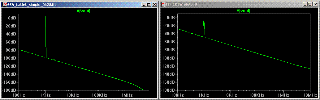

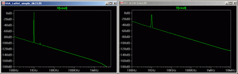

Simple circuits and single ended circuits have typical FFT chart as it seems. I have simulated M1 (Mooly's amp) with SSA front end and the result is much "better" than the original M1. But I didn't build it because I have another "approach" for CFP output stage. Attached is 2 amps FFT simulations. None has been built (still working on it). The bipolar version of the first amp had been built and it sounded good even with much worse simulated distortion.
The first amp on the left has 60V rail. With 63V swing and 3R load it goes up to almost 1A per pair (2 pairs used). And with 59V swing the simulated distortion is not good enough. So I'm thinking about using front end regulator like Goldmund Mimesis3 or Os' CX amp. I still have to measure the transformers on hand first before deciding on the simulated rail voltage.
The second amp is my effort for CFP output with lowish (35V) rail. I believe it will sound better than the first amp, even tho the simulated distortions shows the opposite, because the topology is not compromised as the first one.
So, before comparing amps sounds with simulations, I think we have also to compare amps sounds with topologies. Well, I don't know, I'm a newbie myself :D

Jay, you should really try to get the noise floor down. .four THD results will be totally wrong. Just adding a few rev-up cycles may help a lot.
The problem with comparing simulations and listening tests is that if you don't first make your simulation realistic, then the simulated amp won't behave like the one you're listening to. Running the simulator like a well-oiled machine contributes to much less sudden headaches, and less time fiddling with things other than the circuit.
What do you mean by that (or why and how to be precise), Kean? The chart limits are manually edited so to compare both amps. But I believe you are referring more to the second one?
Yes, thanks, I'm sure you're right. I just don't know enough about amp design and simulation. But I can't wait those experts to design amps the way I want it so I have to start designing myself. And latfets, my favorite output devices, are expensive, so I started to design/build bipolar amps to ensure that I would be good enough when later I build my latfet amp :bawling:
SSA in general is very wild. I believe real measurement is mandatory to get good result with the topology. The first amp simulation I posted was not SSA (but simple symmetrical). It is not wild. I can pick any transistors or use close value resistors and the result is not far away. The second one though, very sensitive to part changes.
In the past, people didn't use simulator. I use simulator mainly to help manual calculation (calculating the operating points).

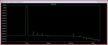

Here's a simulation of that amp. This takes a minute or so to run due to needing a longer simulation run over 110ms.
Notice the far higher (to be expected) distortion and its spectrum.
This would be interesting to do with with laterals but would need multiple pairs to overcome the low transconductance.
